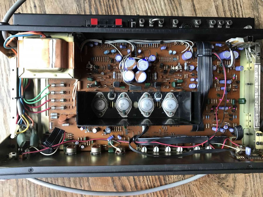

NAD 3020A recap assessment
Just the eight discs highlighted in pink on the right hand side of the amp.

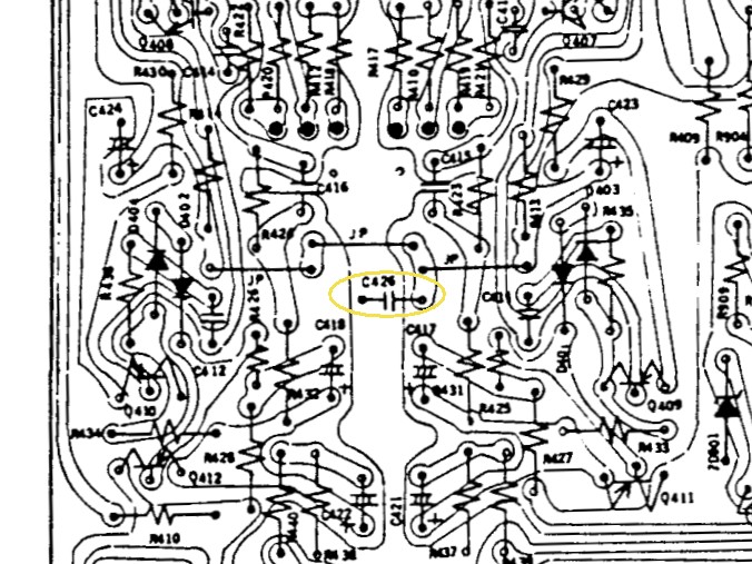

Also C426, the larger ceramic disc which sits between the two pink highlighted ceramic discs at the top of the photo.

Happy with that last item on the list being used in this location C426?
C426 decouples the supply to earth. It will do that up into the r.f. spectrum. If you look up op.amp application notes you will see that ceramic capacitors are specified to ensure stability. The same applies for discrete component design. There is no need to change it.

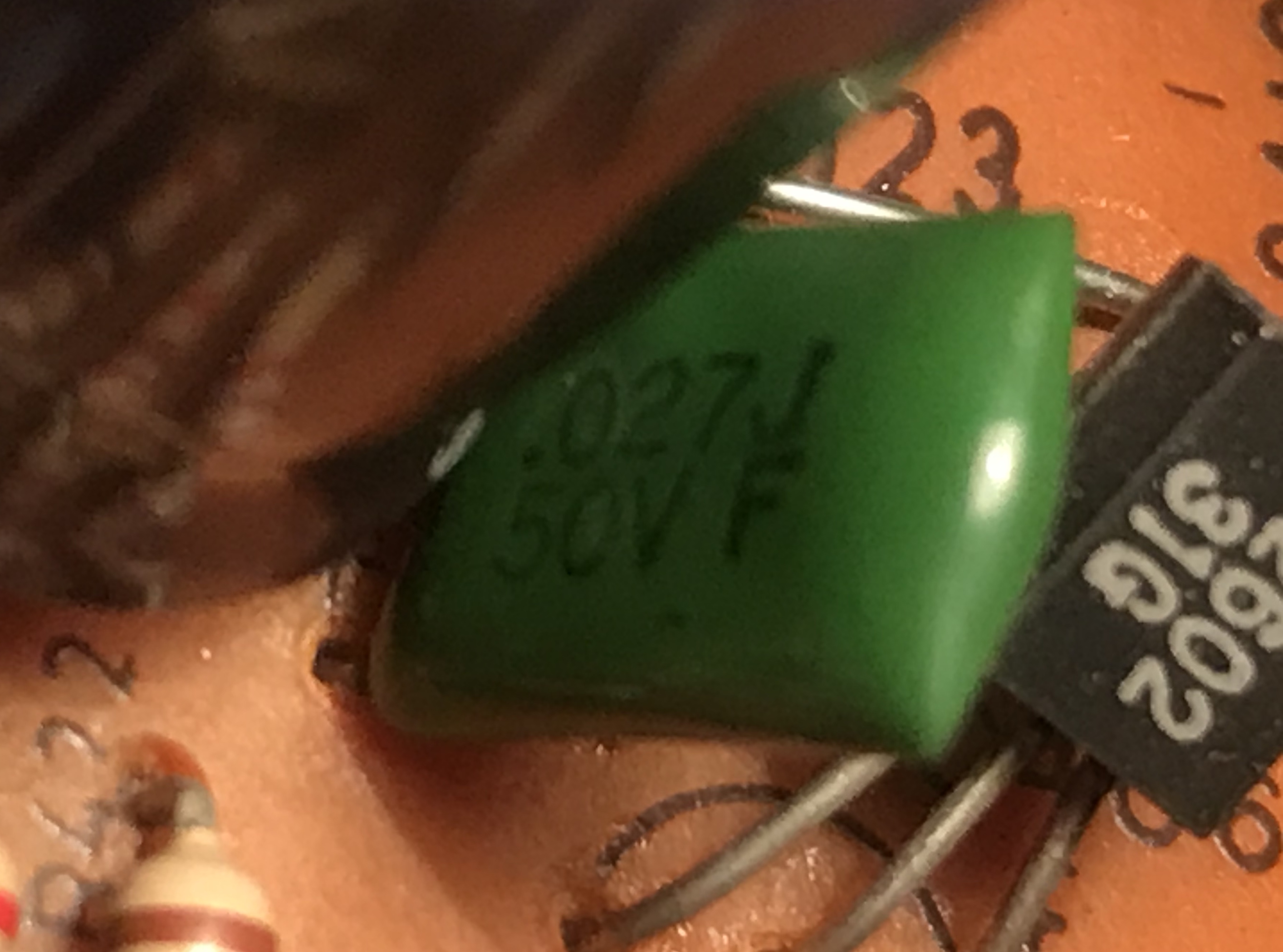

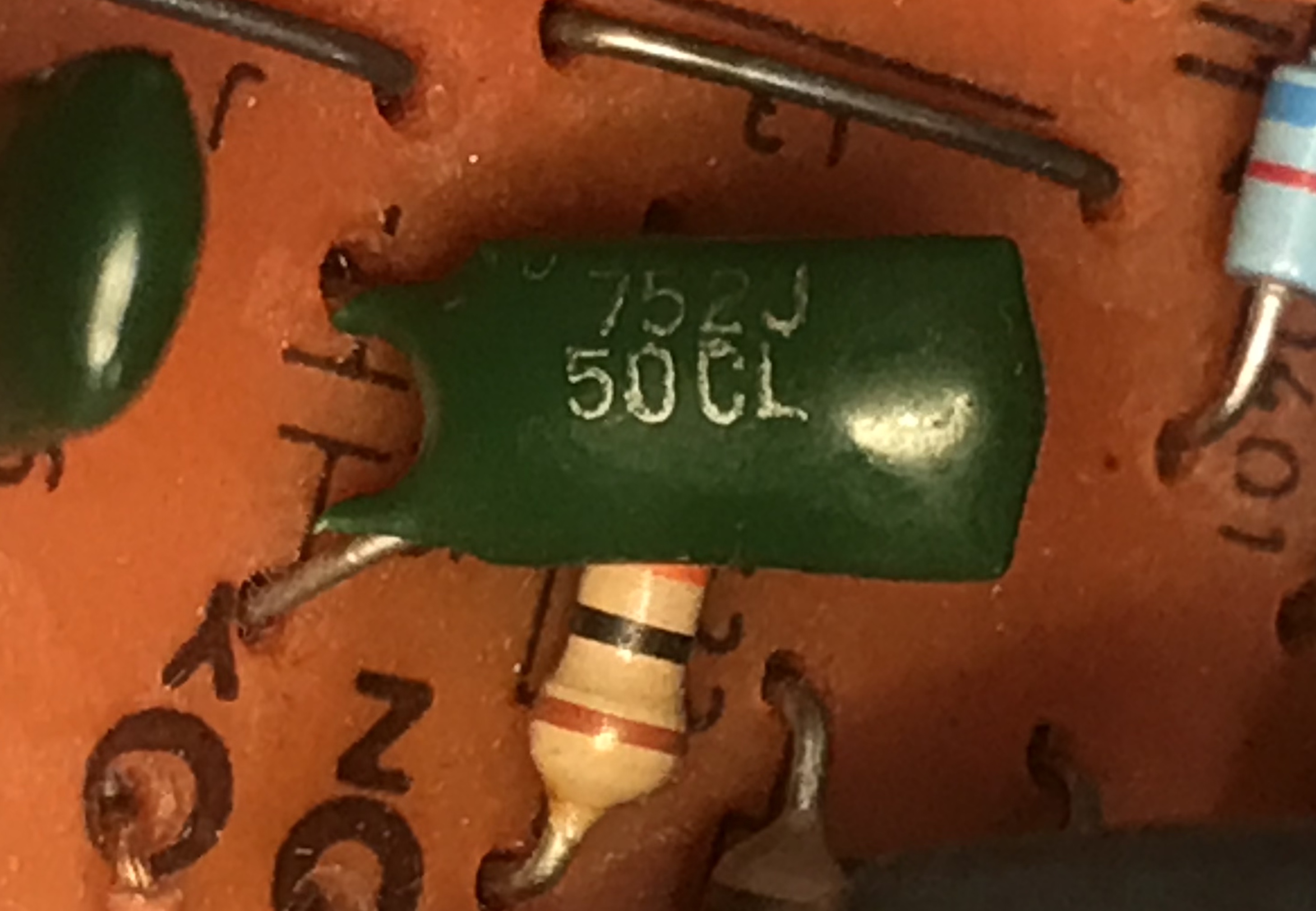

Have purchased the MLCC replacements and now wish to also try a Mylar capacitor replacement.
I want to replace two pairs of the green ones with polypropylene caps for the phono path but need to know what values to order. The marking on the sides are:
00752J 50VF
.027J 50VF
Does anyone know what values these are and what I should be specifying for the order, ideally from

I'd anticipate 7.5nF and 27nF.
Perhaps just sort on lowest voltage rating and polypropylene, so 27nF 630V is lowest in stock. 7.5n has no stock so you likely need to parallel or series.
Do you have a cheap DMM that measures capacitance?
