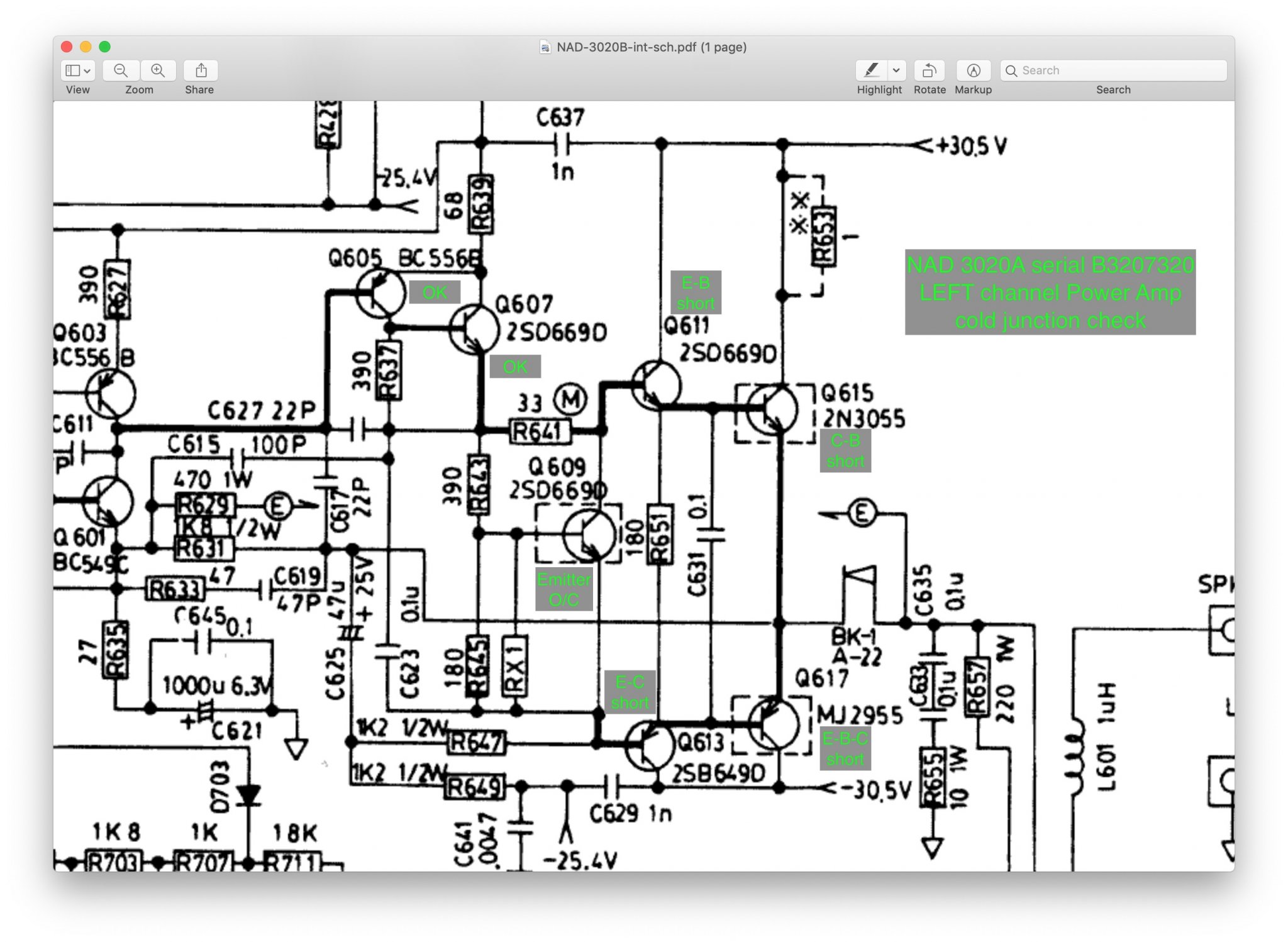

I ran a cold-junction check on all the output stage transistors in both channels. In the Left channel there is carnage (see attached schematic); five transistors failed in varying ways (mostly short). The Right channel fares better; the main PNP output transistor MJ2955 has an open-circuit emitter, which may explain why all the quiescent voltages were skewed so low.
So, various replacements to do; I'll also check thoroughly for dry joints, open-circuit resistors etc.
2SD669 and 2SB649 seem hard to find these days, but there is a version of the NAD schematic that suggests 2SC3421 and 2SA1358 as equivalents.
