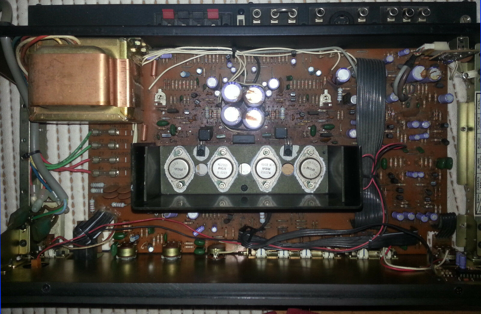

I want to rebuild a NAD 3020 first series.
Can you help me for 4 big transistors position Base- collector.
Thank you.

The collector terminal is always the case for a TO-3, so you can use a meter
to determine the base and emitter pins, if necessary.

Ok.for exemple.
First left transistor.
Left pin E or B
Second transistor left pin E or B
And so on ....
My 3020 is without transistors......

If you align the transistors in the same direction as the photos, you don't need a lecture, schematic or anything further. There are only 2 options for each transistor and the markings on each transistor, as well as the position of the holes in the PCB show whether each transistor is oriented either up or down (as shown in pics).
It's nearly impossible to get that wrong, unless of course, you can't see the pics. or the schematics. Try here: NAD 3020A Schematic These from Plant 10 are actually f...you want to hear the original product by DIY.
They will only fit one way as the pins are offset

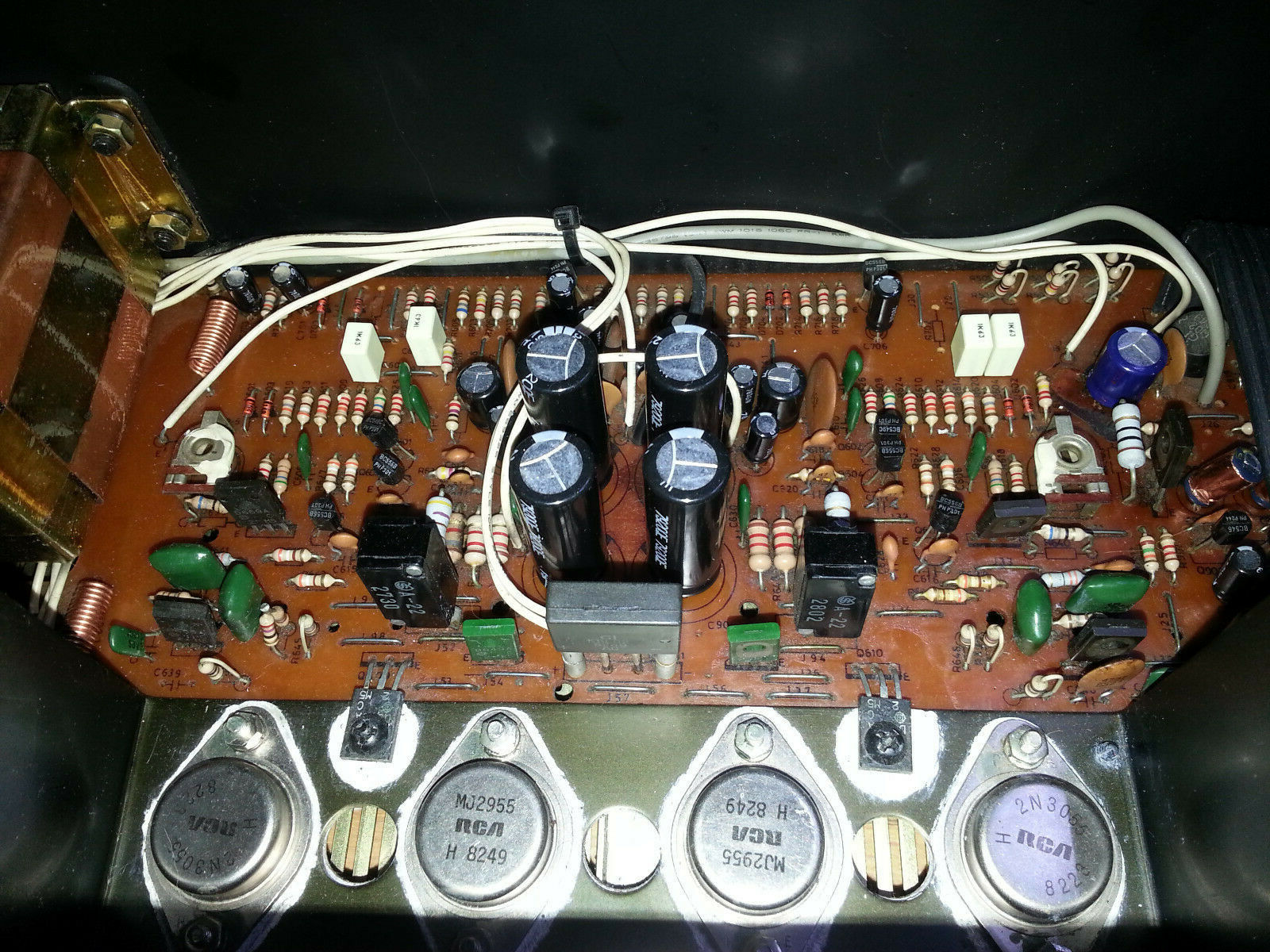

All 4 power transistors are replaced by original Motorola.
BD 139 also replaced.
Now amplifier power on,all 4 fuses OK.
But the sound on 2 channels is low and distorted.

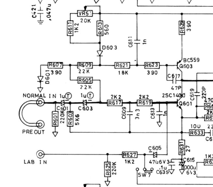

I would start with getting the power amplifier stage into working condition (or verifying that it is working OK).
Before doing the basic forenzics (DC voltages, sine signal on scope) I would replace the tantalum capacitors in the signal path:
C601...C604.
After that I would feed signal to "NORMAL IN" i.e. input of the power stage from another device (preamplifier, computer sound card etc) that I know to be in working condition.
Once you get the power amplifier stage working OK then you ca start with the preamplifier section.

I would replace the tantalums in signal path anyway (unless the goal is to keep the amp as close to its original state as possible) 😉
They only fit in one way !
The two pins underneath are offset if you look.
Note insulators only fit right one way too.
