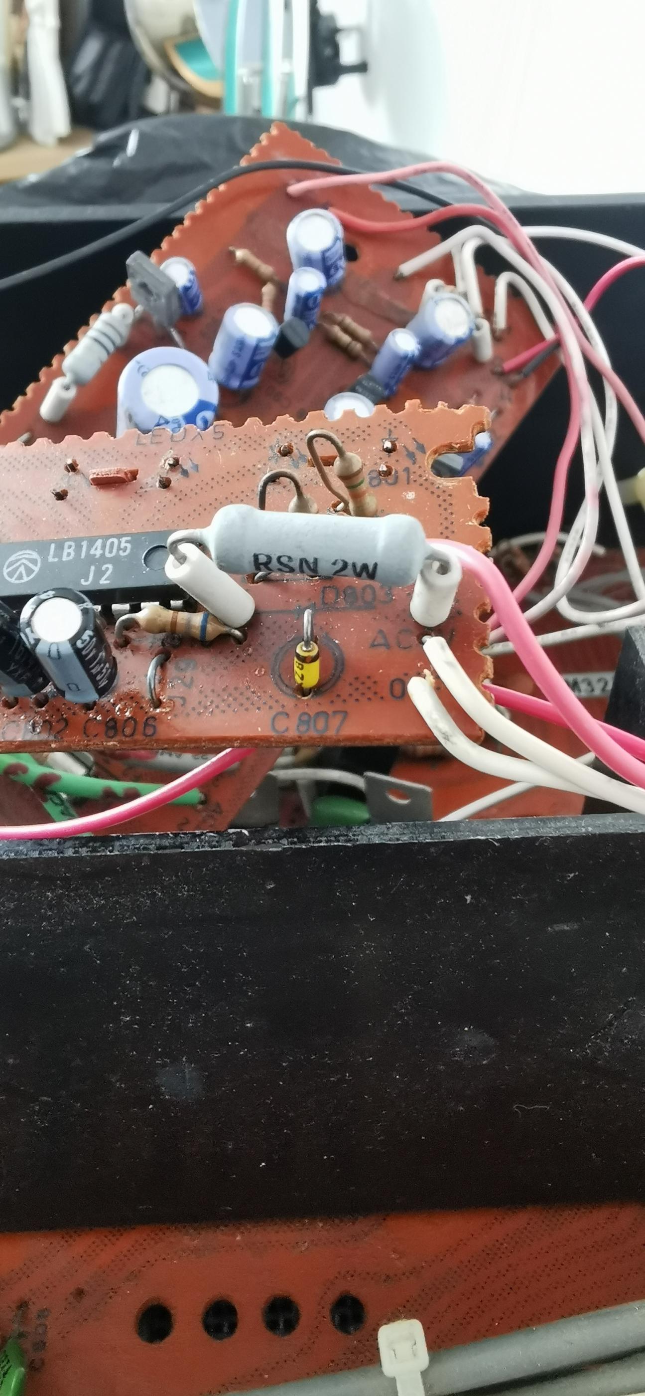

i recently purchased a nad 3020 series 20 amp that was not working,mainly to see if i can get it going, a good learning tool for me, the problem is i am way confused.The service manual i have for it lists different components than what is installed, actualy they more match the 3020A, but even this isnt totaly acurate, so i am wondering if someone else messed about with it before me, which is very possible i guess.so i am at a loss which service manaual to use.should i totaly believe the original?.The other real issue is the little LED board that is installed.when you look at the parts list it shows for example that D803 should be a diode, but is in fact a 2w-680 ohm resitor, and C807 should be a capacitor, but looks like a diode
the service manual only goes up to C805.see attached.So as you can see i am a bit confused .com.
I have attached photo of the board and the 2 alternative parts lists
Appreciate any help or comments you may have, thanks, paul.

C807 could be a tantalum capacitor .
The resistor replacing the diode in the diagram I am looking at feeds the string of LED,s attached to the LB1405.
It says 6V AC in with 7.64 out to feed them ---you can get AC operated LED,s but all this is supposition .
If you are looking at a diagram that only goes up to =C805 then either you have the wrong version or somebody has modified it.
hi and thanks.Now i already have a copy of this and one of the attachments has the components list that applies to this manual.Now you would assume, as i did to start with that this list applies, but here is my confusion,if you look at the pcb picture i put up on here the diode (803) clearly isnt (its a resistor),and the capacitor (807) looks more like a diode, and tests out like one as well.
if you check out photos on the web of others like it, they also have a resistor in the same position.so here is my problem, do i rebuild it as per the manual, or as it is in front of me? many thanks
