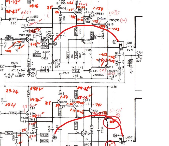

I was doing ok with this today untill i came across, something i dont understand so maybe someone can assit to enlighten me
the 2 ringed vales,both are 0v and not what i expected as this is the the good channel
the issue is with the centre voltage(again @-144mv), which isnt the issue as im working my way through it, its the fact the these 2 values are not what i expected.
Q 602 B/E voltages are the wrong way round on the diagram, but couldnt change the upload before i realised.

Can't just see R661/2 but the arrows mean it goes to ground.
D605/6 would modify the characteristic of the bias generator (vbe multiplier). Removing them is typical of a production change.
If the channel with 0 volts on the emitter of the outputs is working OK then its fine. 0 volt is the correct value. Anything else is classed as a DC offset. -/+100mv would be considered acceptable for such an amp.

The two ringed 'zeros' are perfect as long as that channel works.
The arrow heads pointing downward are grounds.
I couldn't see those resistors at first but as mentioned, those arrows and the C mean they are in electrical contact with the other C as shown here.
There might be no voltage across R661 or R662 if the thermal breaker is open circuit and you have no load connected.

ok i will plod on, just thought it was a bit odd with no drop across those 2 resistors
They are feedback resistors - if DC offset is close to zero they won't have much voltage. Seems to be two feedback paths, one before the relay to close the loop when the relay's open. The one after gives more accurate sensing of the actual output voltage typically.

D605 must have been thought necessary by NAD at some point and is related to keeping the bias current stable. Where it is located physically and by how much it heats up in relation to what is around it will determine its effect.
It is all done for stability and preventing thermal runaway (a very real issue with no Re's fitted). Whether it was added in later production or removed in later production I wouldn't like to say. Maybe it over corrected and caused distortion and so was removed.

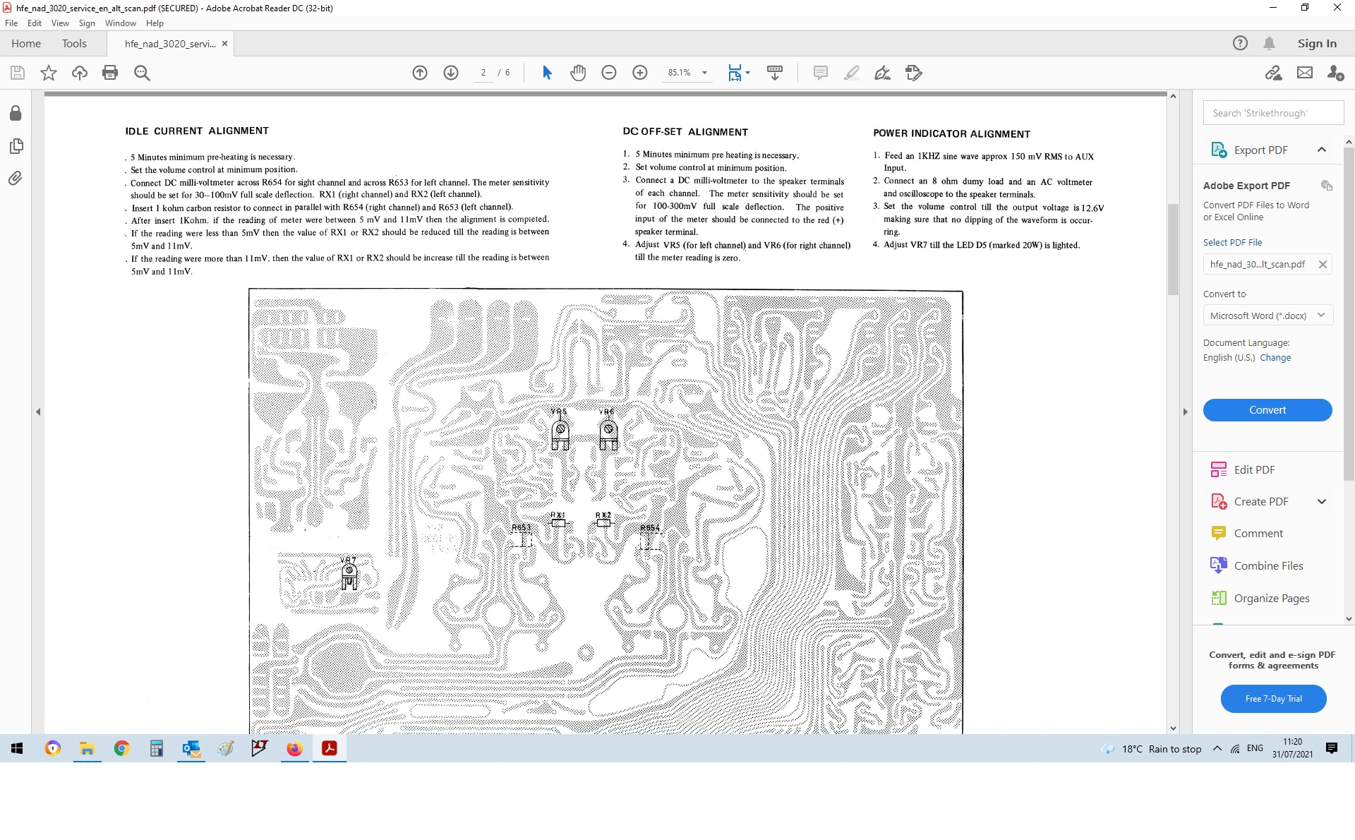

one weird thing tho(see attached)
when i went to check the idle current, the 2 named resistors R653 and R654 dont exist on the board, they are just jumper wires, so not much point in putting a 1k resistor in parallel with a jumper wire.
ive worked on 3020's before ,but this one is weird.

Sounds like there have been a lot of production changes in the models life. To check the bias current you will have to break the circuit to either the collector of the NPN output transistor or the collector of the PNP one. It doesn't matter which. Then solder a 1 ohm in place across the break and set for the correct current by calculating using the voltage across the resistor.
30 milliamps for example would be 30 millivolts.

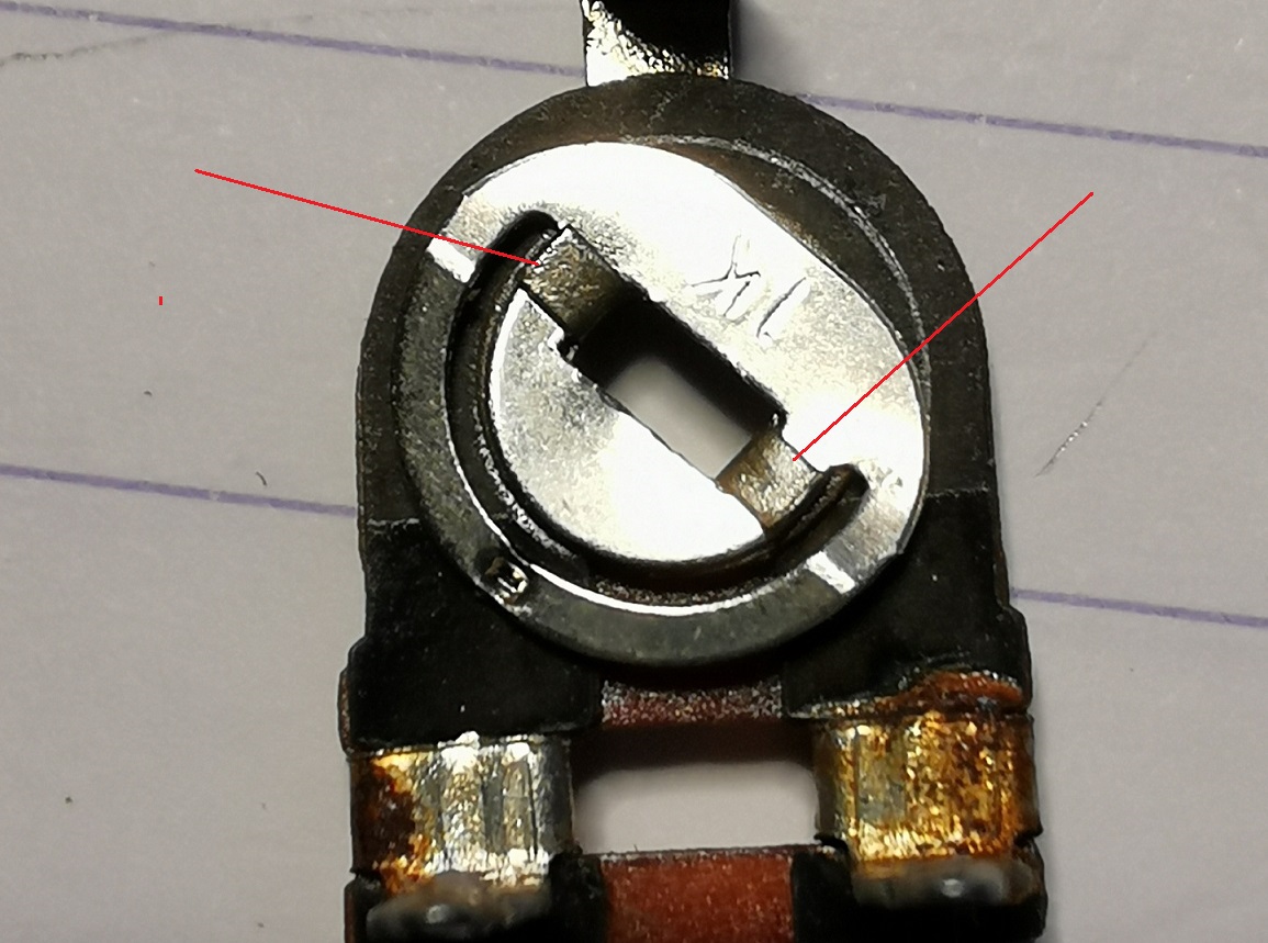

so i took the 2 no trimmer pots out because something was bugging me about how loose they felt.Trickly little devils to take apart, but i did the first one,cleaned it up and put it back together.
The second one didnt need taking apart as it fell to bits, so i cleaned it up and put it back together.
A little tip for anyone who doesnt realy take things apart,i do frequently.
picture attached showing how they are fixed at the back, 2 little tabs bent over secure the whole thing, just carefully lift them back and you are able to get to the track to carfully clean it with a soft cotton bud and servisol, or other cleaner
so now both channels off set are pretty symetrical with thier outputs at pretty much 0v +/- 2mv and voltages around all of the transistors is also pretty consistant.

Those little presets can be very flaky sometimes. If the rivets are loose where they grip the ends of the track then you have problems. Think of your simulations and the vbe multipliers. Think how little change is needed to massively alter the bias current. So a flaky connection can play havoc with the setting long term.
