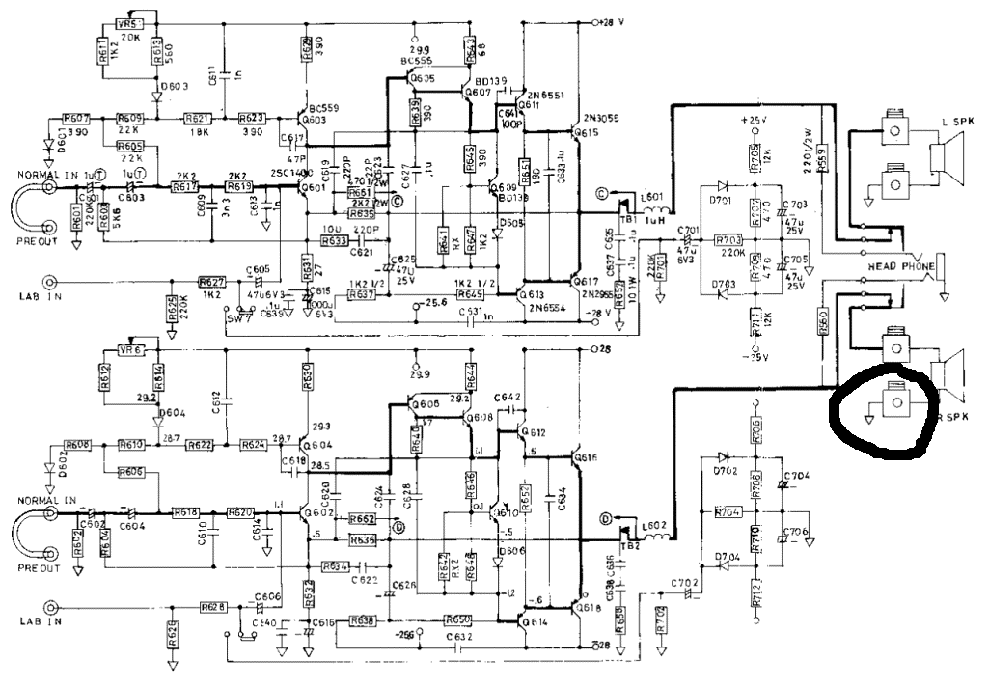

I searched the web and got a schematic for it. I am not sure which is the fuse you are refering so I circled the one I suspect is the fuse. Could you please tell me if it is correct?

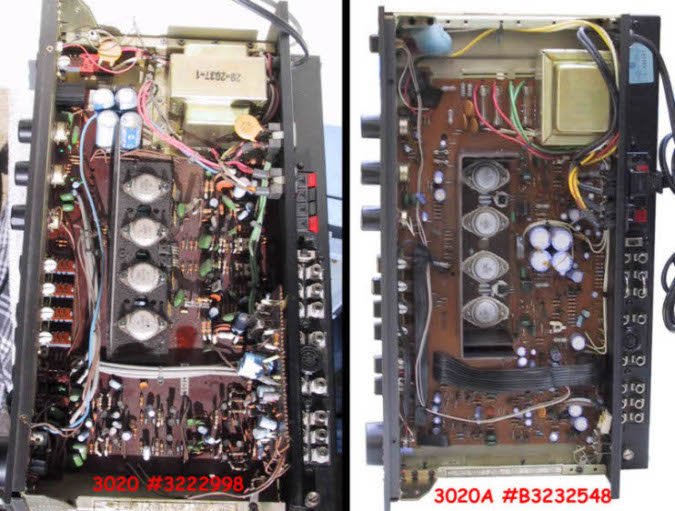

I have also got a picture of the 3020, could you please tell me which one is the fuse I need to replace.

the left is my 3020.

It is marked as TB1/TB2 on your circuit and it's right between the zoebel and the output inductor. It's a bimetal automatic fuse and i have no idea if it's easy to find a replacement, nor do i know at what current it trips. 10A? My guess is that yours is tripping early. Or you really listen loud.
Not enough resolution to spot them on your board picture but they should be close to their corresponding inductors. Square cross section, about an inch tall, black, two pins at the bottom iirc.
Again: before replacing or shorting check bias and offset just to be on the safe side.

Hello Sir,
I already found TB1 and 2 on the circuit and on the schematic. they are rather tall black rectangular blocks.
My speaker is wharfedale diamond 9.1, 6ohms 86db.
The click will appear even when the volumn knob is at 9 o'clock.
Thank you Sir. I also found a fuse from the transform cracked.
It is F3. and it is a walter 4A 250V. Can I use a similar product to replace that?

by bias and offset you mean the speaker output dc voltage?
also I don't understand why the headphone out is not affected because the TB is before the headphone out.
Thanks Sir.
The fuse is tripped by current - the headphones simply don't draw enough to trip it (limiting resistor and higher impedance) - or at least this is my working theory 🙂
Just check what is the output dc. There seems to be no bias control.
