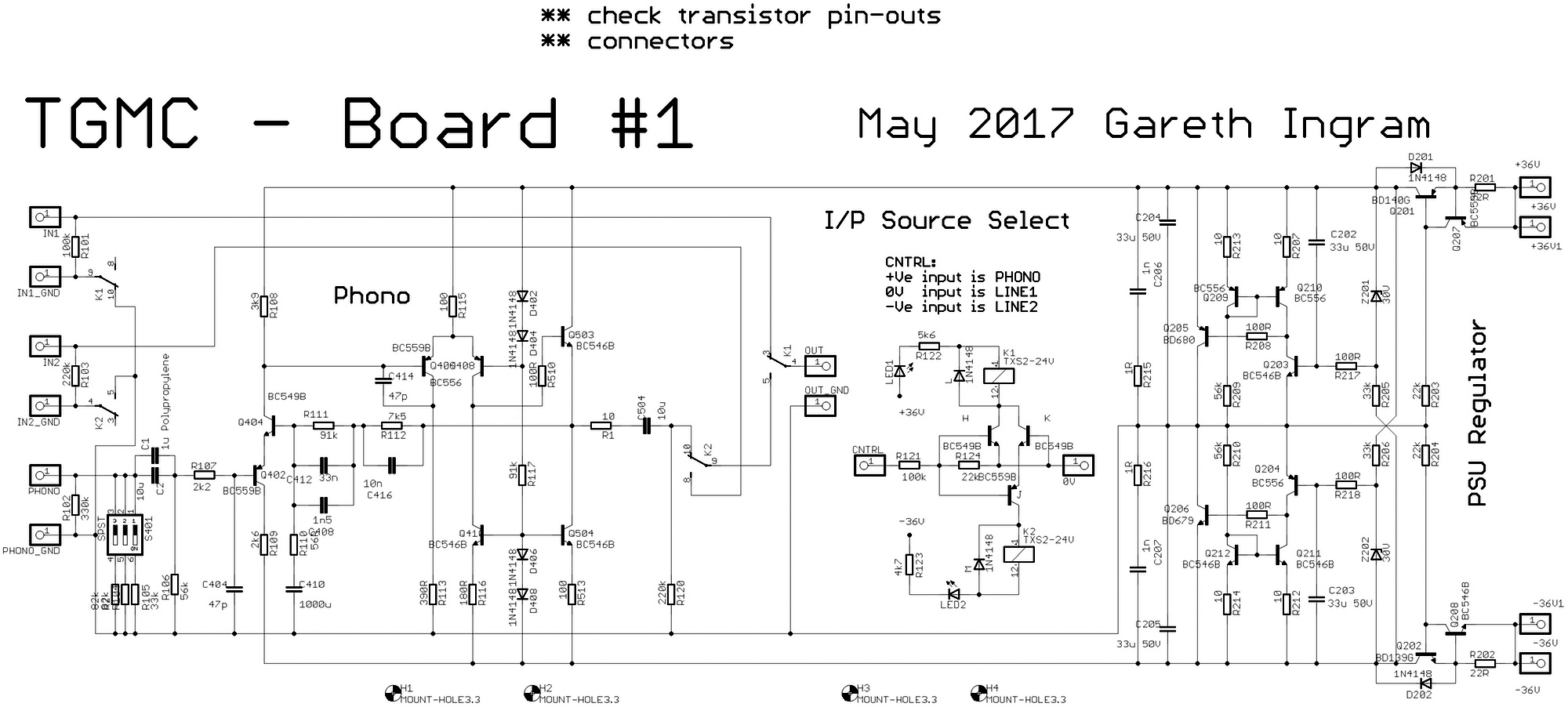

Hey! the NAD phono is something I wanted to adopt too. I took the design and made some simulations and tweaked up the output driver and made a pcb for it. I didn’t have a chance to build it yet. If anybody wants a stand alone pcb for it I have spares. I included a dual rail shunt regulator on the board too. I looked at several NAD integrated amps as there were a few variations. I ended up taking the best from what I understand. I really must build it as I currently have no phono and vinyl sitting in wrappers.
TGMC - a modular control pre-amplifier
