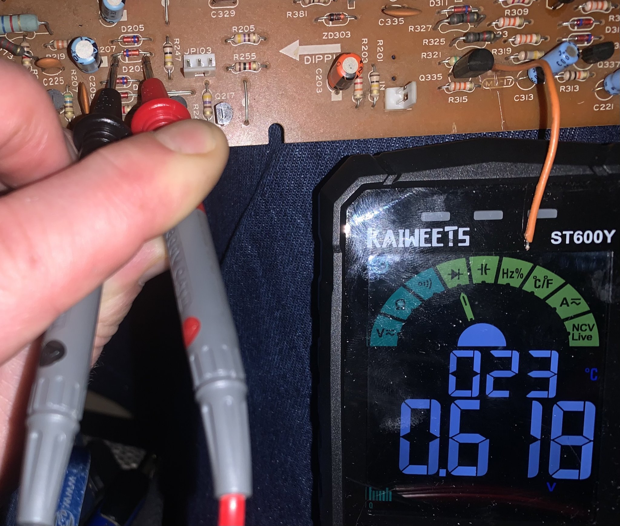

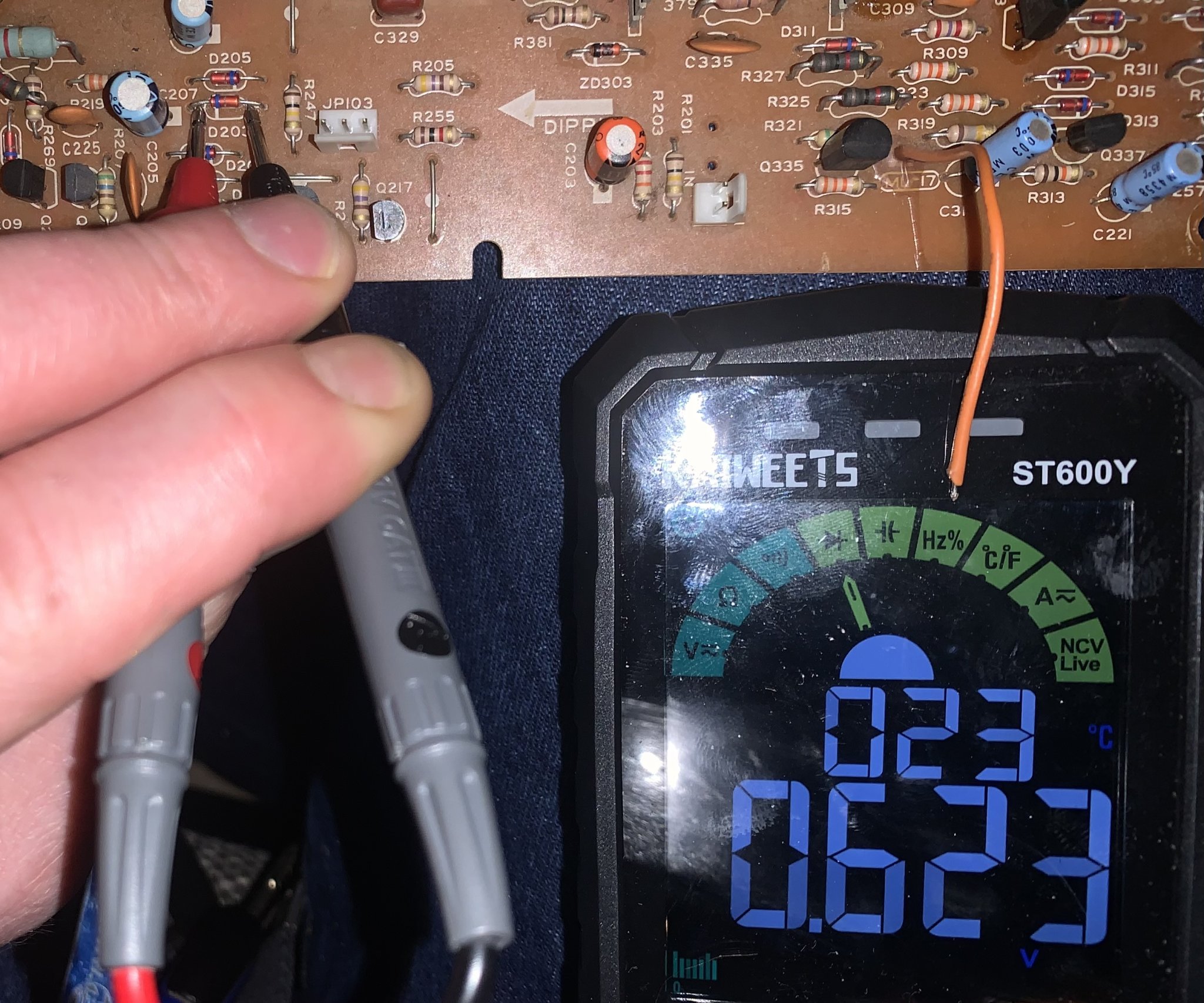

yeah I am using the diode test function so to correct me when I wrote I have a reading I meant measuring a voltage drop…
but for diodes, a correct one would mean measuring a voltage drop in one direction and no reading (or OL) in the other direction but when soldered, I can measure a voltage drop in both directions, I guess because of the wiring on the PCB.

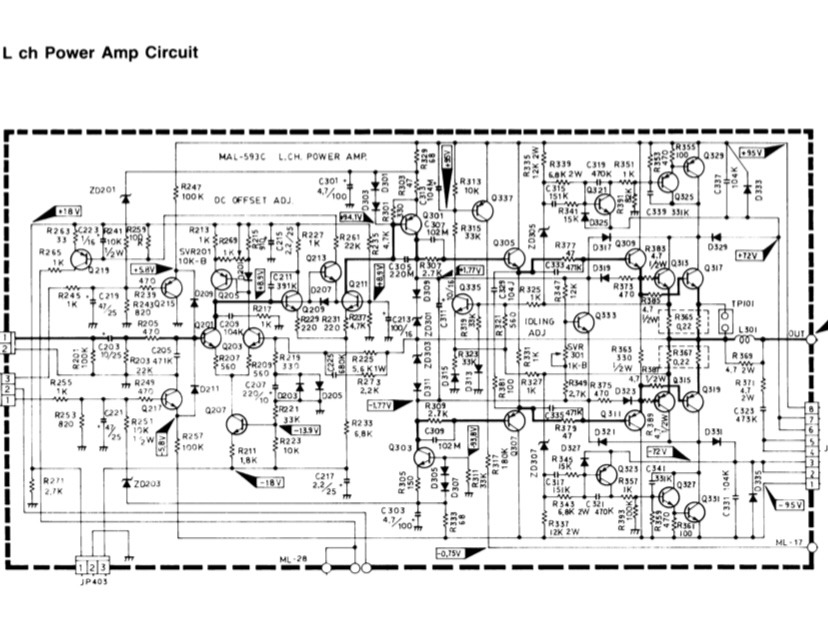

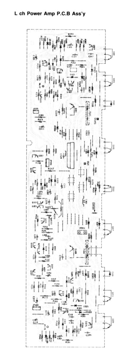

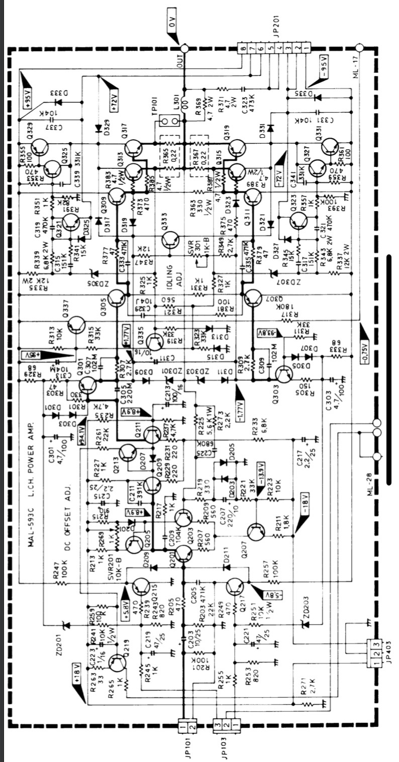

Attached are some pics of measuring and the schematic of the left channnel power amp PCB, also attached the service manual where you can see the complete schematics on page 15
problems is that output has 94,5V instead of 0V and instead of 72V mine has 56,7V (on both channels and working on the other one)

Are you using the meter "diode test" function with all the NAD power off, discharged, and its AC cord unplugged?
Normally, the DVM gives a beep if the diode is ok. The test uses the internal meter battery to activate the device's pn junction.
Unfortunately, that schematic is really bad.

The 72V applies if the impedance switch is set to 8-16 (high). 60V is more like what you would see if the switch is set to 4-8 (normal). That part of your amp is probably ok.
To get 95V on the output there must be shorted transistors. Look for collector to emitter shorts on the output transistors and work back towards the input, checking collector to emitter of all transistors in the path. Start with Q317, Q313, Q309, Q305 and move towards the input.

I tested all the transistors on the left channel and the only one which is broken is Q301 where e to c shorts…. have not found any other broken part and all diodes and resistors looking good. First I thought that resistor R369 is broken too because when measuring the Ohms when soldered this resistor shorts but should have 4,7Ohms, so I unsoldered it but when unsoldered the resistor measurement is correct with 4,7Ohms. When soldered this one shorts, but this is probably by circuit design, so I was wondering if I do need this resistor anyway, because of the short running the amp without this resistor must be the same I guess…

L301 is in parallel with R369 which looks like a short circuit at DC. At high frequencies the L301 inductor impedance rises and the 4.7 Ohm resistor dominates the impedance. What you measured is normal. These parts are for amplifier stability.
