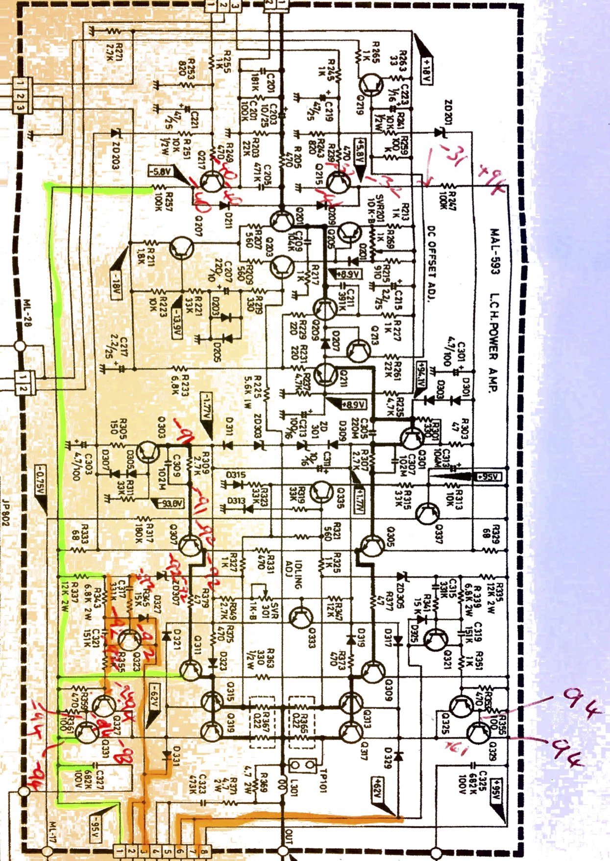

Checked the main power supply tonight. With both boards completely disconnected the DC power out of the rectifiers is correct. I then tried connecting left and right channel amp boards one by one and in each case the -60V rail goes up to -90V, the same with both boards connected at the same time.
I have done a bit of checking around the board where I thought it may point towards a problem but nothing conclusive. I have marked up the schematic on the attached. Left and right boards are the same.
Any advice on where to look next and what to look for would be appreciated.
Amp is a power envelop model, appears that the outer high voltage rail is finding its
way into the low voltage rail, probably due to failed silicon. Same fault on both channels
which is unlucky. Had a look at the voltage measurements, voltages around Q303 and Q307 look suspect, downstream voltages may be caused by this.
Measure Q303 b/c/e voltages to GND/chassis. Repeat for Q307. Measure to first decimal
point, need to check Vbe of both. possibly a collector-emitter short on either these Q's.
Suggest also diode check these transistors with amp powered off/unplugged.
Q303 b/c/e -94.4/-95/-95 b/e 0.69
Q307 -95.1/-95.8/-94.9 b/e 0.51
Out of circuit checked out good.

Oh its class-G with two sets of rails. Suspect the commutating diodes (D329 / D331)?
They checked out okay, also did 330 and 332
With the dmm in diode test, do you have connectivity between the -92 and -65 volt connectors both ways? Could be some power transistors failing. There is also a diode on the input of the -65 volt connector. Maybe for safety reasons? Are those ok?
Not sure what you mean by "connectors", where am i testing in the circuit? Could you identify the components by their number?
