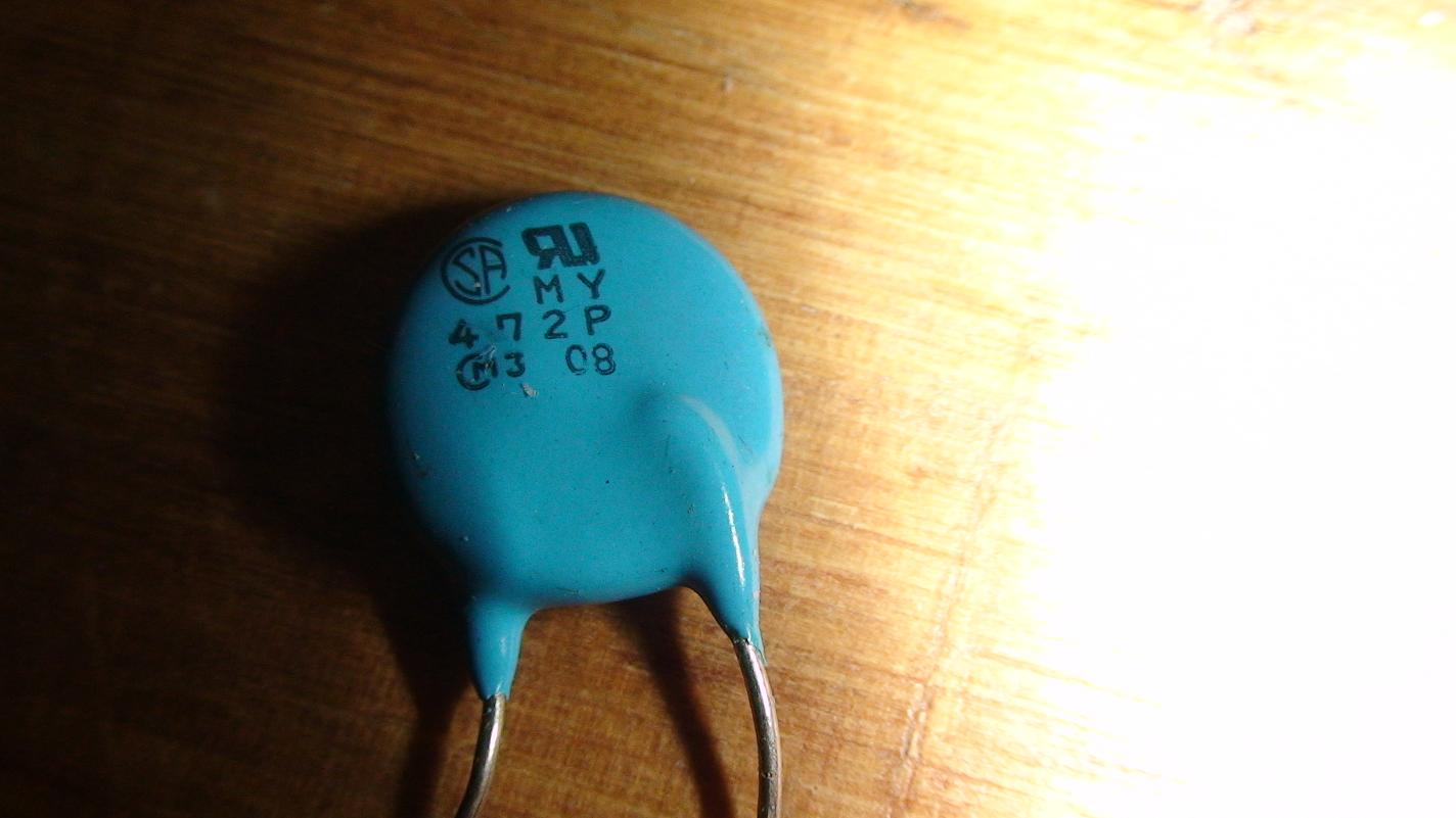

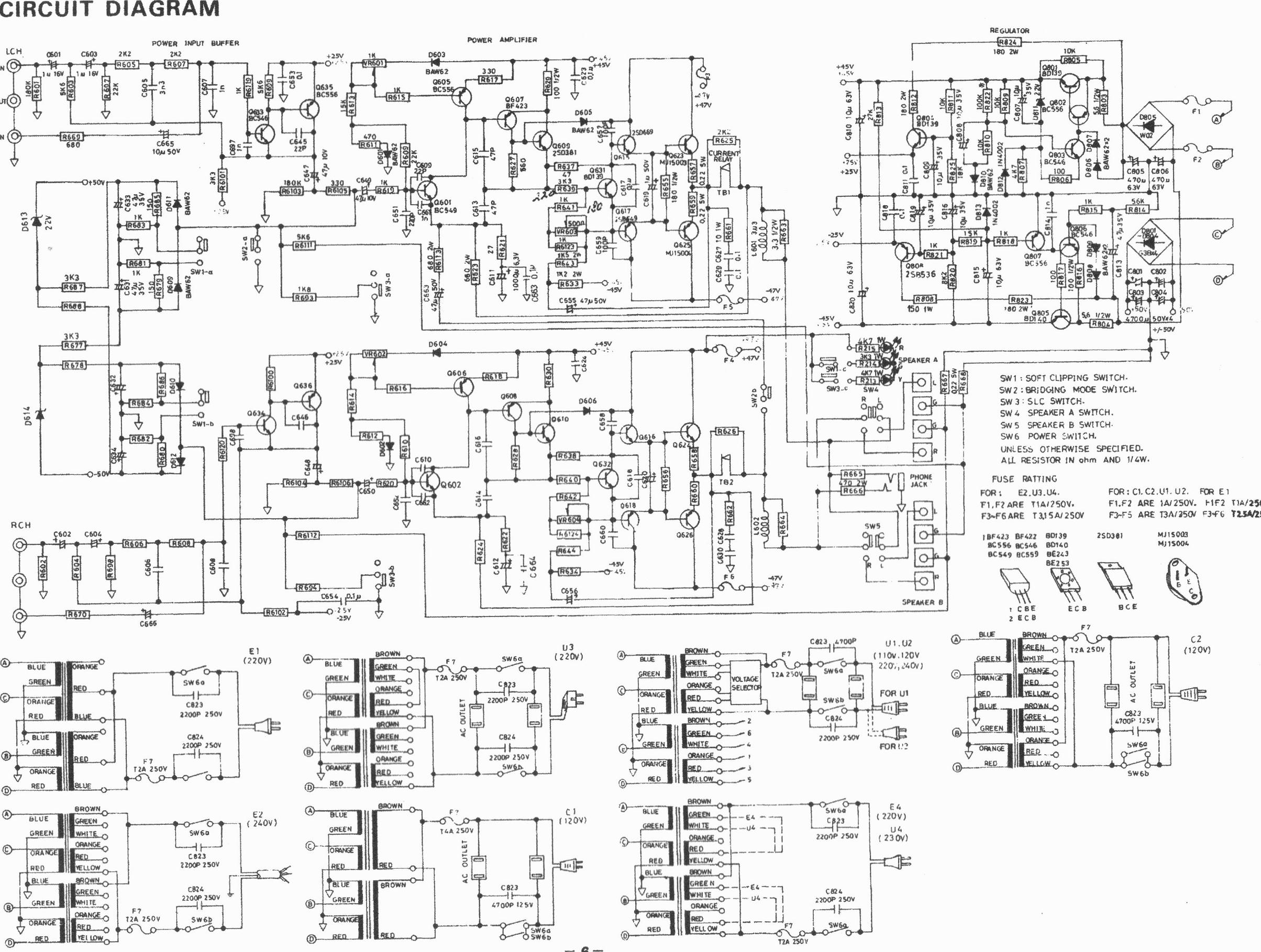

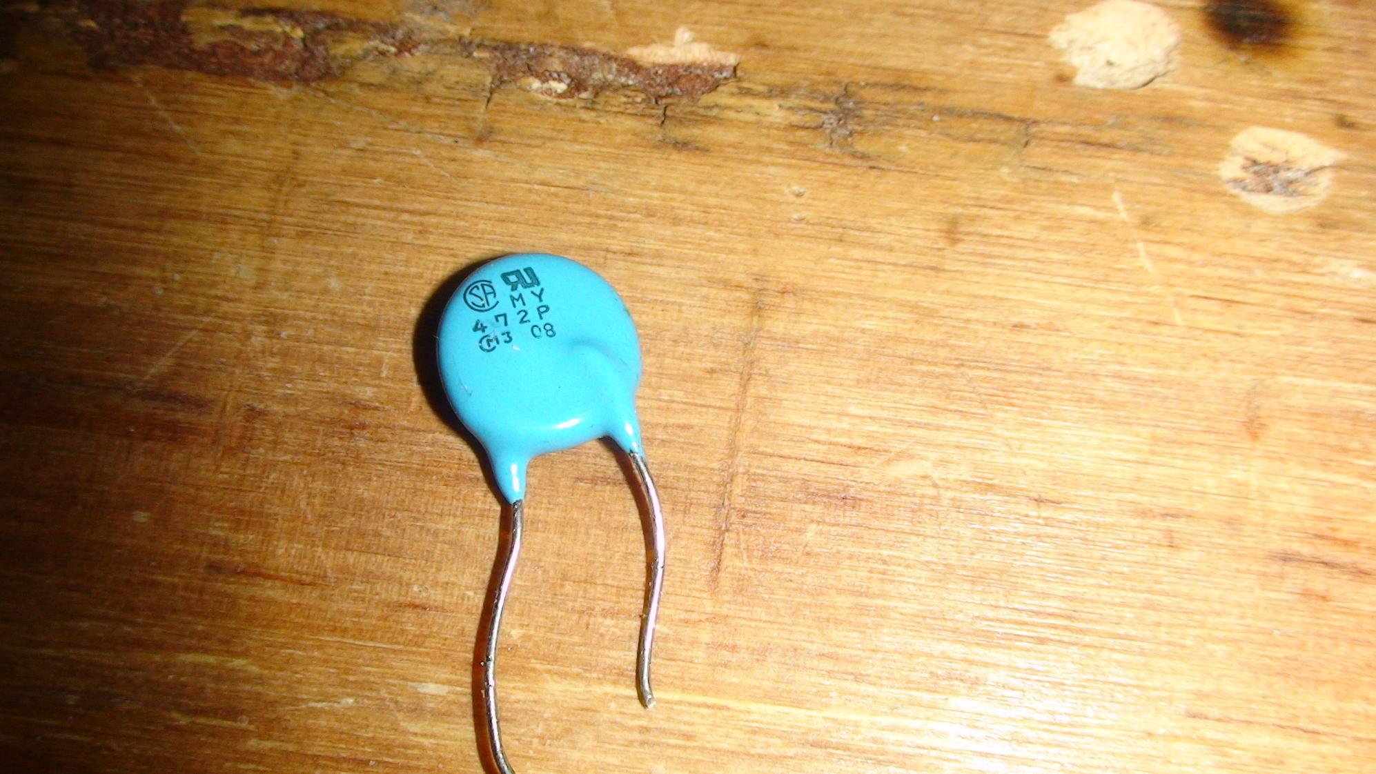

I had to replace the power switch, found them on ebay. Want to replace the varistor or capacitor. It is blue, says MY 472p. measures at 6.7NF, should be .0047uf. Its position in schematic shown in pics, 110v circuits. Ant ideas what this is? a snubber? Or safety or filter cap only? Sure looks like a varistor though.
This one looks suitable. PME271M447MR30 Kemet | Capacitors | DigiKey
titla
Your kemet Digikey idea is interesting as it lists following:
Applications EMI, RFI Suppression
Features X2 Safety Rated
But it sure looks different.
Tom
Tom
Yes, but you may not be able to purchase the exact original part.
