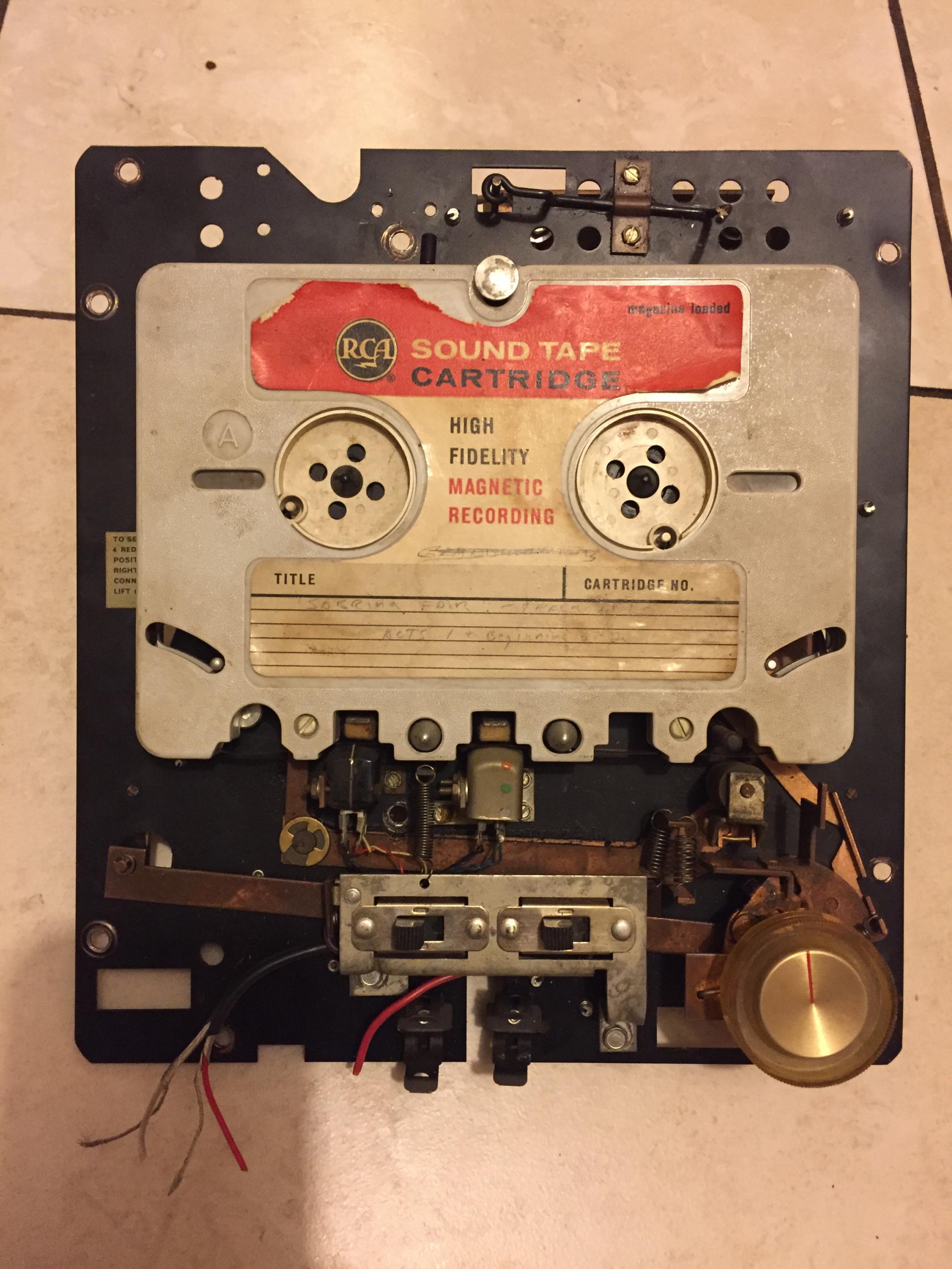

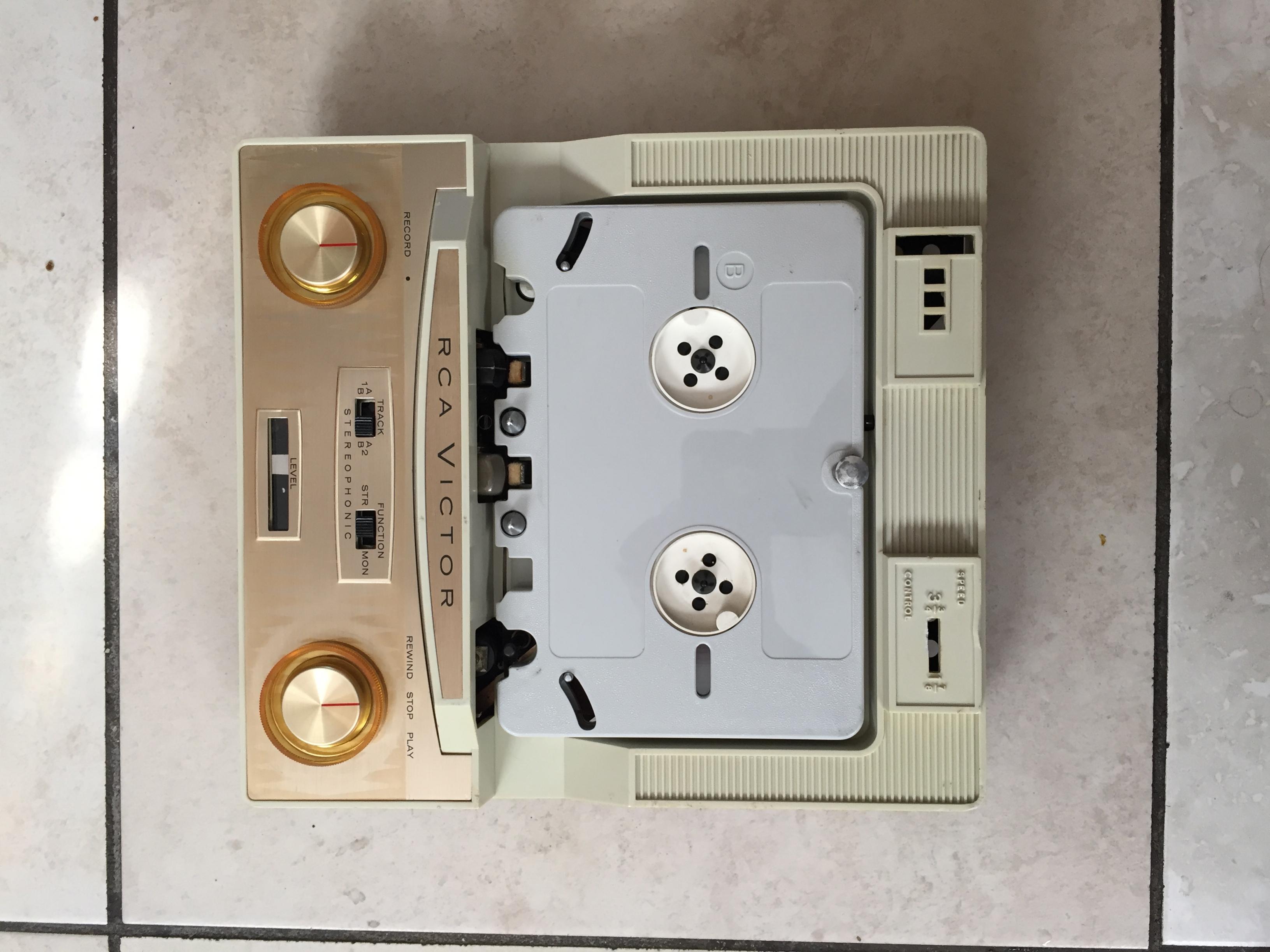

I am in desperate need for a solid state (Non tube) tape head record preamp and bias circuit for a 1/4" NAB 3.75 ips RCA Victor tape cartridge player/recorder, I was able to salvage two identical mono playback only preamps from two Fedelipac cartridge players but I still need to be able to record and erase, I was looking to salvage one from an old 8-track player or real to real but the technology is so old that most of them have capacitors problems, Any modern good quality DIY or assembled kits out there ?
It's a nice find but I will have to figure out all the wiring diagrams and how to isolate the rec/play preamp from the rest of the electronics.
As to why I want to do this? I want to be able to playback and record on RCA cartridges its that simple.

Ok let me make sure we are in the same boat, You do realize that I have only a mechanism and the playback/record and the erase heads, I need the tape head circuit not the amp that drives speakers?
Yup, got it. Here's a few things you may not realize.
The heads you have are, from left to right, erase, then record/play. The same head is used for record and play, which means you'll need to build up a switching system that transfers the head from the play amp input to the record amp output. Are you up for that?
Next, setting up and equalizing the system. Normally a tape deck is first adjusted to play back a test tape properly. That's done by adjusting play level and the play equalizer to play back the reference tones properly, while observing their level on an oscilloscope or meter. For stereo machines, the play head must first also be aligned to the test tape for best high end frequency response and inter-channel phase response, which is a mechanical adjustment of the head physical position. This requires an oscilloscope. Once the play side is set up, you work on the record side. Two head decks are harder than 3 head decks because you need to record tones, then rewind and play them back, then record again making small adjustments. You start with bias level, adjusting for a peak in output at 1kHz, then you go for record EQ which is adjusted so that test tones play back properly.
Are you up for any of that? Got the test gear? You'll need at very least a tone generator and oscilloscope.
Next, you'll have some mechanical issues to deal with, which actually should probably come first. Got good pinch rollers? Capstan motor work smoothly? Belts? Brakes? The slip-clutch take-up drive? Not much point in doing the electronics if none of that's working well.
To simplify the project, you could get a 1/4 track stereo reel-to-reel deck (working) that runs at 3 3/4 IPS and record your tapes on that, then take the cartridge apart and load your tape in. Then just adjust the head and play EQ for the best sound by ear, at least you'll come close and don't need any special gear.

Piece of cake, I'm aware of all this.

I initially wasn't planning on doing this thinking a 3.75 ips NAB preamp should be ready to go, But if it's a must I don't have a problem with it, I have an app for tone generator, I will use my DAC with my phone to get a clean line level tones, As for the oscillo. I can get a cheap one or a USB type one.
The mechanical part has been taken care of, Everything is cleaned, lubed and adjusted to the spec.

Ok, Finally I found and ordered a record/playback preamp board along the power supply board for an Akai GX-4000D. It's a single board everything is in it, I will come back here when I get it for calibration help.
