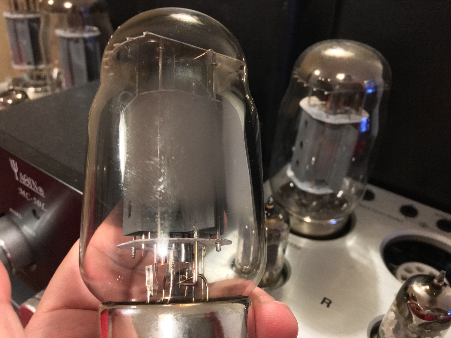

Bonus riddle: I know that you're not supposed to power up tube amps without speakers (or a dummy load) connected. But I was playing around with my speakers, switching from one amp to another.. and I did. Twice (once for less than a minute, the second time for about 20 minutes). Some time after the first time, one of the power tubes went out (it wouldn't bias over 400mV with the pot all the way up, and had a silver coating on the inside, where the others didn't). The second time around, with a fresh set of new tubes, nothing seems to have been affected (and that was the time I left it disconnected for 20 minutes!).
How come? Could it have some kind of protection built-in? Is it something one of you can figure out by looking at the schematic?

Let's see a photo of your destroyed tube! The amp could oscillate without a load, and hot swapping the speaker cables on a running amplifier can also cause some problems.
Hi audiowize, here it is: IMG_0091.JPG
The other ones were still clear, and this one wouldn't go over 400mV. The new JJ tubes bias just fine and are very stable over time.
What should I check for?
Using your oscilloscope, see what you get out of the speaker terminals (using an 8 ohm resistor as dummy load) when playing a 1 kHz square wave: That will give you a pretty good idea as to possible oscillation or frequency response anomalies and can very quickly tell you what needs to be done.
