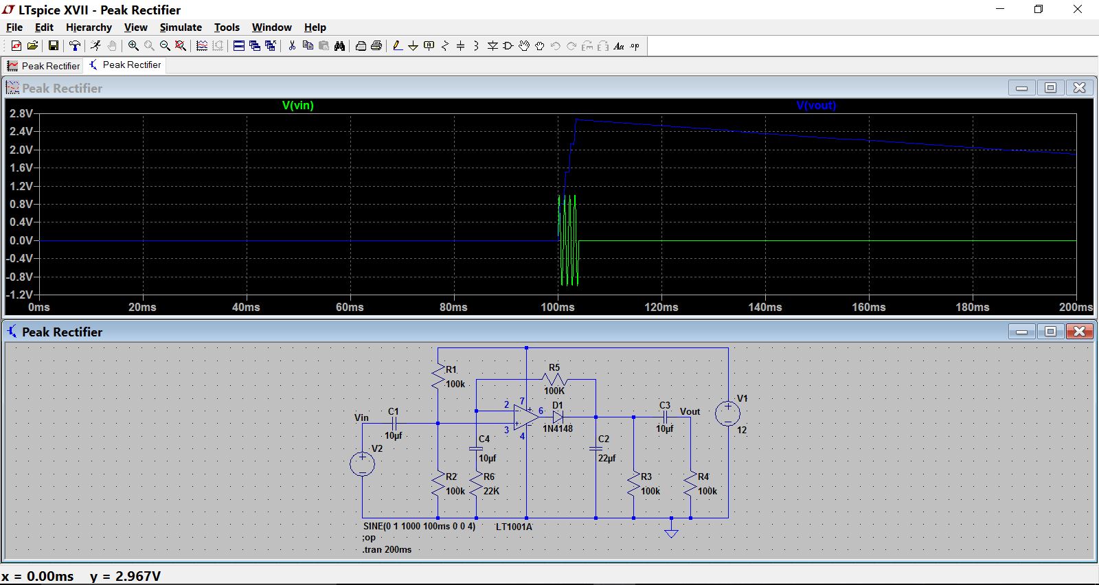

Its a good question. As you have found out, the meter only responds to DC and so needs some means of rectifying the incoming audio. The silicon diode loses an awful lot of voltage across it (around 500mv at really low levels) and so its not a good approach.
A germanium diode is better (around 120mv lost) but better still is a proper meter drive circuit.
Ideally you want the circuit to 'hold' the peaks a little such that the meter has time to respond and also if possible to remove the diode volt drop. That can be done by including the diode in the feedback loop of an opamp.
Look at this. The input is a short tone burst of just a few cycles. The output is a DC voltage that rises quickly and decays slowly.

That has one of the things I was thinking of - a "precision" rectifier.
basically using an op amp you can make a diode with no forward voltage drop.
