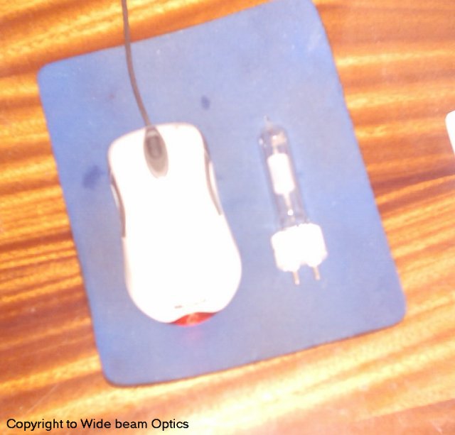

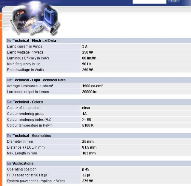

Darn why you get that bulb for? lol you should have gotten a HQI-TSD lamp, they have a built in uv filter, are 25mm in diameter, 165mm long, 20mm arc, 20000lm, 5100k, and with a 90cri, they are also 80-90lm per watt eficientcy. With this bulb we can capture more light and have a much tighter light engine thats more acurate and efficient.
About the reflector from jcb, thats not too good, he runs them at half focal or there abouts so the rays arent acurate and the focal is just too long, (the reason why they are run at half focal), you will loose light with it. However given that if it has an enhanced aluminium surface you will see the difference, i have one here thats not the same as his but has the enhanced alloysurface (50mm dia, enhanced aluminium surface, 50mm focal, 1/12 wave length) and ill tell ya right now, becarful, because those things burn holes in lcds. Mine nearly did with a 150w mh CDM-T bulb and a heap of cooling on the lcd. :xeye:
You can get a decent dichoric reflector for yours BRAND NEW for about $50 in that diameter, but if you had of gotten the bulb i sujested up top, you could of gotten a smaller reflector that will give you a brighter image and possibly reflect more light for about $30.

You said "5100k, and with a 90cri". Who makes that bulb? I would like to look at the spec sheet. I am always willing to try something better!
And who sells dichroic spherical reflectors for $30-$50?
An HQI-TS form would be much easier to fit to a spherical reflector. And a smaller arc length would be nice, too. (Just a bit harder to use a double-ended bulb with a big parabolic or eliptical reflector, maybe.
Actually you can, im suprised no body has thought in how to do this yet, im holding it back for now (atleast until i try it first 🙂 ), same with the reflector link as its been proven in the past my links and designs are what some others like to profit on.
Osram, here is their spec sheet.

Thanks, I have been poking around on the Osram site and never saw that bulb! Maybe it is newer than their website.
The little ceramic bulbs look nice, too. But I have not seen one above 150W.
