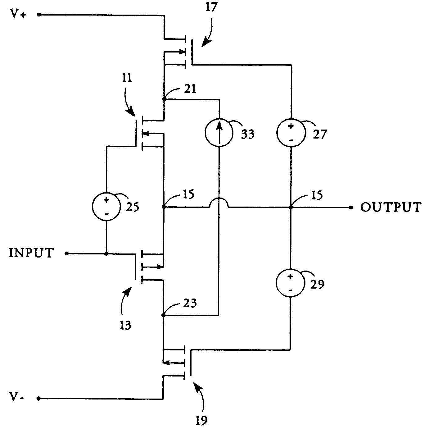

Sano, et al inspired my patent #5343166 which replaces
floating voltage sources with floating current sources in
a cascoded output stage.
This topology is useful for high power amps. Technics US pat. is #4115739.
Another approach, similar to Technics, is described in the Pioneer US pat. 4476444.
I would have thought that the main use for the topology would be to make it practical to build 50 - 100 W etc "class A" amps, i.e. without heatsinks that double as central heating. For true high power amps other topologies such as class G or H would be more appropriate.

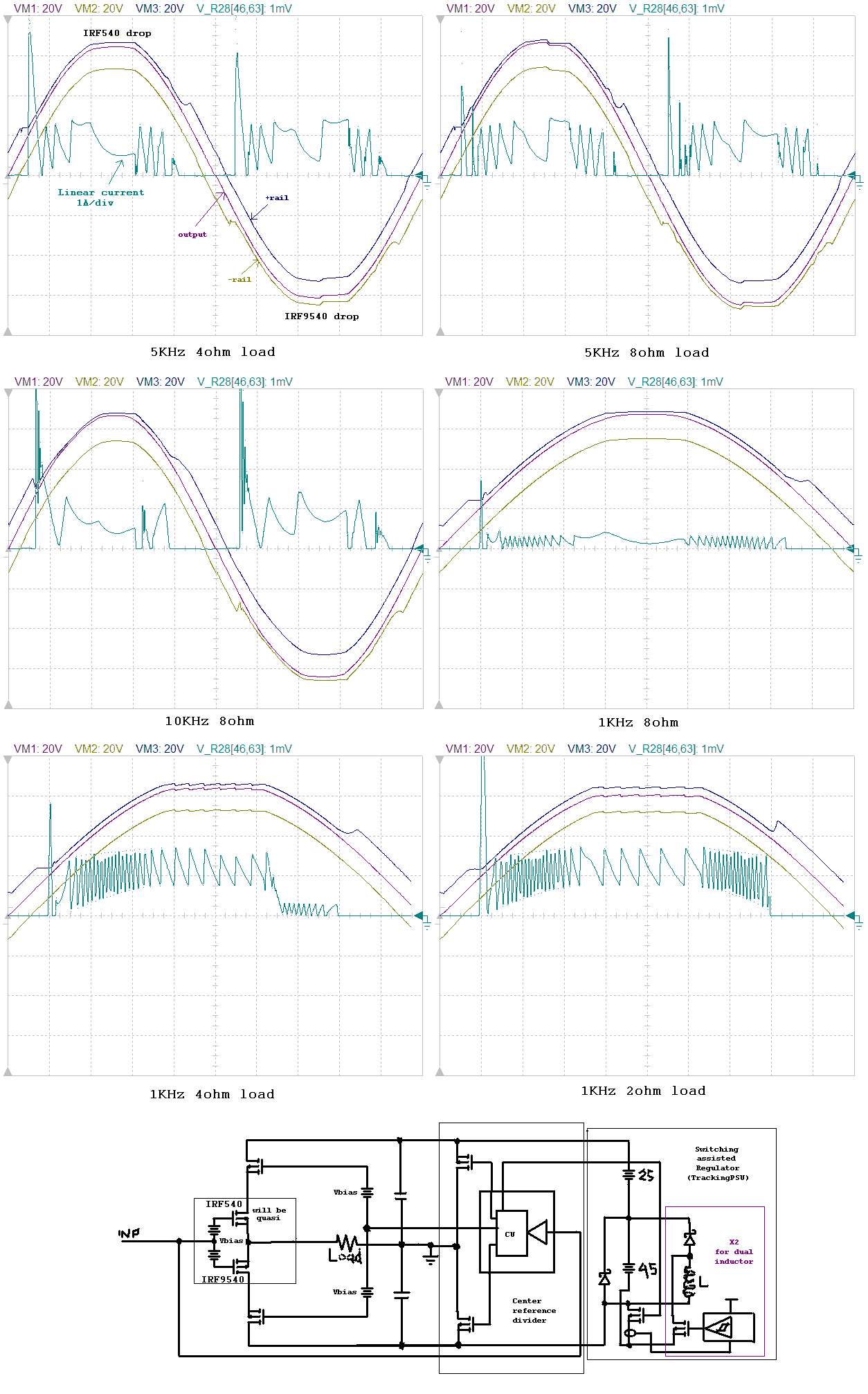

#4115739 apr-1977 is better than #4476444 for me. Lagging supply in #4476444 will only happened in poor designed digital amplifier (supply swing). Amplifier work as voltage follower already gives many advantage for its digital part.
This is my digital supply with slew limited for 8KHz bandwidth (voice amplifier):
I forgot it. If the supply swing in #4115739 lag, it will also happen in #4476444, so there is no improvement in #4476444.

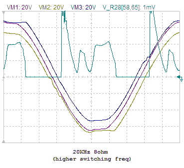

Faster version, it will cost less in eficiency.
