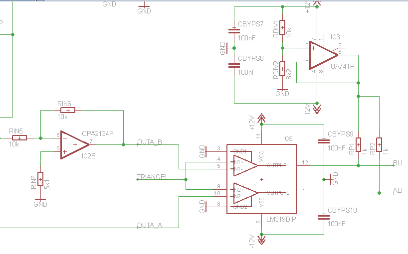

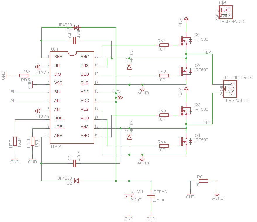

i try to make a class D audio amp with hip4081.the schematic draw below.
pin ALI and BLI is from unipolar PWM. that triangel wave signal compare with audio signal and the inverting audio signal.
i want to ask :
1. why when I turn on the supply 12V for HIP4081 audio sound is heard only briefly and then ic HIP4081 became very hot?
2. whether the components I use are correct?this schematic is right?
