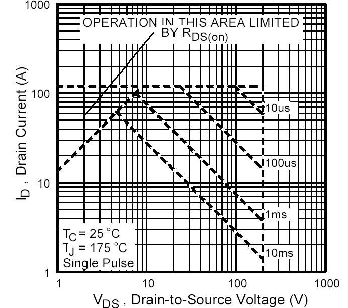

hello paaji
here is the soa curve of IRFP250N

Note that the SOA of the IRFP250 is totally different to that of the IRFP250N.
Rajeev, the graph is on the datasheet. An easy download from the IR website 🙂
