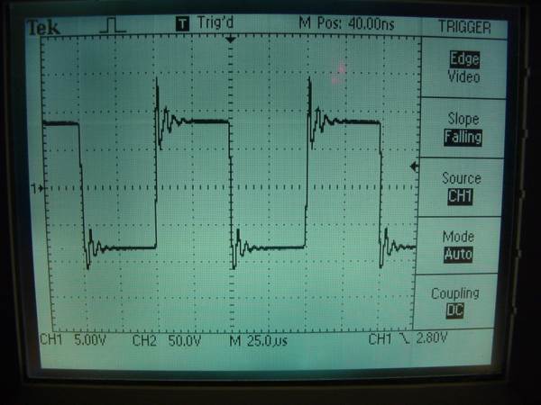

Sam: Sure! I will send as soon as i have the PCB's ready, and i'm sure it's stable, also in 500 Watts, with high capacitive load, high temperature and high frequency signals. All simultanously.
My own versions will be 500 Watts / 8Ohms with APT50M65 or IXYS equivalent. So i will sort of start with the high powered version, and work my way down to 300, 100 and (just for nexus ;-) ) 50 Watts.

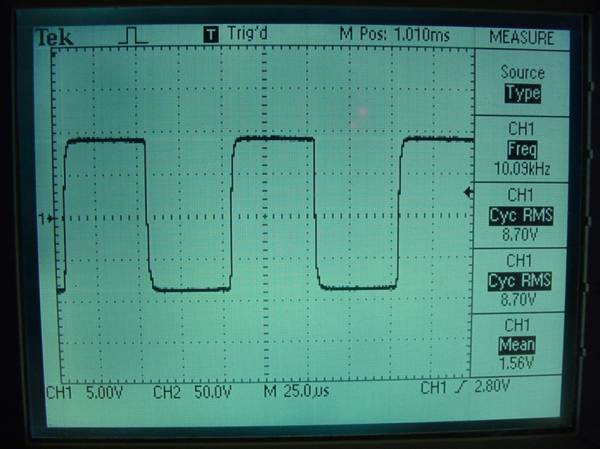

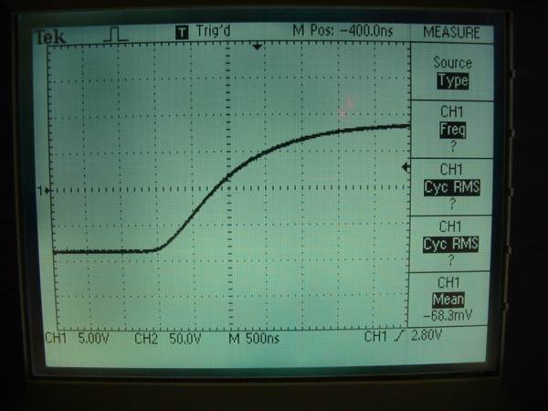

And last 10 kHz square wave with 8 Ohms resistive with 1 uF parallel load. The classic stability test.
There are no coils in series with the output, but it still maintains stability. This is due to the shift to local feedback at high frequencies.
The stability test was done at 8 W power, which is the worst case for this particular setup. At higher or lower powers, the ripples are smaller.
