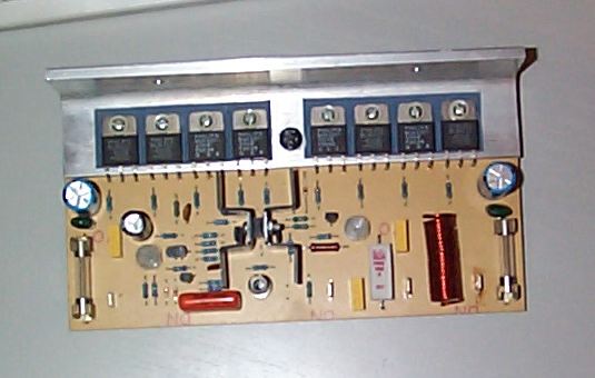

Hey Rajeev; Source / Emitter resistors
I have built amps that use source resistors in the output stage and amps that don't.
I built a few amps based on an altered quasi-complimentary Elektor design around 12 years ago using Philips BUK437-400B power FETS. In this amp there were no source resistors and I used closely matched FETS. Whilst these FETS were well matched on the bench in the dynamic environment of the cct the current was not shared equally. In practice this was not a problem, though I hoped that the FET dissipating most of the heat (up to 14 watts idling) wasn't the furthest from the thermal detection diode.
Since then all of my amps (including the same amp modified) have used source resistors for the following reasons.
1. Better current sharing, plus the quiescent (bias) current through the output stage is better stabilised under differing conditions.
2. A fixed and constant resistor added to the Rds-on of the FET makes for a more linear stage.
3. Depending on the output stage setup, the small voltage drop across the source resistor can provide local feedback to the gate drive, further improving the linearity of this stage. In my latest design this works as follows.
As the current increases through the source resistor the gate to source potential is decreased. This tracking (or feedback) would not work without the source resistor.
A bit of a jumbled response, I hope some it is understood. A piccy below of the amp module I described above.
Cheers
PS. The BUK437-400's were a real sweet FET. Curse you Philips for stopping production.
