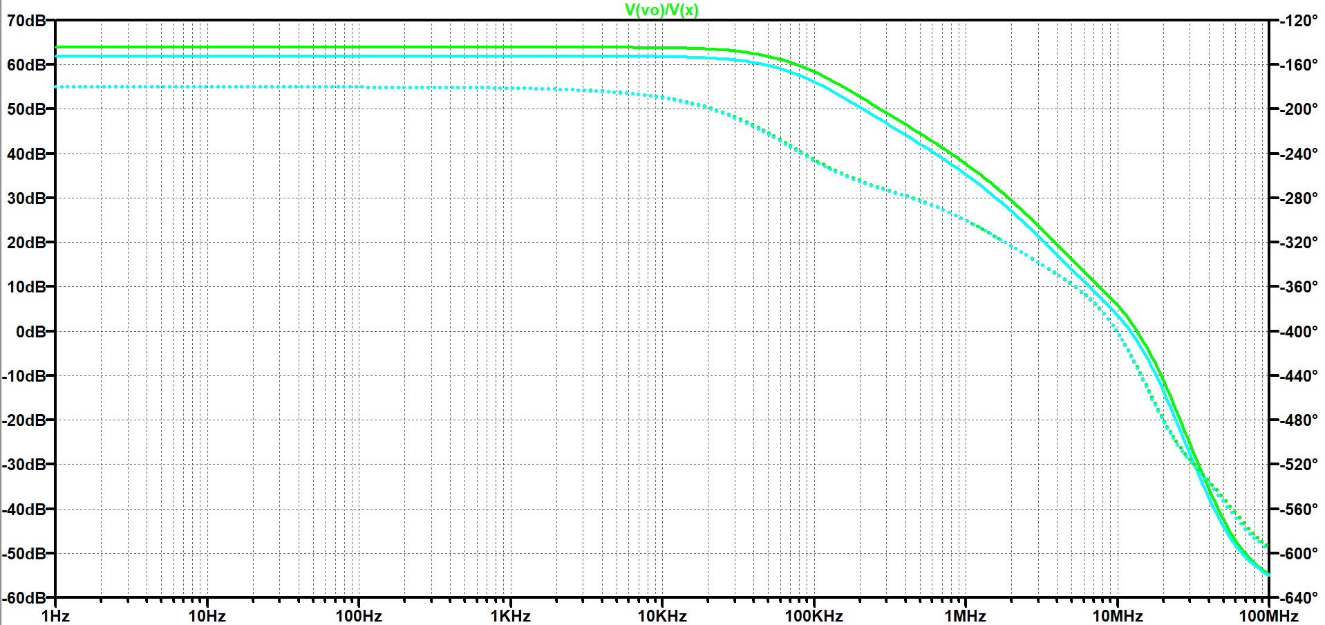

To my earlier post about TPC/TMC and the loop response without compensation, here is a loop gain plot without compensation. With TMC/TPC, you exploit the high gains available while the TIS/VAS is operating in the gm regime - that's the flat top part of the plot below. When you add a comp capacitor around the TIS/VAS, the amplifier operating regime becomes that of an integrator, so you get the dominant pole splitting shape most opamp open loop plots display (here I refer to internally dominant pole compensated opamps like an LM4562 or OPA1641/2/4)

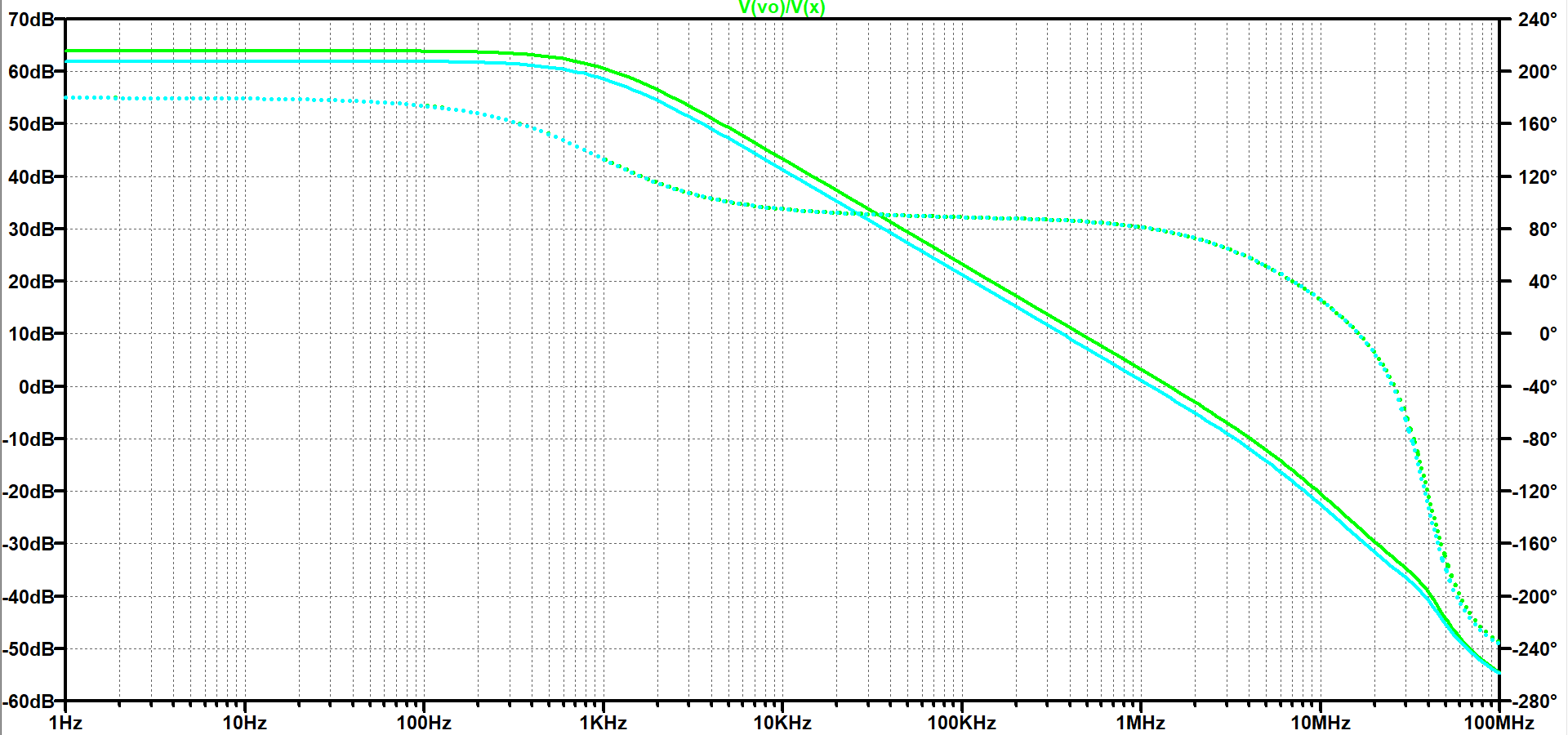

Here is the same amplifier, but with dominant pole compensation.
