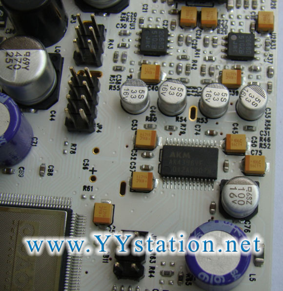

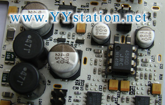

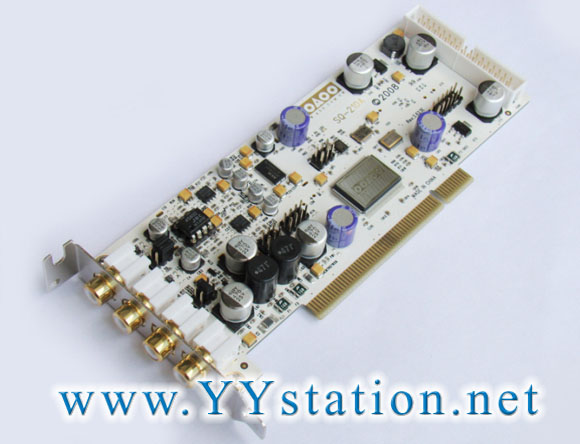

Mystical PCI soundcard

I may be off-base, but it sure looks a lot like the ESI Juli@, including the description (i.e. I2S out from the header).
Search the forum for the Juli@ - there should be some photos. If it is the same, it's a very good card - and at $50 it's a great deal.

Nah, not the same as Juli@, but interesting nonetheless.
Urgh, not even close. I guess I was blinded by the white circuit board.
°ÁÍõÉù¿¨
Hmm...VT1723 'Tremor', not as good as 'Envy'. :/
If all you want to do is pass the bits unmolested out to an I2S connector, either should get the job done, although only 6 output channels vs 8. If seems to indicate only 2-channel I2s, but if this actually sends all 6 channels of I2S to that connector it may be a very interesting card indeed.
All what i am hoping to achieve is to use this in my new PC-central with big disk array for playing my Flac files and movies in stereo only. ( i take it from the description that this card is stereo)
I have found that the Esi Juli@ is great but it is a bit out of my budget and has allready more functions that i can need, so i was hoping that this card may be cheap substitute. It seems that the only way will be buying one and testing it. 🙂
