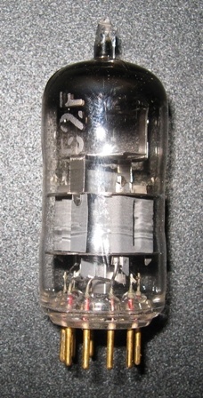

I recently received a Fisher FM-90X, dirty but it works great, nos tubes and all. One of the tubes listed on the chassis and in the schematic is designated as a "V50,064". I can't find any data on this, any ideas what it is?
Can you post a pic of the tube as it is mounted in the amplifier? That may help.
After checking out the schematic for the FM-100 from gingertube's response I came up with this, an Amperex (or Valvo) 6922 PQ, late 50's.
It has the gold pins & pinched waist described in this link: http://spazioinwind.libero.it/themagicsound/_private/6922pinch_waist_eng.htm
The only markings on the tube that I can read is the "52F", which you can see in the picture. There is a fainter marking that I think is "46L" but I'm not sure. Maybe a date code?
What do you think?

You know, I checked out the Sams Photofact and it listed the tube as a "v50064" Ha!
A 6922 it is then. Thank you for you help in identifying this tube, I appreciate it. Now I know what to shop for if I need a replacement.

I can verify for sure it is a late 50's Amperex 6922 Pinched waist.
This is the "cascode" tube in the Fisher Golden Cascode circuit. It was an innovative RF amp circuit that was also used in many later Fisher tuners. I also have an FM90X here. Funny thing, I bought it a long time ago, and then bought some Amperex 6922 pinched waist tubes (cheap) to use as exact replacement spares. Many years laterI find out this is the holy grail tube for many people, worth big $. 🙂
