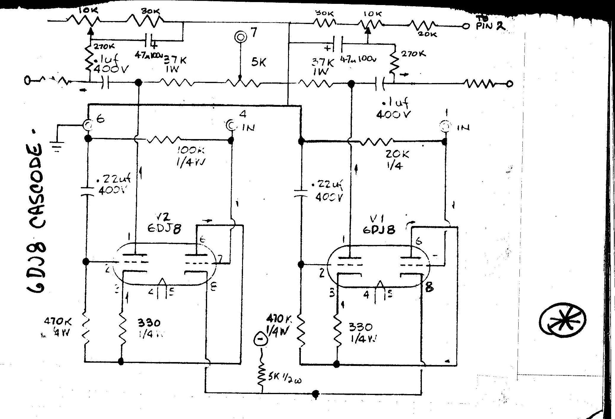

I just figured out your voltage lists, I was looking at it wrong. Andy used a tube for each side of the cascode, I was thinking a tube for the upper and a tube for the lower, clear as mud now. Anyway the side with 363VDC is way too high for a 6DJ8, so I would have say that tube is NOT conducting, is the heater lit up? The professional soldering OK on the tube socket? Swap tubes around and see if the voltages follow.

Heater connections are ok. Swapped tubes and voltages stayed within a few volts of what I posted. I pulled one of the LM334-z's and nothing changed so I re-installed it and took out the other LM334-Z and blew the zener diode so I am assuming that one of the LM334-Z's wasn't working. But then I could wrong 😕

Is there a voltage on the schematic for pin8 ? Your photo is cut off where the line is leading to it. With the cross-coupling you are getting voltages that normally wouldn't be there if the tube was not conducting, hard to tell from here. For example, there would be no voltage on pin 6 if the that tube was not conducting, so the voltage is coming from the cross-coupling. You know it's going to be something real stupid, it always is. Keep at it. Oh, can you tighten the pins in the socket, that's always a forgotten problem.

The voltage on pin 8 on the input side was 2.46 and 2.41 on the other side.
Plate voltage is roughly 100 low on the input side and 100 high on the other side. Your right its probably something really stupid but I'll be darned if I see it right now. I'm about frustrated enough

Ok, plate voltages are more in the ball park now. Recent tests now show that the current sources are to blame for its inability to produce a nice clean sine wave. The signal is good on the input side of the tube and gets nasty looking on the feedback side.
So the question now is can I replace these CCS's with a different CCS board.

Possible reason for the parallel CCSs is the max. current for a 334 is only 10ma. By my calcs using the voltages on the posted schematic 420/225 VDC I get 6.5ma per side for total of 13ma., too much for a single 334. Yes-no.

Thanks for the reply. I believe the material I have states 5.8mA (170-175) voltage drop so the 6.5mA would be right in the ball park. If I had some LM334-Z's on hand I would try another pair per side but I do have some nice little CCS boards courtesy of SY that I could try.

There are so many voltages listed for the same node it 's hard to tell what number goes with what number. I got to thinking maybe one is for ST70/MKIV and the other set for the MKIII, don't know. Anyway at 5.8ma times 2 we're still over the limit of a single 334. Looks like you're on the right track though.

Here is the schematic for the board. The 100-k input is the audio (from jack). The 20-k input is the feedback (via a resistor from the 16 ohm tap. The B+ should be 400-V and the tubes should be 200 on top plate and 100 on bottom plate. They should be selected to be around those equal splits in voltage. The tail input via the 5-K ½-W comes from the bias supply. A single point ground is suggested. Filaments should be elevated by 50 volts. That can be made from the b+ with a couple of resistors and a cap, or my making a bias type supply but for 50 V positive. Have fun.
