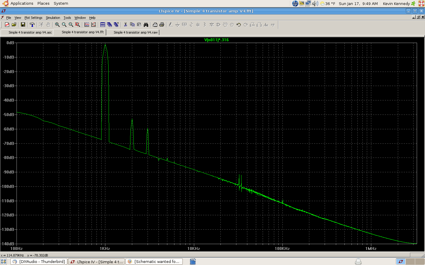

Here is some more tinkering with the design, performance has gotten a lot better, but the real world transistors in the sim would need to be replaced with something comparable that can dissipate the required power. The output stage is biased to something like 380mA quiescent (a little into class AB at 1Wrms level) which would fry the devices in the simulations. The nice or not so nice thing about spice is that it will allow you to run devices without regard to their voltage, current or dissipation ratings. Good working simulated circuits that would blow in the real world are quite possible. Generally similar devices with the required power handling are available. The jfet is fine as is for the supply voltage shown. Lower impedance loads probably not a good idea..
Note that the comment about dissipation could be true for the other simulations as well.
The FFT is at 1Wrms output... Note that the dominant harmonic is now 2nd, third is even further down, and higher order are not significant. Who knows this might even sound good with careful selection of appropriate devices and some addition work to optimize operating points for the devices chosen. As a tube guy I'm not going down this path for the moment, but hmmm I might think about it for the future.
Edit: Some further details from the simulation:
1. Q2 collector current is 64mA.
2. Output stage quiescent current is 380mA.
3. Output stage is symmetrical at half supply.
4. Open loop gain has fallen to approximately 41dB.
Linearity in the VAS has improved significantly, and greatly in the output stage, hence the improved sims.

Noted that more than half of J1 drain current is flowing through the base of Q2, further simulation revealed that a reduction of 2nd harmonic of about 6dB was possible by increasing R1 to 20K which slightly increases the open loop gain and results in most of the drain current flowing through the base of Q2. Perhaps not what we would consider a great design practice... 😛 This all hangs quite precariously on the characteristics of the transistors used - quite a departure from what today would be considered good design practice.
How well this would work in practice is another question. 😀 😀
One further suggestion I have if anyone is actually thinking about building any variant of this design is the replace the bootstrap with a simple CCS - the current flowing through the load particularly in my "improved" version is far too high for a quality loudspeaker, depending on VC dcr the standing dc voltage across the voice coil could be in the vicinity of 400mV - not a very good idea.

Yet Another Variant
Here is the latest with a sleazy CCS substituted for the original boot-strap. FFT shows similar preponderance of 2nd - 3rd order distortion in the spectra. It is a couple of dB higher however. The output power is 1Wrms.
Using a darlington output stage would introduce an additional pole inside of the loop making it harder to compensate, and IMO isn't necessary for a very low power amplifier design such as this..
Obviously some additional work would be required to compensate this amplifier with the appropriate transistors. The CCS and 2nd VAS transistor should be able to dissipate a couple of watts each, and the output transistors should handle a couple of amps and be able to dissipate 30W or so each..
Compared to more modern designs this one has quite limited open loop gain and the feedback margin is slightly under 20dB (10X). It might be worth building for a small efficient full range speaker system.. The quality of the output capacitor is important. The design has no zobel network on the output, nor a series inductor - I leave it to others to determine whether or not these are needed in a specific application.

you did a great job. JFETs should not be forward-biased.
It's a curious design.. 😀 Depending on the fet chosen the bias will be approximately -2V from gate to drain, so technically it isn't forward biased if I understand your comment. (The FET operating point actually makes the output stage center at about 1/2 the supply rail - at least in the simulations, some tinkering might be required in real life to get it close.) Actually this bias arrangement is a very common approach in musical instrument fet front ends and works fine with a little care.

I would omit R7, reduce the value of R8, R6, R3 and insert a series gate resistor. I`d also try to omit C1.
