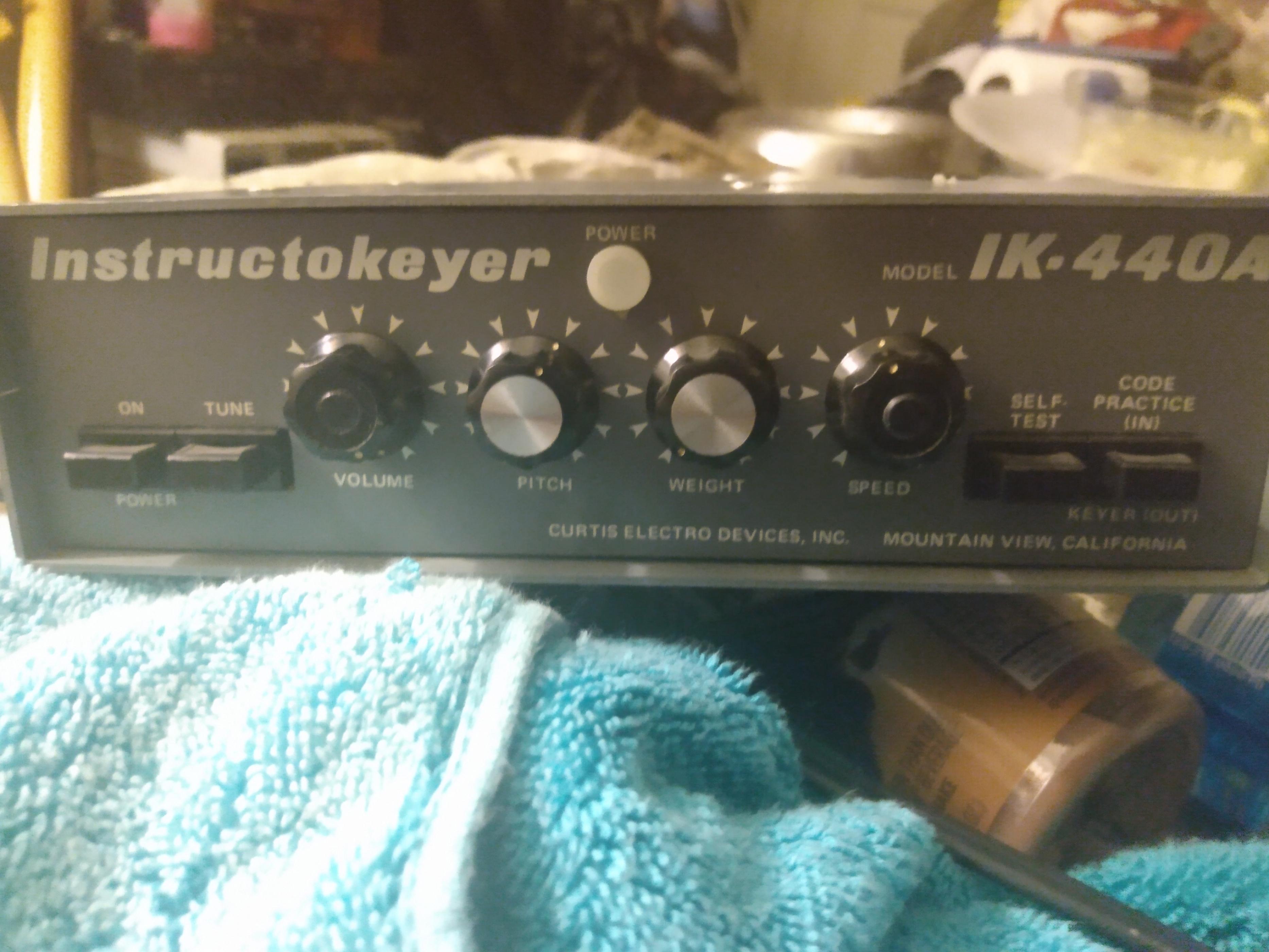

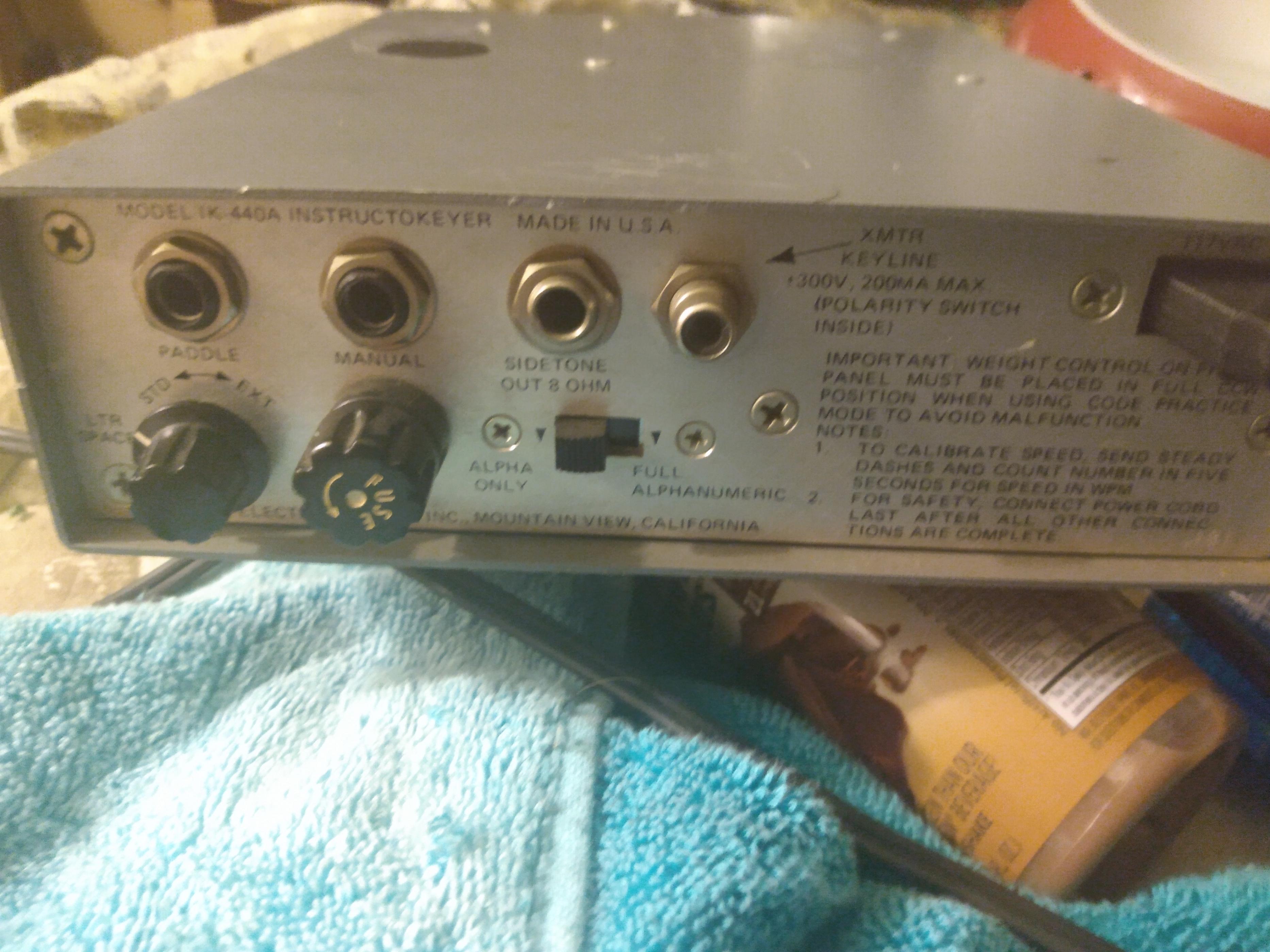

Someone gave me this strange piece of equipment I've never seen nor heard of. Help me to figure out what it was used for, if it is still used for anything or will it just be a door stop or worse yet-end up in my scrap pile. It's a Instructokeyer IK-440A and it sits in a half rack little gray metal box with a few knobs on it (volume, pitch, weight and speed) and a few buttons(on power, tune, self test and code practice?) The rear panel has some 1/4 in. jacks(paddle, manual, side tone out 8 ohms) and a rca jack (xmtr keyline) and a selector switch (alpha only or full ) and one knob(lrt space std<>ext)
