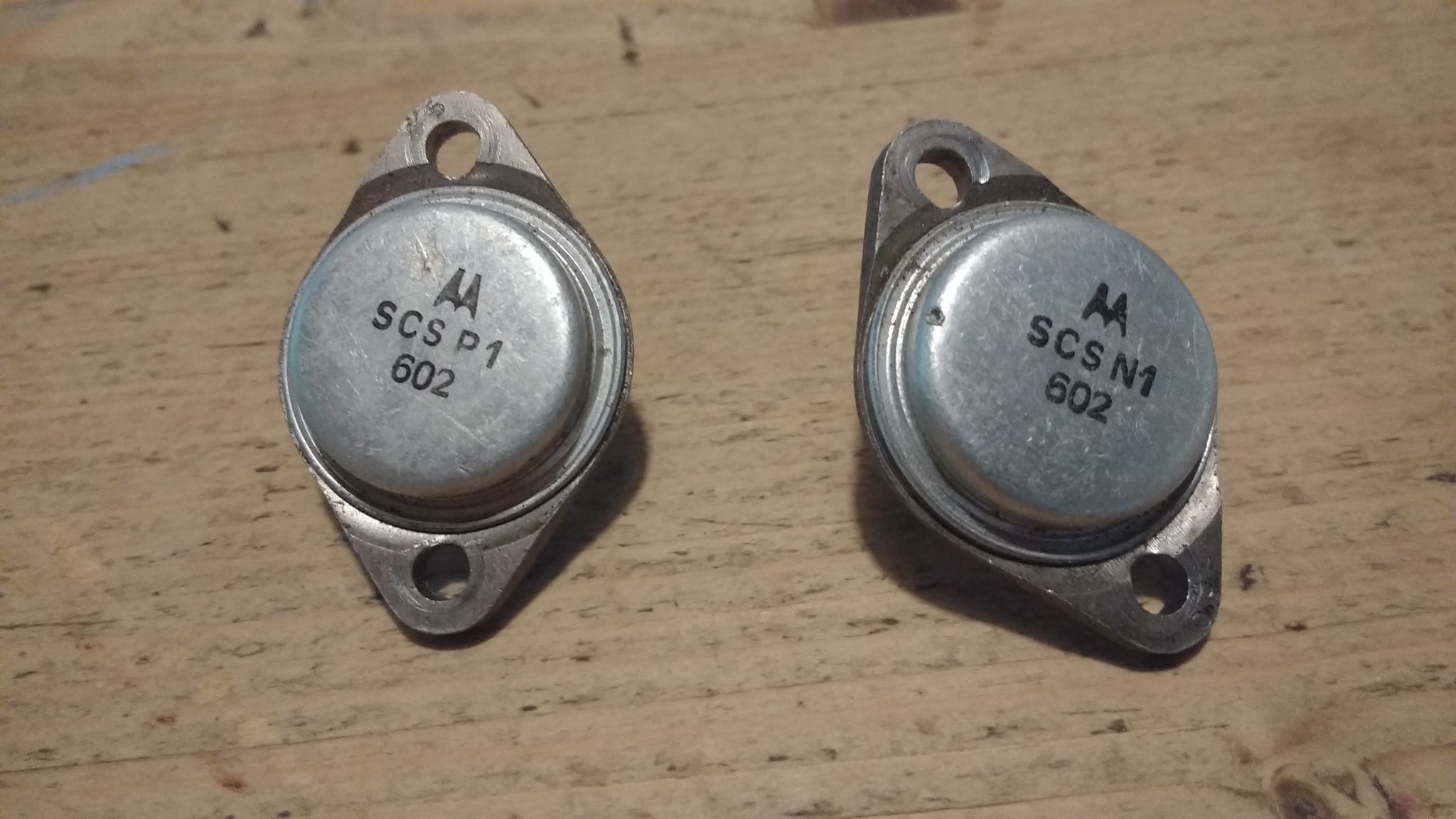

The problem seems to be the output transistors, at least one of them (the NPN one) measures short circuit between collector and emitter. Can't be good. But here to, I am unable to find any reference. Here they are:
Looking at the PCB, I see no driver transistors, so I think the above individuals are darlingtons. But how to know? with my multimeter on diode check, the readings are:
NPN:
C to E short circuit
B to E 0.6v
B to C 0.6v
E to B 1.8v
C to B 1.8v

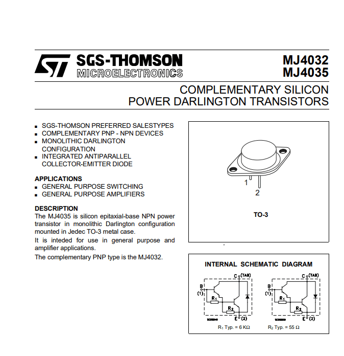

They could be Darlingtons. Normally the B/E junction would drop around 1.2 volts forward biased. The numbers look like in house production codes. Could be something like this:
https://pdf.datasheetcatalog.com/datasheet/stmicroelectronics/4161.pdf
And:
https://pdf.datasheetcatalog.com/datasheet_pdf/motorola/MJ4030_to_MJ4035.pdf
And:
Yes, that's what I thougt, so the PNP can also be considered kaputt I guess, since it has no voltage drop whatsoever between B and E.Normally the B/E junction would drop around 1.2 volts forward biased.
Thank you for your replacement suggestions, I had actually looked at a pair Mj4031/4034, they are still in production in the far east and inexpensive too. It is reassuring you come up with that same device! So I think I will try those. And I need to replace the emitter resistor of the NPN device, it was fried to open circuit.

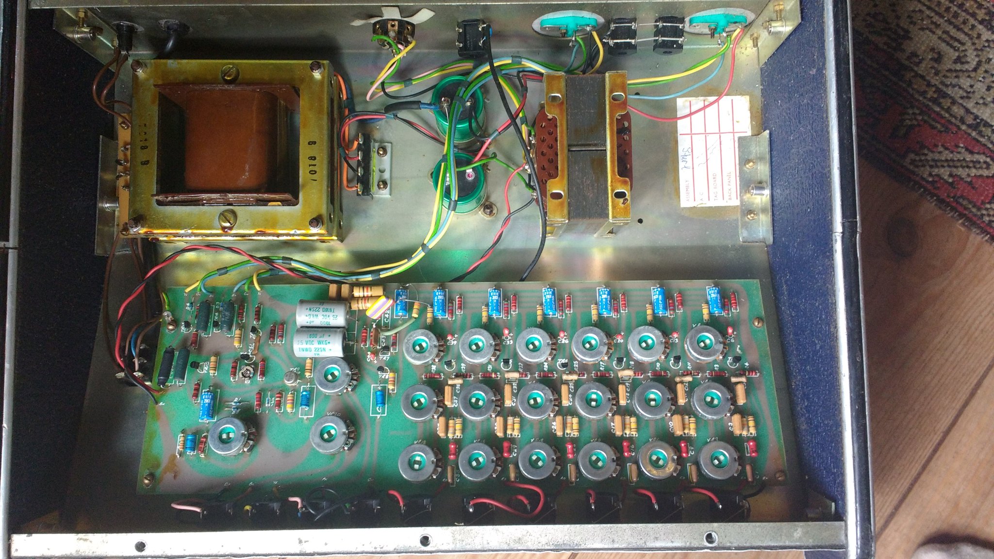

Here is a picture of the inside:
The giant structure top left is the power transformer, to the right you see the output transformer. The designer sure did not skimp on ironware. The black wire there is ground, the red is signal out from amp, yellow green and pink go to the impedance selector. It seems there is always a winding in parallel with the speaker output, with taps you can choose with the selector. With setting at 4 ohms (yellow wire) I measure about 0.3 ohms dc resistance between black and red wire. Does this make sense? or should I suspect a fault in this transformer?
Again, any comments welcome.
G.
G.
It sounds about right. The transformer output is always in parallel across the speaker output because it is the speaker output. The impedance selector would select taps on the output side of the transformer.

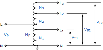

It only has the two transformer coupled parallel outputs. It is an autotransformer with multiple tappings, a bit like this:
So if I understand it correctly, with the switch on 8 ohm with an 8 ohm speaker, the amp tries to deliver 100 watts in this speaker, wich it should be able to. But if I connect a 4 ohm load with the switch on 8 ohm, it will try to deliver 200 watts, by doubling the current, wich would overload the transistors. Or is my logic flawed?

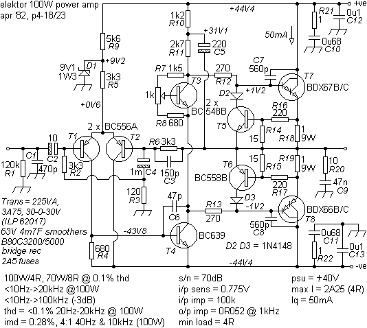

By the way. the amp does seem to have overcurrent/short output protection. The schematic is very much like this:
But the VAS has a ccs and not the bootstrapped current source like above.

Yes, it will try to deliver 200 watts, but the power supply droop will keep it to about 150. If there is current limiting it may activate often, sounding terrible. With or without it will put a heavy load on things and may fry the outputs if sustained. Short term it shouldn’t do much to it. But those old aluminum TO-3’s don’t last forever anyway under high power use, even within rating.

It's a 'Park Marshall' from the '70's. The darlingtons are MJ3001 / MJ2501. So, the MJ11015 / -16 could be used. Farnell still has the MJ3001 / MJ2501 but not the Motorolas.
