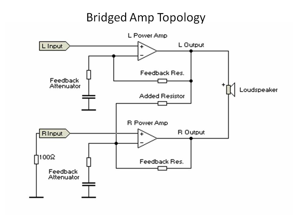

I'm starting to wonder if this isn't a kind of bridge switch
IT could be a switch for Btl Mode Operation. This would explain only one wire from left Output via a resistor and a switch to the right input
This sounds like the only reasonable explanation! If it had something to do with grounding or feedback then the switch would've been a bit pointless.
To be honest I never knew that KSA could actually be bridged as Krell always had separate monoblock amps - the KMA's.

During the 90's I owned 3 of these all at different times. The back panel key was to convert the unit into a 100 watt mono. This was all factory installed and nothing was aftermarket. The units came with a 6 inch black wire (used only when in mono mode) that was nicely terminated with coper ends. This was used to short the black (common) rear of amp speaker outputs. Only the Red terminals were used to connect the speaker. The only issue is I am not sure if you are to use the right or left rca for input. For this answer you would need to call Krell service.
