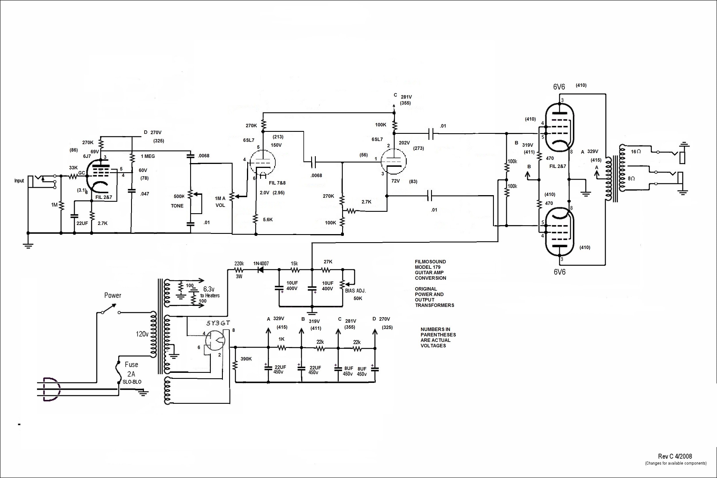

I used that article for a Filmosound 179 conversion (very similar to the 621) and found it very useful.
Attached is the schematic that I used from another forum site, which I adapted to use with 5Z4, 6SL7, 6SJ7 and a pair of JJ 6V6 all power with a Hammond 290BEX transformer.
I also found a decent source of information on the various B&H amps, so have a gander and see if your 626 is among them.

I made that schematic a few years ago. The amp and cabinet actually has been sitting on a shelf for a few years now. I should go fire it up and make sure it still works. After a few years i often ask myself "why did you do that", this one is probably going to be why did i use 400v caps for the bias and if my voltages are so much higher than stock, are the filament voltages ok? I often use a .22 ohm or whatever is required in the filament strings to bring it down to 6.3vac, i may have done that but not updated the schematic. Some of these octals often are microphonic and don't show that until the amps is on for a hour. I think there are mil spec tubes of the 6sl7, 6sn7,6sj7 (red painted) i picked up at a few antique radio shows which should be a lot quieter.
EDIT: i do have a old prewar Supro i may have copied some parts from(except it had a 80 rectifier). I do remember the grid cap 6J7, and the pentode front end. Also think the underside of the amp was pretty tight and packed with wire and components, probably get cursed at in 30 years if someone else ever has to work on it. I should hook it up to a EVM12L to hear it without speaker coloration.
