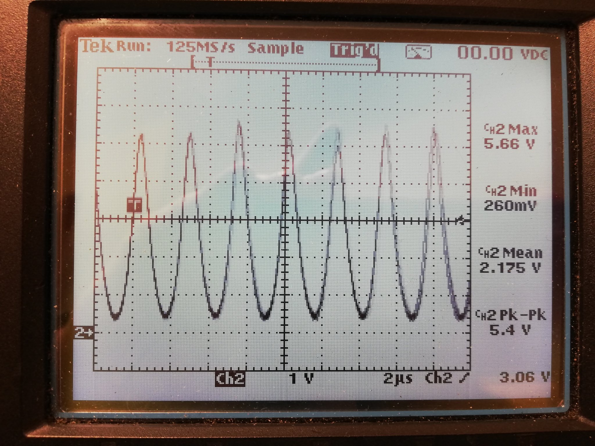

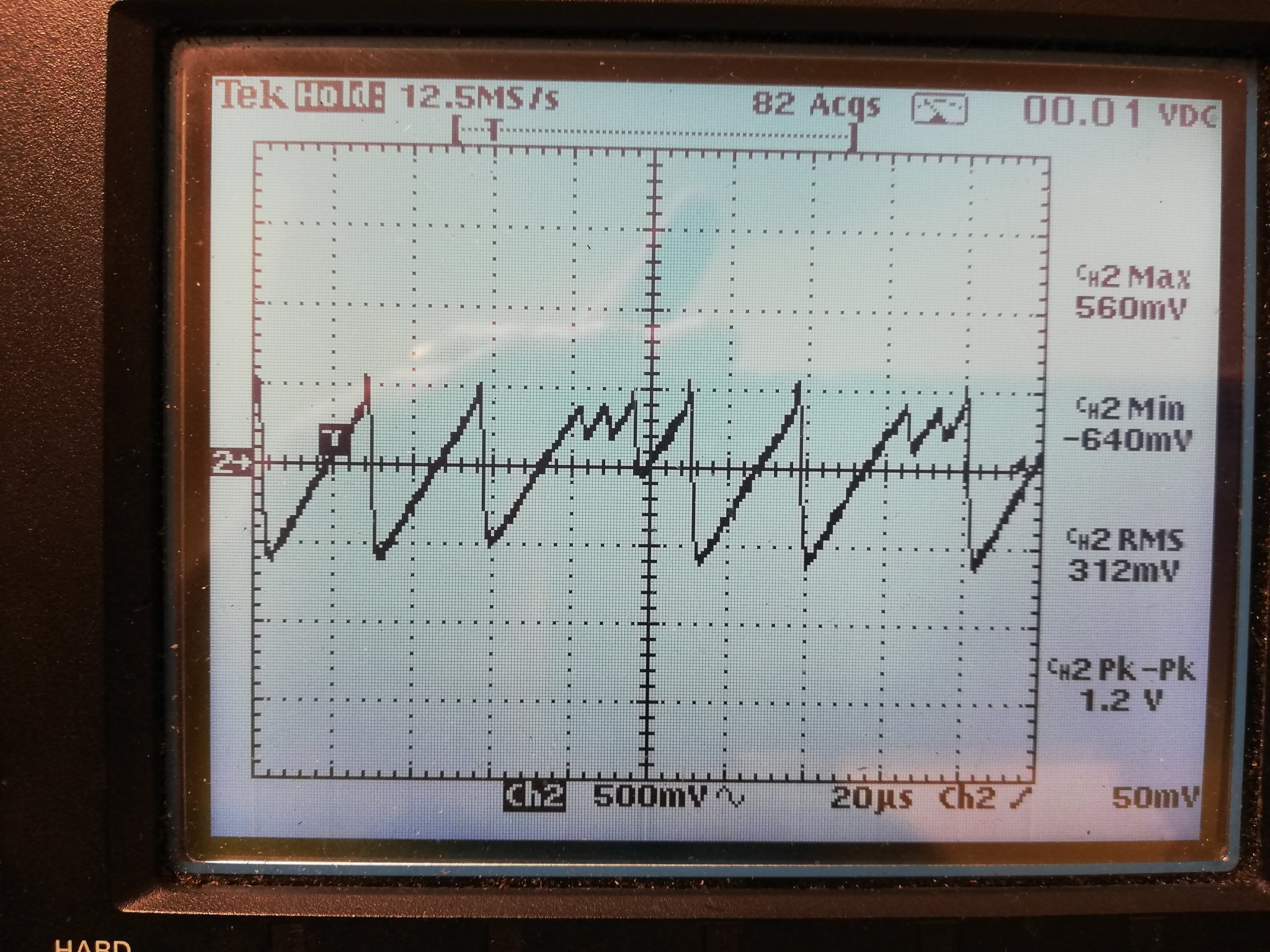

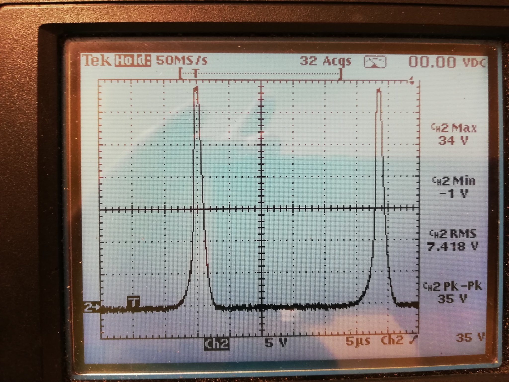

I have changed all the capacitors, Q601 and Q603. Unfortunately, nothing has changed. I have always a voltage (current) peak on the R+ (100 ohm) that I put in series to R609 (see picture 85). This gives an abnormal current absorbtion on the +60V supply resistors and transistors.
But I've seen a strange thing; if I touch with a finger the dissipator of Q601 or the cathode od D603, the current stabilizes and on R+ I find 2,2 V, which is more or less the voltage drop that I expected. Picture 101 is the voltage on the cathode of D603, picture 102 is the same voltage when I touch the dissipator and picture 103 is the voltage when I touch the D603 cathode (more or less the same measure, conside the different scale).
It seems as there is an oscillation which stops when I touch D603. Or something is folating and with the finger I fix...
Any idea?

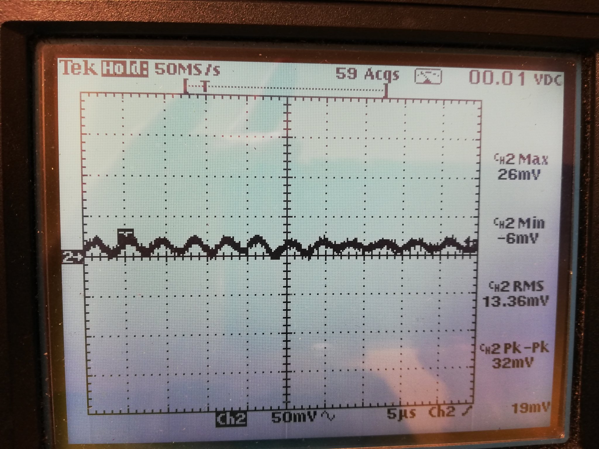

yes, it seems like an oscillation, it maybe caused by Q605 or Q603, since Q605 pins B,C had a capacitor C613 which against oscillation, but you can add an extra 100pf 200V ceramic capacitor on the same location of C613, keep C613 and maybe solder the cap under the PCB. after that If oscillation still there, add another 100pf 200V ceramic capacitor on Q603 pins B,C directly and test again. Normal disc type ceramic capacitor voltage over 150V is ok.

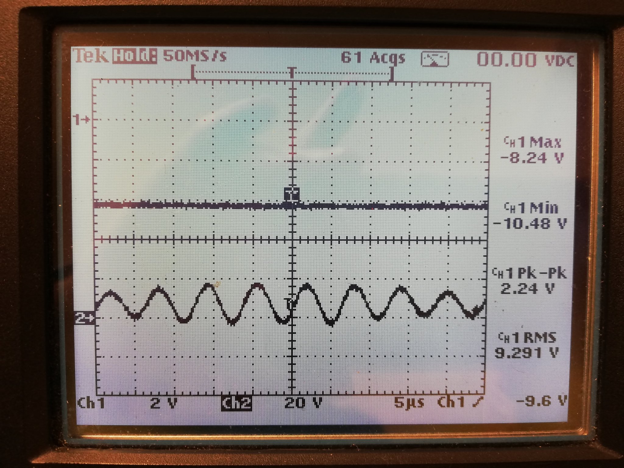

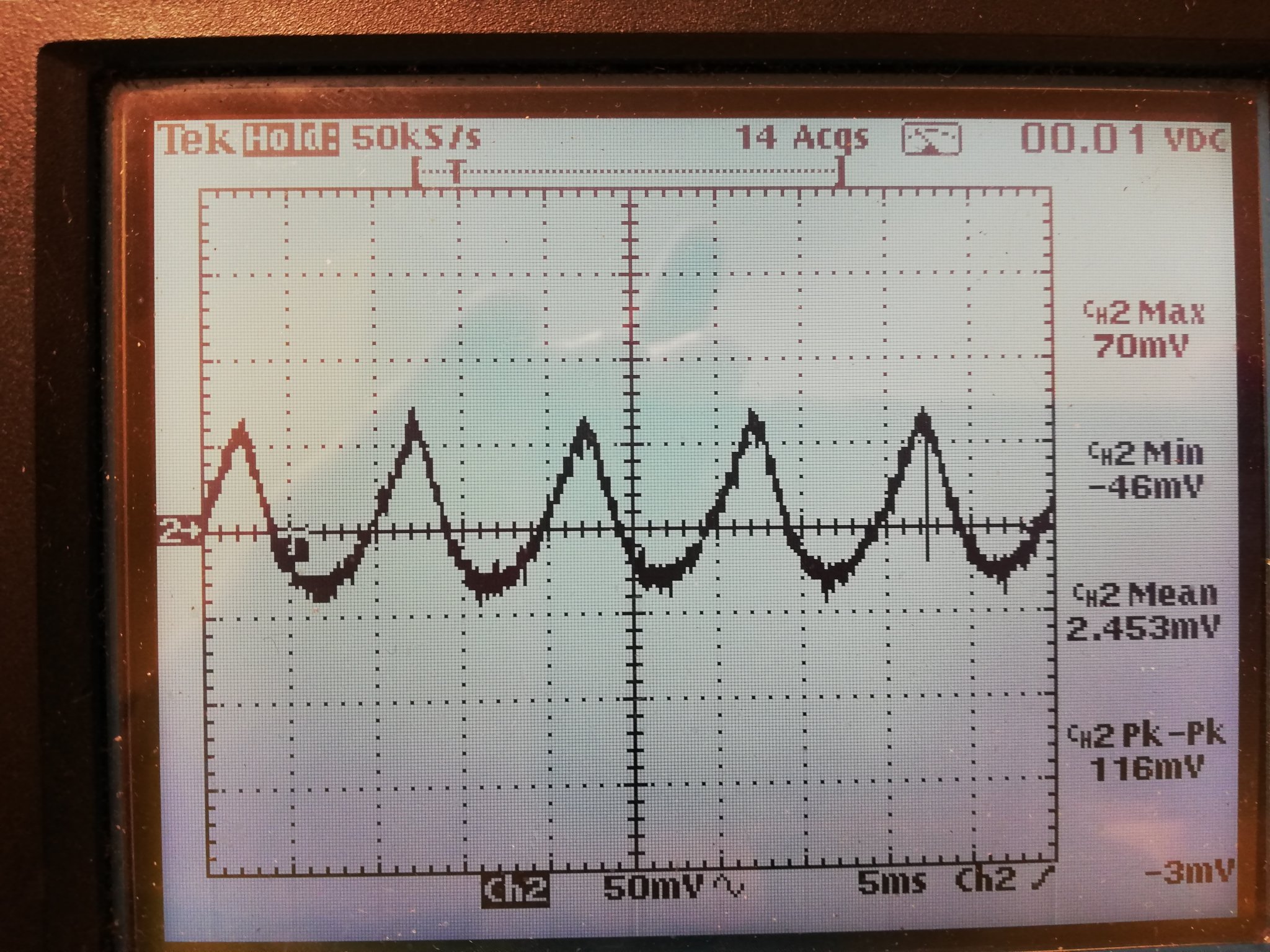

I've changed the C613 capacitor with a 100pf one and changed also diode D603. The oscillation decreased greatly! With only two channels installed from 39 Vpp has become 0,5 Vpp! Adding the other channels increases the oscillation, but with all 5 channells it is still less than 2,5 Vpp, which I assume is acceptable. See the following oscillogram (Ch1 is the voltage across the 100 ohm resitor in series with R609, Ch2 +60Vdc regulated output):

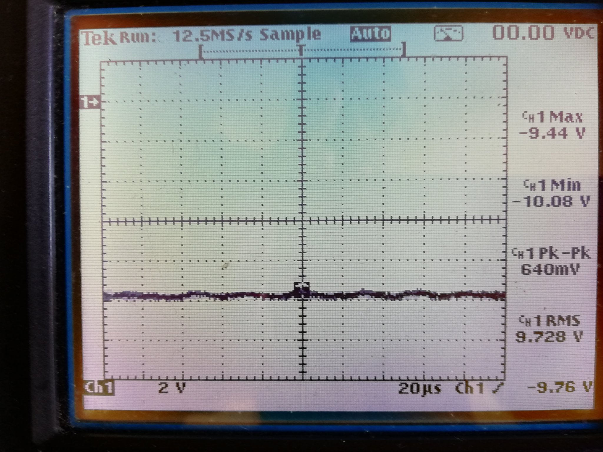

The strange thing remains that touching with a finger the heat sink of Q601 ot the cathode or D603 or the C613 capacitor, the oscillation goes nearly to 0 (lower trace):
The circuit behaves like an antenna... I'm wondering if there is something floating.

Basically you can reassemble it and enjoy the music.
But if you still have time or like to try, you can increase capacitor C613 to 220p at the same time also add another capacitor (100pf 200V ceramic capacitor) at Q603 between pin B and pin C, soldering the capacitor under the PCB pads.

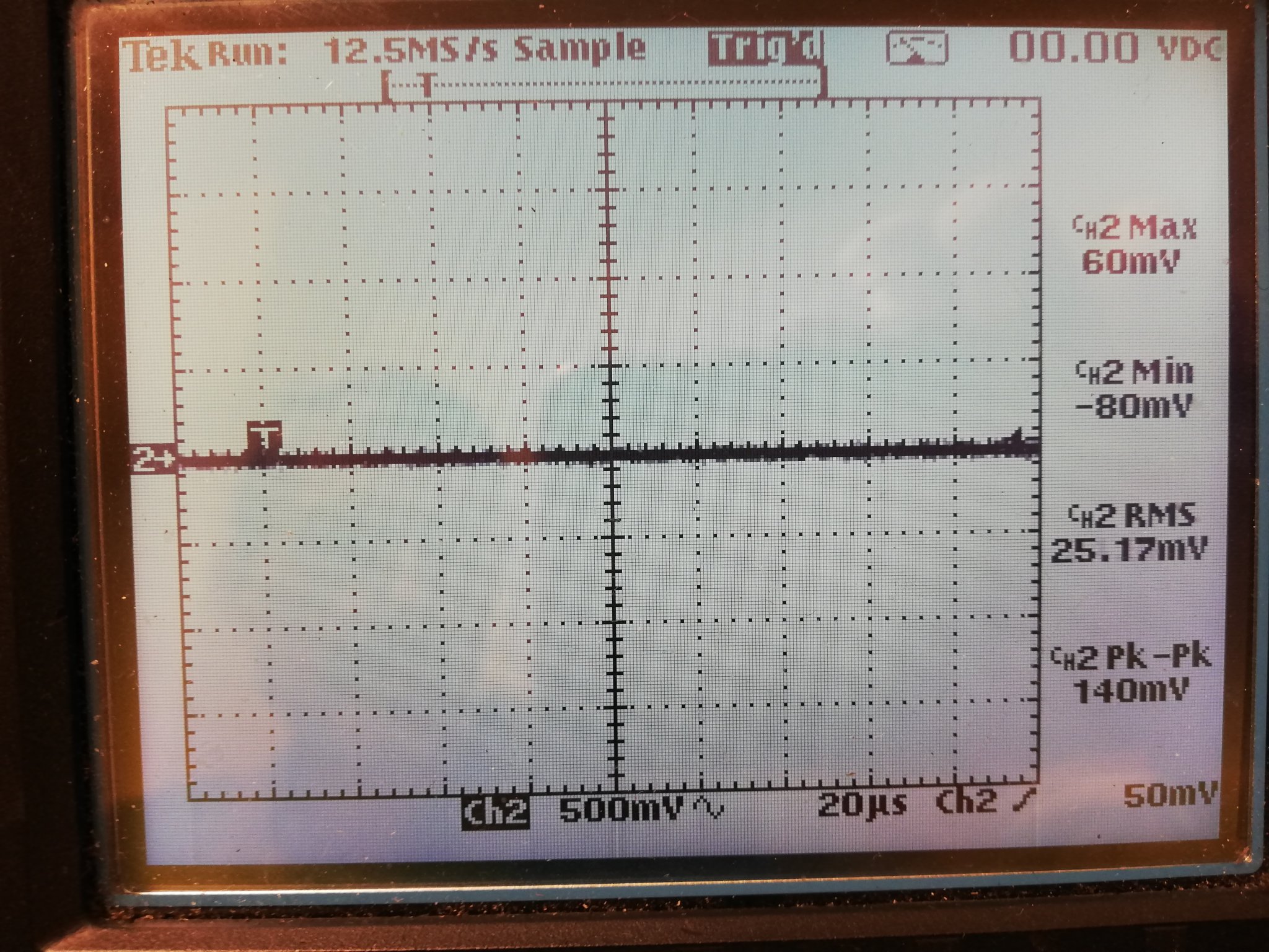

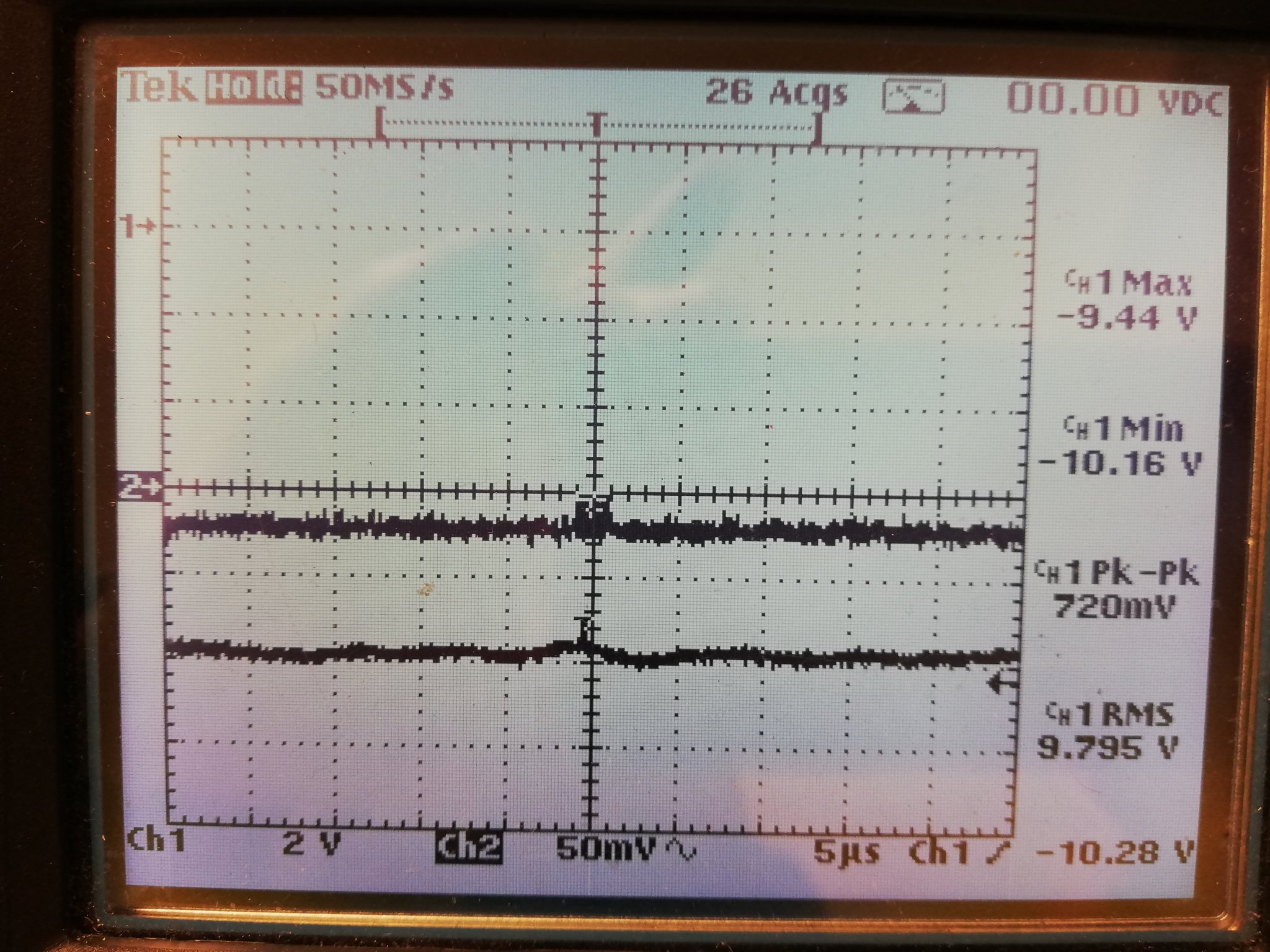

I've added a 47p capacitor between B and C of Q603 and the final result is that now the voltage across the R100 resistor is stable as when I put a finger on the dissipator of Q601:
I've reassembled the amp and started listening to music. The only concern is the high temperature of the resistors: I hope they will last over time, especially during summer time. But there isn't a way to limit the current drained by the audio channels on the +/- 60V, so this is the power that has to be dissipated either on the transistors or on the resistors.
