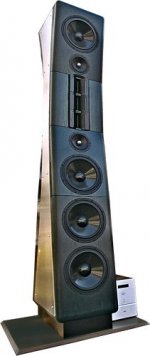

Myro AMT Heaven's Gate?
The mention of AMT caught my attention. Why you would need three of them in a vertical array is a bit hard to understand when one alone is acoustically over size in the vertical dimension. They seem to value time aligning the drivers, which is also a bit hard to understand when the D'Appolito array takes care of pointing the major lobe forward. Perhaps a German speaking person could help explain a few aspects.

Regarding the 3 AMT drivers, my guess why 3 are used.
First:
I`m pretty sure not all the AMTs run in parallel in the same frequency range. Only the center AMT will do the high frequency range (on the Myro website they only say the 3 AMTs are "driven different").
Second:
This is supposed to be a phase-linear speaker design (they claim to do square-waves pretty good).
So there must have been some sort of low order (6dB?) crossovers implemented.
With the usual crossover frequency for an AMT of around 1,3khz this would be hardly feasible in particular for a speaker that should
not distort when it`s getting loud - and I guess this speaker is supposed to do impressive (and clean) sound levels.
Neither would a gentle crossover slope at a relatively high crossover point be a good choice with those SEAS midranges with magnesium cones due to cone break-up resonances.
Hence the 2 additional AMTs around the center one are probably only there to increase diaphragm area and to be able to lower the crossover point while getting away with low(er)-order crossovers at the same time.
Look at this as one BIG AMT where only the center section emits the high frequency range.
