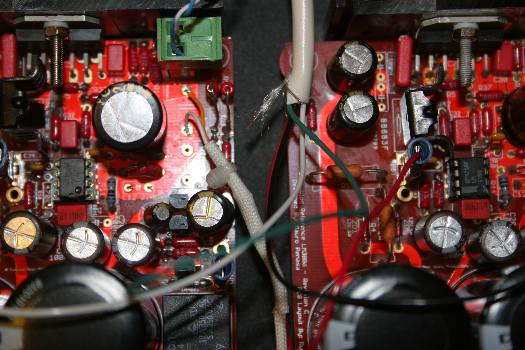

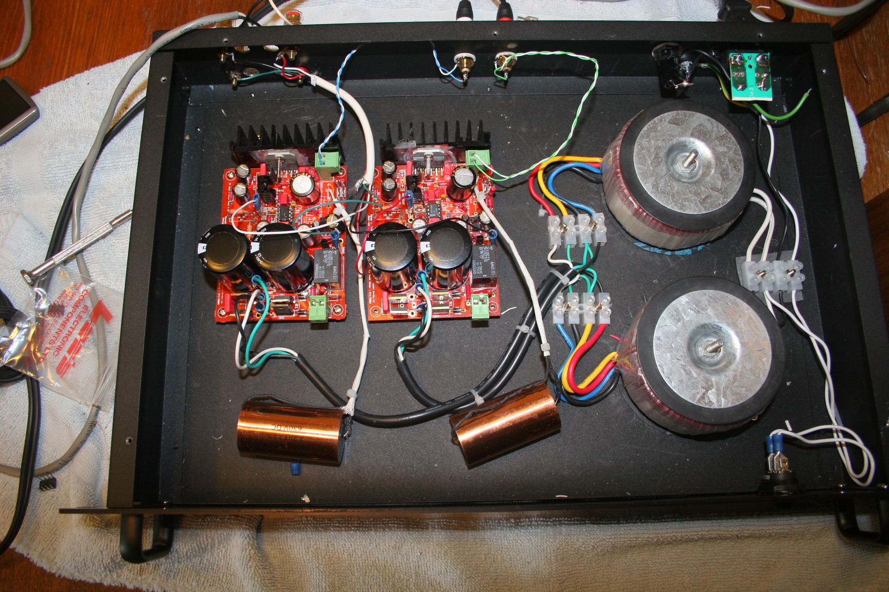

Ok lets get back to this lm318 I seem to be having. The last picture shows the two lm318. Board on the left is with the ic that works the one on the right is the new one which matches the one that came with the package. The board on the right will just click on and off. If I swap the two ic's around the one on the left will now start to click on and off. Each board will power up one at a time if I only use the ic from the left hand board in picture 3.
Which is telling me that the new lm318 I got is also bad? So I bought 5 and all the new ones are bad? I doubt it, but have been wrong before 🙂 Now it is hard to read the package on the left hand board but they are distinctively different in there markings. Are thes two different manufactures in here. Please Uriah send me one that looks like the left hand one 🙂

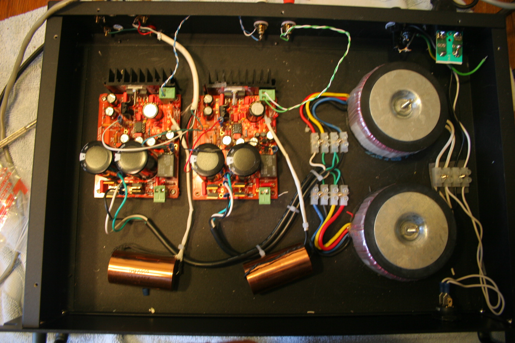

Also every one seems to think the sinks maybe too small if thats the case I'll get different ones But for now I may just put some fans on them.
sabre66-
Please take as advice only and not criticism.
1. put the Obigatos on the other side of the PCB's. (Heat sink side)
2. rotate the two PCB's 90 degrees counter-clockwise and mount the LM3886's (insulated!) on the side wall with an aluminum heat spreader between the wall and the chips. That will be sufficient for cooling.
As for the 318 issue, are you able to hear music from each board when the "good" 318 is installed in them? Not just relay clicks but undistorted music? (provided that is what is playing and not an audio book or something)

Thanks for your reply will get done right away, but I dont understand the heat spreader thing. Some photos I've seen are what look like aluminum U bar if thats all It is thats simple enough. Or I'll mount the chips to copper like in Peter Daniels Patek
Yes I am able to hear music when the "good" 318 is installed in each of the boards.
I can't see R39- 470K in the left board but is there on the right. Correct? Don't know if that explains the issue though.

R39 is on the bottom I had to pull it off it was easier to solder back on the under-side. The issue follows the lm318.
