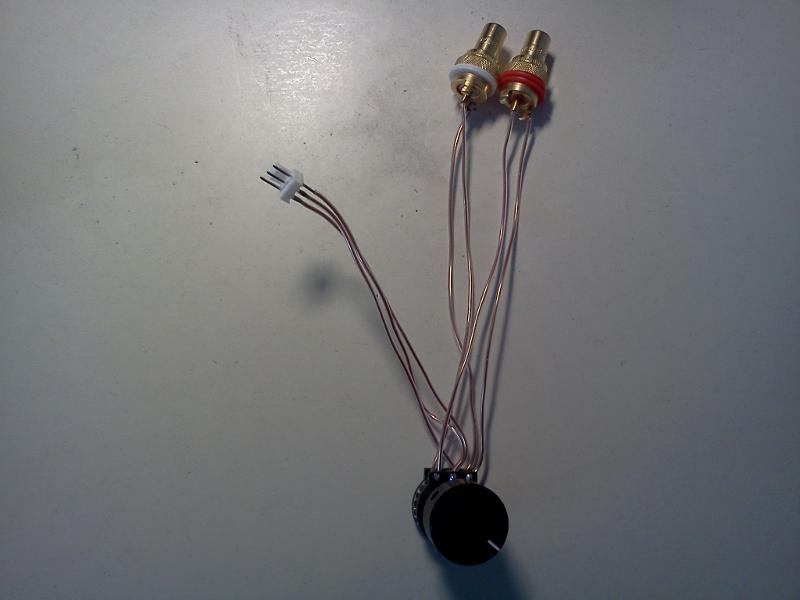

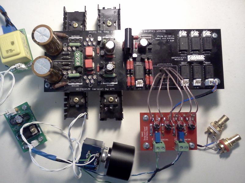

Hi Bob,
they're not combined, they're alternative setup!
DCB1+LightSpeed
OR
Stepped attenuator alone
What I'm sayng is that the attenuator sounds better than DCB1+LS, IMHO
Now I can't compare anymore since both the LS and the smd attenuator are broken... (static discharge for the LS and too much soldering/desoldering for the attenuator...)

Buffering the LED/LDR attenuator whilst not buffering the stepped attenuator is not comparing like for like.
There are 4 arrangements to compare.
1.) Stepped attenuator alone, determine the attenuator impedance/resistance that gives best sound at your normal listening volume.
2.) LED/LDR attenuator alone. Again determine the control currents into the LEDs for best sound quality at your normal listening volume.
3.) buffered stepped attenuator.
4.) buffered LED/LDR attenuator.
Comparing only 2 of these options and not optimising any of them to suit the MyRef input impedance and required source impedance, proves nothing other than a waste of time and typing.
OK. So how should I proceed then?
First it was claimed that I didn't need a buffer, using the 10K pot Penasa recommended, as the LM318 was acting as a buffer.
Then it was said that's not the case, and I do need buffer.
Then I thought, maybe the LDR attenuator could be used directly, as the LDR attenuator seen by the MyRefC would be just one fixed resistance.
How do you suggest I should determine the LDR control currents for that setup? Using the constant current source version?
