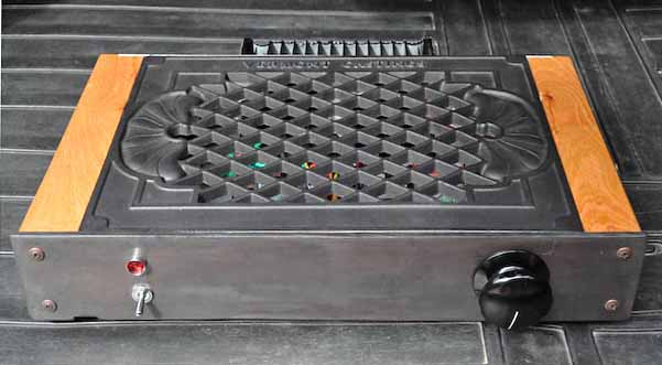

Finally finished my build of the My RefC. here are a few pictures.
Very pleased with the sound after quite a few hours listening.
Sounds much better with a nice looking volume knob (just kidding).
Thanks all.

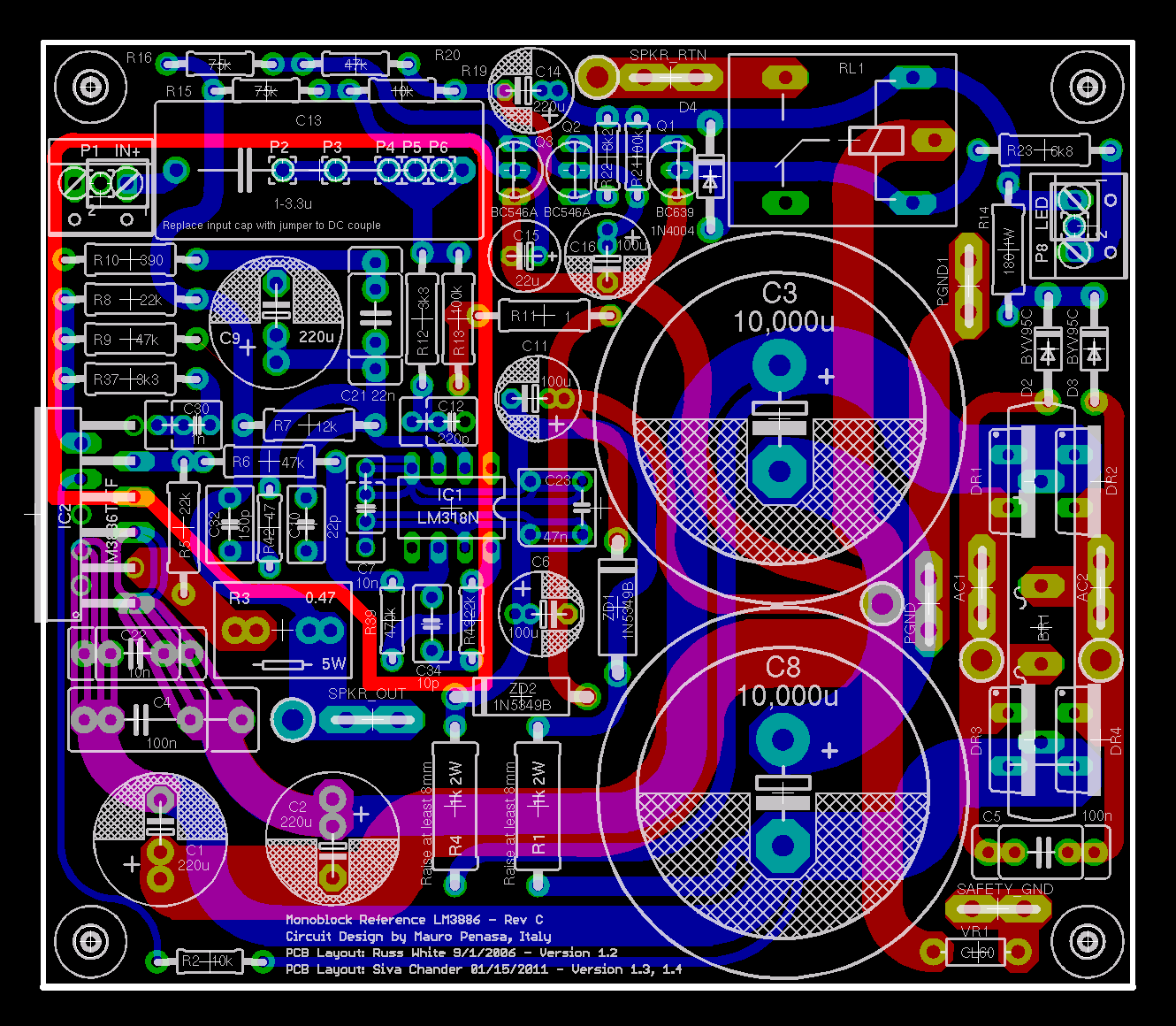

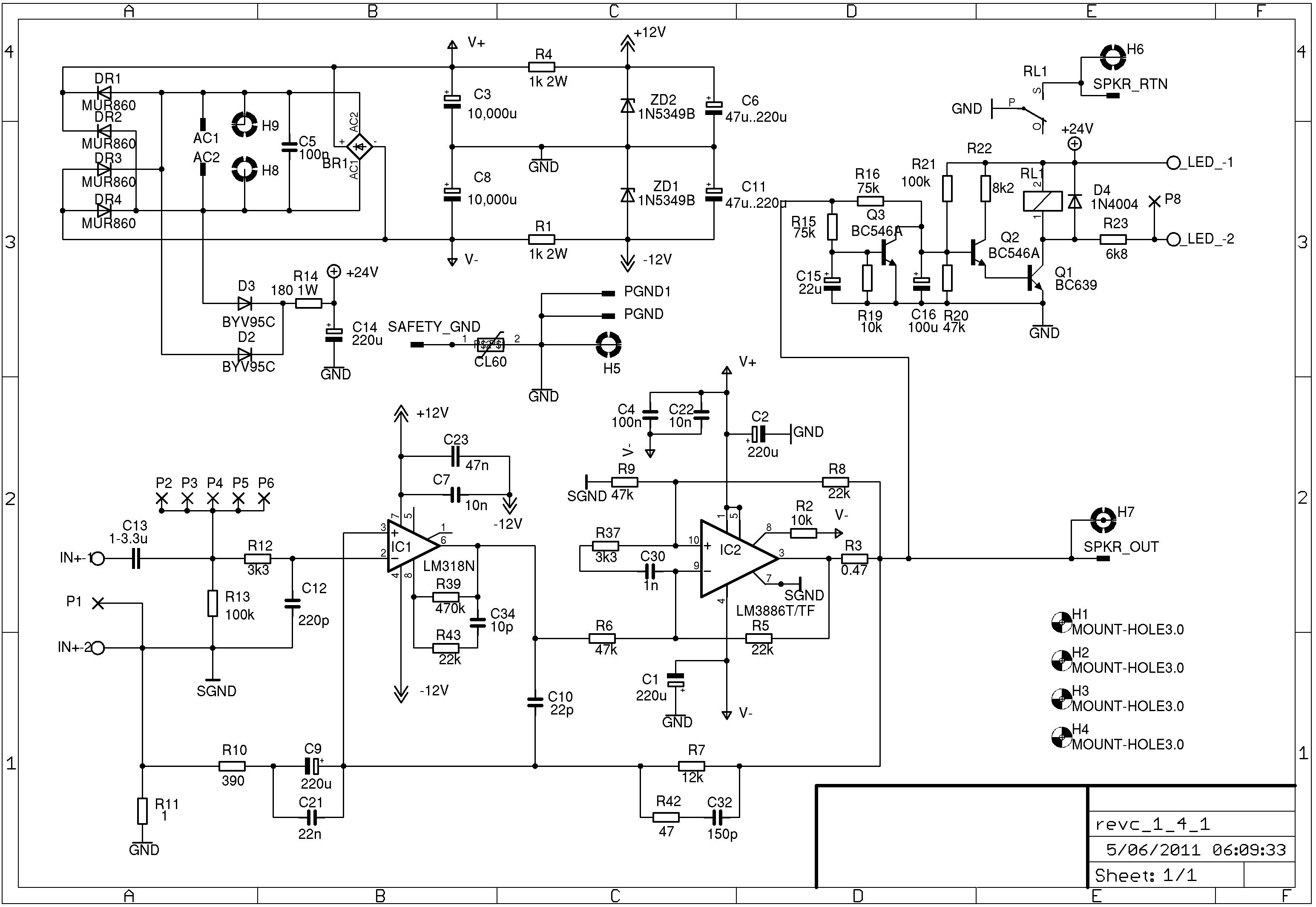

Here's my current shipping version (1.4.1, or simply 1.4) RevC schematic and layout, for easy reference.
The schematic is functionally equivalent to the original Mauro and Russ White Twisted Pear RevC Version.1.0 to 1.2 schematics, with a few minor differences:
1) C17, C18, C19, C20 found on Version 1.2 have been deleted.
2) C22 and C23 have been added - they're optional, to allow more flexibility in capacitor dimensions.
3) Various component values have been updated to conform more closely to the typical values in current use.
4) R37-C30 and R42-C32 have been swapped to facilitate more compact placement and routing on the PCB.
5) The (optional) CL60 isolator has been added.
6) P2 to P6 are additional drill holes for the input coupling capacitor C13.
7) Some nets/connectors have been renamed with more descriptive names: 0V is now SGND (Signal Ground), OUT is SPKR_OUT, and OGND is SPKR_RTN.
All the component designations from Version 1.2 have been retained exactly. The board sizes of Version 1.3 & 1.4 are identical, and both are larger than Version 1.2 (as mentioned in earlier postings). However, the location of IC2 may have shifted slightly on the layout from Version 1.3 to Version 1.4, so one may not be a drop-in replacement for the other - the heat-sink mounting location may differ slightly.

On the last set I built I left one lead of the input coupling cap long so I could "short across" the cap if the owner wanted to DC couple the amp. Is it possible to add something like a pair of PCB header pins that you could put a jumper on to DC couple the amp?
EDIT: Once again I say bravo on the layout and HUGE bravo for leaving the silkscreen with the origins of the circuit.
OK - got it. Basically, a way to short the input cap with the cap in place, which is more convenient than desoldering and jumpering it. I'll put this in the to-do list for V1.5, which may take a while to happen.
Just a "nice to have" not anything at ALL important...

Right on both counts Uriah, those are 35A rectifiers used as ground loop breakers as discussed here in this valuable and oft quoted article
Earthing (Grounding) Your Hi-Fi - Tricks and Techniques
Scroll down... for earth loop breaker circuit.
The lightspeed was offered at a discount during the group buy and the power supply with capacitance was discussed on the main thread by Regiregi (thanks Regi!) also he shows the ground loop breaker option and gives the link above.http://www.diyaudio.com/forums/group-buys/160768-myref_c-ultimate-bom-52.html#post2169865
One thing I couldn't get my head around, was whether or not I really needed one ground loop breaker per channel? I couldn't see the point of joining the ground of both channels before the ground loop breaker so I went for two breakers but I wish I understood this better...
I can cope with not understanding how the amp works, but the ground loop breakers have only three components and I can't work out how the hell they work.
About 100 hours listening to date and something is mellowing, but I couldn't honestly tell you if it is the amp or me that is mellowing out (most likely both).
I'll keep my eye's open for a more creative volume knob!
Cheers folks
Bill

Hi Bob - if the 1.5R resistor is outside the outer voltage feedback loop, it should not make a significant difference to the sonics. It will decrease the DF, which may help for some kinds of speaker loads, but at the cost of reduced output power.
If it's inside the outer voltage feedback loop (which needs some mods/cuts to the PCB), it will definitely affect sonics - but the impact is hard to predict. YMMV, but I'm guessing that it may improve phase margin, decrease the output power, and increase the THD20 (distortion) by 6-12 dB.
