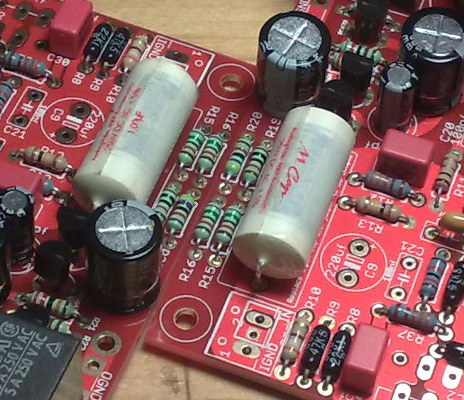

start with a small volume film cap and get the amp working and measured, particularly for hum & noise.
Then try substituting the big cap to see if performance deteriorates.
The size of the big cap and the spacing of it's leads will make it susceptible to picking up hum fields. This could be minor and acceptable. A before and after test is necessary.

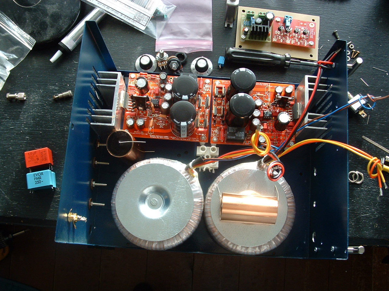

Hi I have made a mistake and not left room for the Obbligato in my case .Would there be any problems fitting them on top of transfo s or i could just fit a smaller cap like a wima onto pcbs cheers john
Hy Lucylu,
this case is too tiny and a challenge fit...
And you need space for the LSA too...
A bigger case is an option?
You can try to fit a smaller cap on the board, as Andrew suggested. A decent WIMA would probably fit there, except the Blackgate is in the way.
I would avoid mounting near the xformer.
You could be very brave and eliminate the cap completely, using a wire jumper instead. This allows passage into the amp of any DC present in the signal, and could be catastrophic.
As Tom pointed out a smaller cap could be an option but avoid a Wima, a 1uF white MCAP mounts onboard and is much better.
Also avoid mounting near the transformer not only caps but also signal wires...
I wouldn't DC couple, DC coupling is good for testing components but the MyRef sound much better with (good) coupling caps in place, particularly in the bottom end.
