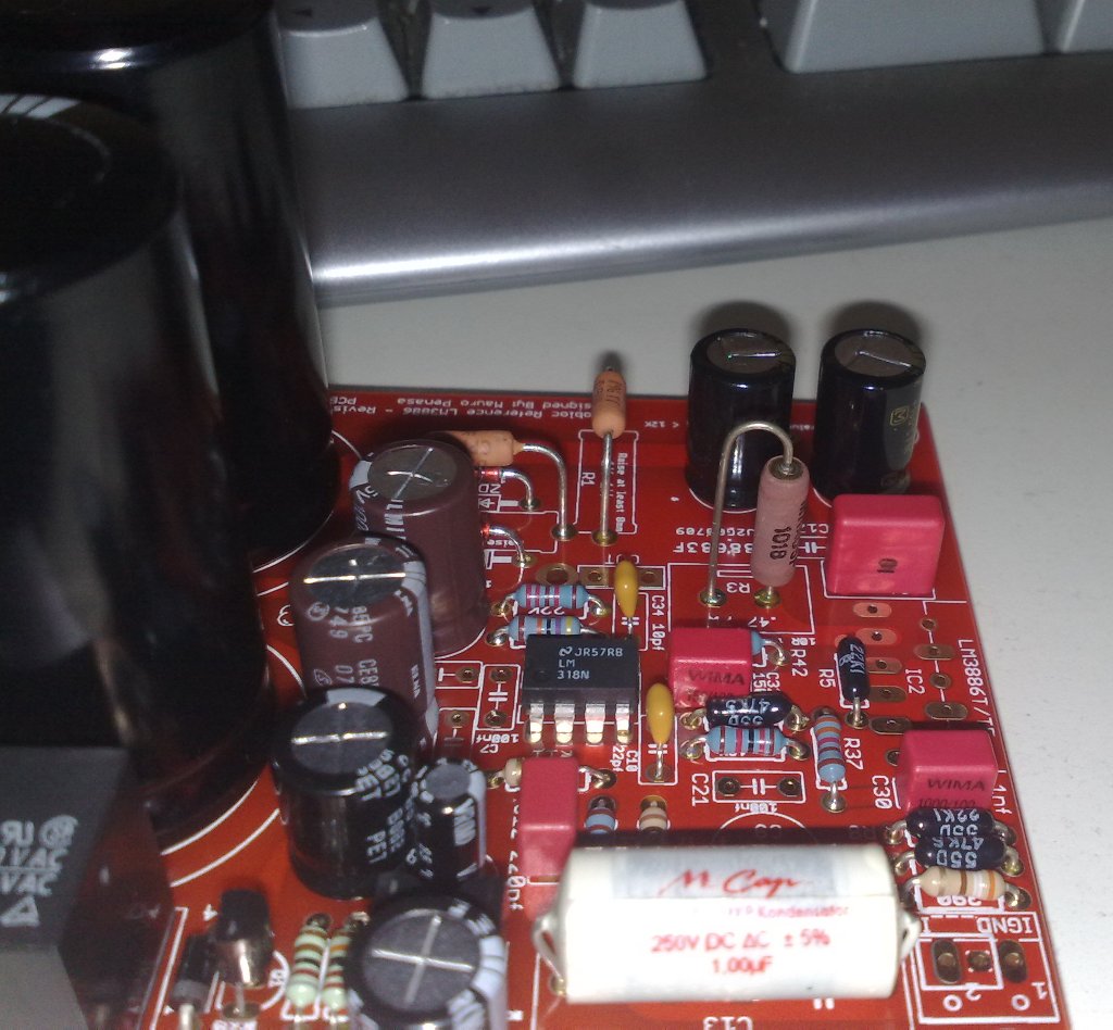

OK, I got one board assembled and powered up - it's now playing music. I'm not using the Ultimate BoM, but my own (value-oriented) BoM. I've got to say - it sounds great at first shot, without burn-in, even without the premium components. The entire speaker-protection relay circuit is omitted (I measured only 15 mV output offset, and the turn-on/turn-off pops are barely audible even without the relay).
Here's the value BoM (only relevant changes from the Ultimate BoM are listed):

The MyRefC sounds great with standard components but is some key components are changed it could be gorgeous! 😎
But in your BOM there are some problems...
C3, C8: Elna CE W 4700uF/50V (low-profile 30mm x 31mm)
These are way too little... even cheap Chinese clones of the MYRef used 6800uF ones...
If they're availables in India you could try Kendeill that are cheap but souns great
C4, C5: WIMA MKS-3 100nF/250V 7.5mm
Caps in those position have a great impact on SQ, can't you use 100nF Wima MKP4 or 10nF Wima MKP10?
C7: WIMA 330nF/50V 5mm (silver text, probably generic MKS)
Idem, a Wima MKP2 or a Evox SMR 100nF are way better
C9: Nippon Chemicon PS 180uF/16V (polymer)
I think it would be better to not change values, isn't that cap available as 220uF?

Caps in those position have a great impact on SQ, a Wima FKP2 is the best you can buy, IMHO, and it's cheap too.
C13: 4.7uF/63V polyester film, generic (subject to change)
This cap is the MOST important of all... if safe with DC it would be better to omit it
R3: 2 x 0.22R/2W Metal-Oxide, generic (connect in series)
A 5W power resistor costs only 50 cents... and is much safer!
R12: 2k7/0.5W 10% Allen-Bradley Carbon Composition
I imagine you changed this value according to the also changed C12, I wouldn't change those values...
IC1: LM318 (TI, CerDIP) - socketed 8-pin DIP
This is a MAJOR problem, Mauro Penasa stated BOLDLY that it has to be a National Semiconductor LM318 because others have a different compensation networks...
Replacing the caps with Wimas costs less than 3$, will you sacrifice a BIG difference in SQ for so little?
Regarding the power resistor and LM318 (National) you should replace it...
I'm curious about your mixed choice of carbon and metal film, what guided you? 😎
These are the only ones that are short enough for the particular case/mounting I'm thinking off. I have 6800/50 Panasonics, but they're taller - we'll see.
...Idem, a Wima MKP2 or a Evox SMR 100nF are way better
Sadly, MKP4s are very hard to find locally. The MKS3s that I used were the only ones with the 7.5mm pitch available here.
That polymer at 16V maxes out at 180 uF. I have some FMs in 220uF/50V, but those will not be sonically comparable to a Silmic II, leave alone the polymer. I can bypass it with a 47uF below the PCB, but that's not sonically advisable for a polymer.
I'll short it, check the DC offset and proceed accordingly.
I can't find the vertical mounting 5W type in that value locally - so I went with a quick and dirty alternative.
Solving for I(rms): I(rms) = sqrt(4W / 0.44 ohms) = sqrt(9) = 3A => Ipeak = 4.2A => Vpeak into 8 ohms > 32V. My rails are 32V, so this is adequate even at peak power.
But the TI CERDIP sounds good enough, in fact great. OK, I'll go and look for the Natsemi ones, which are about half the price locally.
I kept the metal films for all the accurate ratios, including the Howland and the GNFB loop. The remaining stuff was guided by whatever I had in hand, with carbon films being used in locations where the tolerance is not critical. I kept the Allen Bradley for R12 because I wanted a non-inductive resistor there to avoid having an LC pole with either C12 or C13 - this has caused problems of metallic resonance in past designs. R13 should be metal film, but I only had a carbon film in hand - I'll fix this later, but it appears to have no audible impact.
Use a normal 5W ceramic power resistor and bend leads... or a Mills if available cheaply...
See the attached photo (it's the not yet finished cheapo version for surround channels...)
Interesting, why don't simply use a carbon film? Their inductance should be pretty low.
Regarding R13 it's better a carbon film (and so for R11 and R10, IMHO), so it's good like you did.
If you look at the photo you'll find that in those positions I've used normal carbon film resistors too... 😉
