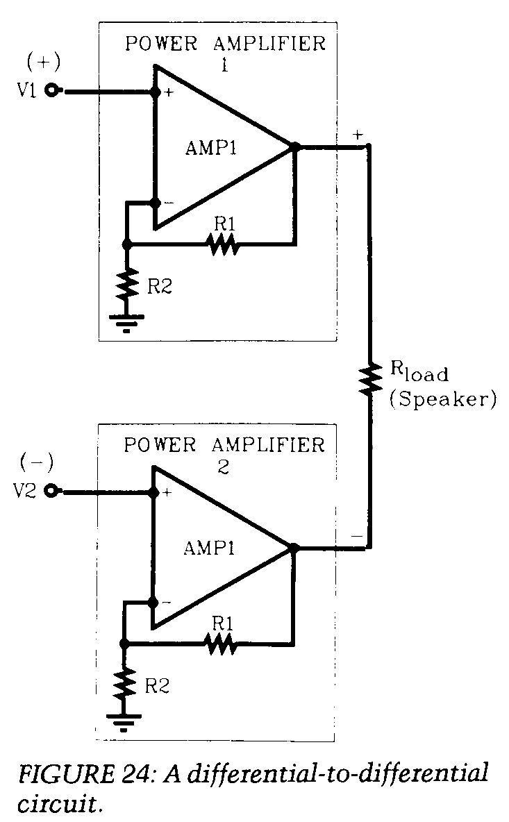

A bridged topology is different from a parallel Howland. In a bridged configuration, each chipamp is driven 180 degrees antiphase, while in a parallel Howland, both are driven in-phase.
A bridged MyRef is somewhat more complicated - it will require an additional LM318 to drive the second chipamp antiphase to the first. This LM318 has to have its own complete GNFB loop, along with all compensation elements, with adjustments to take care of the phase reversal on one half of the bridge.
I don't see why a proper differential drive for the MyRef might be more complicated, except for the additional parts BEFORE the amp?
Forgive my innocence, but why wouldn't it work as a bridge?
What I mean is a differential driver, properly designed and using 0.1% resistors (which are now easy to find or hand select from 1% types).
The only problem I foresee is on the total power, which on a bridge should be 4 times its 8 ohm output. Dissipation should be critical and I'm not sure how the Spike protection may act.
I also do not understand the concern for the GFNB loop in the negative side of the signal. What causes the phase reversal is the previous differential stage, and it already goes in anti-phase when it's fed to the 318 and the amp.
My guess is you are thinking of the bridge National proposes on the Application Notes, which I don't think should be used for bridging purposes.
Take the "Jeff Rowland approach" on his power amp using parallel/bridged 3886s. On the first version he used a transformer and on the second a differential chip to feed the phase/antiphase signals. The amp stages are exactly the same.

It probably can be done with an additional phase-splitting stage before the LM318s. It might also require DC-coupling to the LM318s, so it will require some care with the offsets or a DC servo somewhere - either at the LM318 input, or at the phase-splitting stage input.
It's possible, but is the additional power really needed? It will definitely need 2 LM3886s on each side of the bridge, or 4 in total for each channel. For stereo, that will be 8 x LM3886. That's a lot of additional complexity for a topology that's already adequately powered for 8-ohm loads (Where I live, 40W is *way* more than necessary to get the neighbours to complain).
DC offsets concerns are not more complicated on a differential layout as they are on an unbalanced one. No need to have a DC servo to handle anything, which would be tricky on the MyRef. The amp already has a 220uF blocking capacitor on the feedback, and that should be enough.
Whether the extra power is needed or not, that's for every one to answer. You just need two 3886 per channel, not four. I am not paralleling two more chips. 40watts is fine for small non-hungry speakers, but probably not for 10" or 12" subs, which some might be considering using.
............is the additional power really needed? It will definitely need 2 LM3886s on each side of the bridge, or 4 in total for each channel. For stereo, that will be 8 x LM3886. That's a lot of additional complexity for a topology that's .................
Carl,...............Whether the extra power is needed or not, that's for every one to answer. You just need two 3886 per channel, not four. I am not paralleling two more chips.

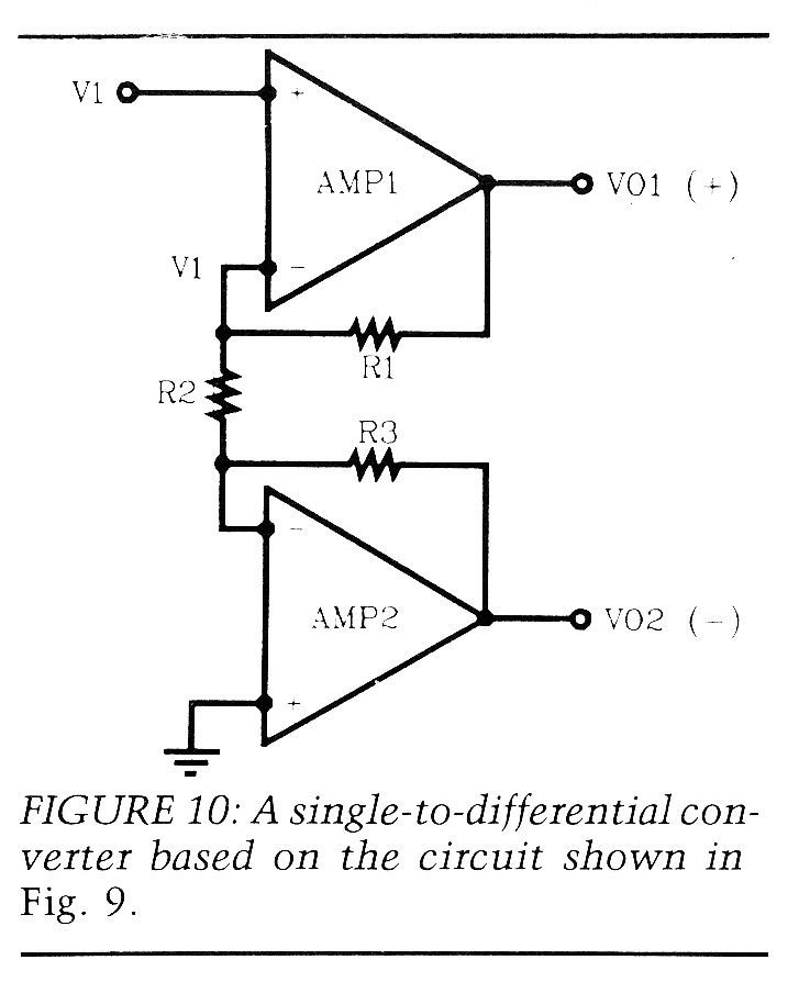

Post52, fig10.
Can anyone confirm for me what the gain of the single ended to differential pair is?
i.e. 1Vac single ended input gives ?? Vac differential output.
I am thinking Voutdiff = Vin * [R1+R3] / R2 ????
If 2k0 were chosen for all three resistors is that a gain of 2times (+6dB)?
Since each opamp is operating at effectively unity gain do both opamps need to be unity gain stable?
