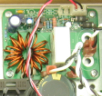

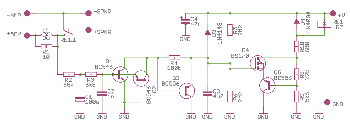

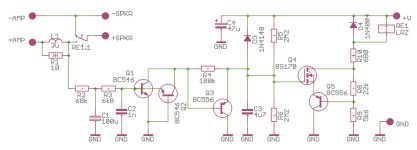

The final piece of my build is the DC protection. As mentioned above, I am reusing some extra boards I designed for another project - they are the two green boards in the photo above. The schematic was lifted from an early Cambridge Audio amplifier, nothing fancy, but it works really well:
C1 C2 R2 R3 is the input LPF, Q1 Q2 is the DC detector, Q3 discharges C3 when DC is detected. The voltage at C3 is monitored by the Schmitt trigger Q4 Q5. R8 R9 set the switching threshold and provide positive feedback for hysteresis and faster switching. The relay I used is Amplimo LRZ.
Although Mauro did not use an output filter, my protection board includes one, with an air core toroidal inductor. I wound one with parasitic turn compensation, similar to that used in the Omicron, but with 16AWG wire.
