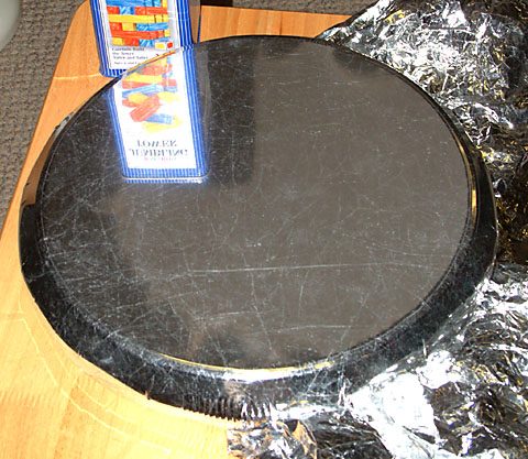

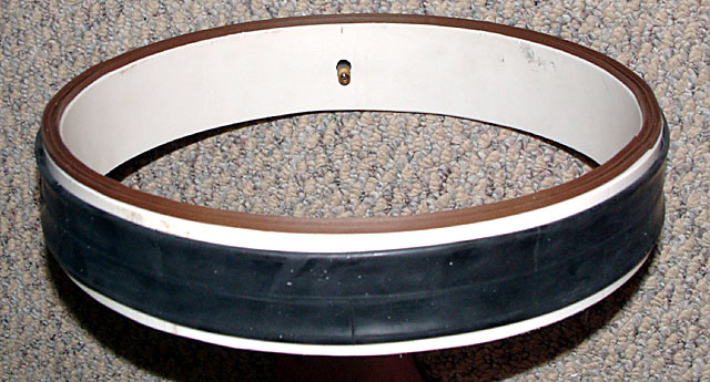

First attempt
I made a 12" diameter round stretcher from a piece of PVC pipe. I cut the ends as close to square as I could (very close, actually), drilled a hole for a bicycle tire tube valve, stretched a 12" tire tube over the pipe, and attached some double-stick tape to the inside edge of the pipe. I also added some foam weather strip tape to the edge of the pipe.
Next I laid some film out on a flat surface, put the stretcher down on it, weather strip side down, and wrapped the film over the frame and stuck it to the double-stick tape all the way around the frame. I connected an air pump and gave it a little air and Voila! A perfectly stretched mirror!
The plan is to transfer the film from this stretcher to another piece of pipe that has a lathe cut square edge- I will put contact cement on the pipe and on the film and put the two together. Then cut the film free of the stretcher.
Thanks to Moray James for the film samples!
Here's a picture...
I_F
Here's a picture...
I_F
