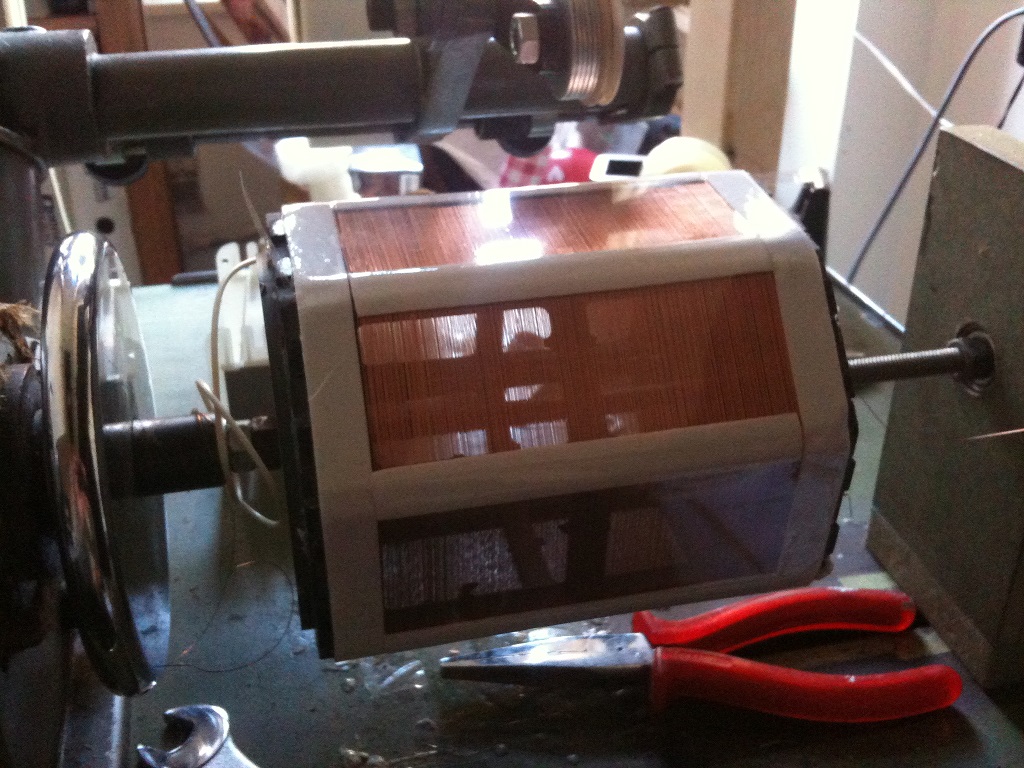

well i finished one of these round stators as menbrame i took some present wrapping 🙂 verry thick but it whas the only stuff that shrunk. and i wanted to see if i could do it if i had the correct foil. and apprantly yes. it is now playing in the living room. crossed at 1 Khz , for the next one i want to make the cilinder a tiny bit bigger so i can squeeze some more menbrame in there, so the angle will decrease. it weird to have highs al around the room wherever i sit. i put some rockwool in the cylinder and some felt on the front. i thought it would not be a good idea to close the top and bottom of the cylinder, but after measurements it has the best results in distortion and in low frequency responce. next time i will ad a tiny dot of silicone to increase stability of the menbrame so i can increase the bias to gain some more sensitivity. for now i hope thinner foil will give me some increase in sens.
it has some suck out or cancelation around the 10Khz if i decrease angles this will be less. as for hearing its almost not noticable at listening position. i wonder how it sounds with 2 of these.
the thing is tiny thats what i like, 12 cm in diameter and 13 cm tall. small enough to sit on small loudspeaker cabinet

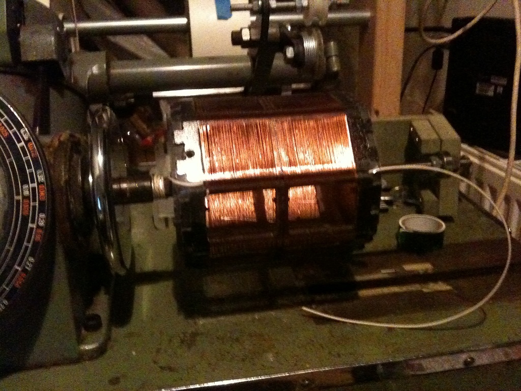

well the funny thing is i tried it once 8 years ago, and that was a failure 🙂 still wanted to do it once more. since i have a cnc right now, its makes things easier. i made a cicle with 8 corners, and made 8 stators that slip into slots on the circle, to create this lantern form. i then put it on a transformer winding machine, and dialled it in to have a pitch of 1 .3 times the wire thicknes. (its really small wire 0.2-0.3 mm or so) since its magnet wire there is some for of insulation, apparantly enough dont had wire failure so far.
the picture is after aplying the shrink foil that i had at hand. nicly shrinked and all. next step was adding the second spacers. i wanted to use the foam tape again but this ofcourse failed. because the wire is under tension while winding it compressed the foam underneith it, so i ahd to cut small spacers from PVC and glue them on top of exsisting foam spacers that support the mylar. i then again winded the second stator on top of that. the windong is the nice part 🙂, it took 280 turns in total around 88 meters of wire for on stator so this thing holds 160 meters of wire.
