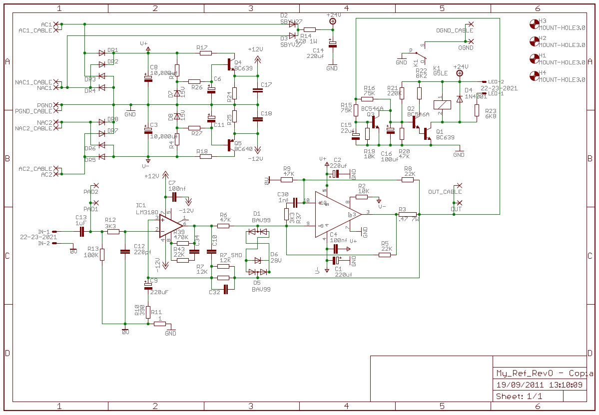

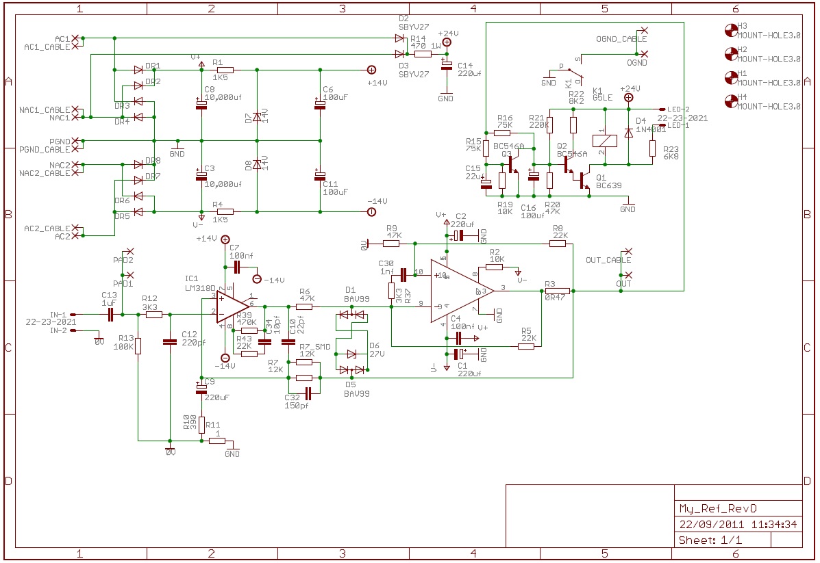

D3 doesn't work !
Downside of using 2 bridges.
Hi Rudy,
do you mean that D3 should be connected to NAC1, right?
Take a look on the updated schematic, now it should work...
Thanks 🙂

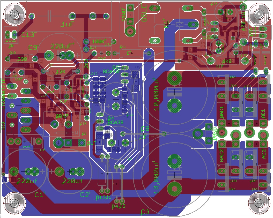

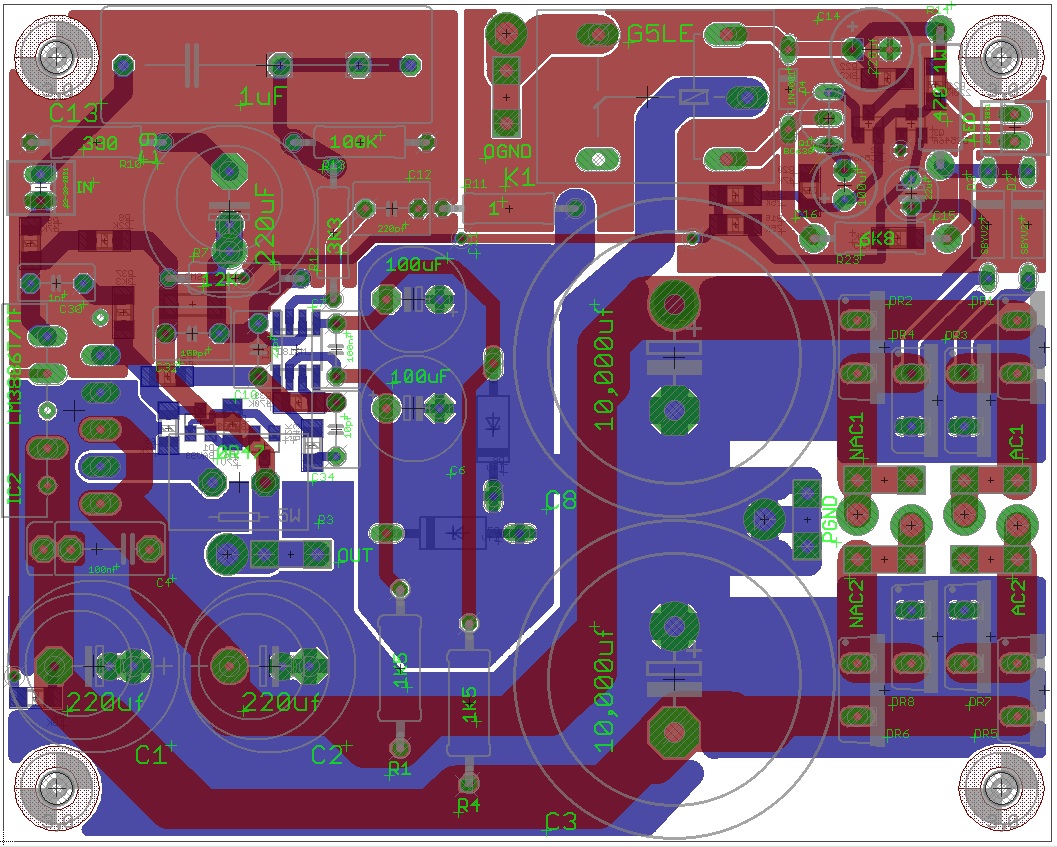

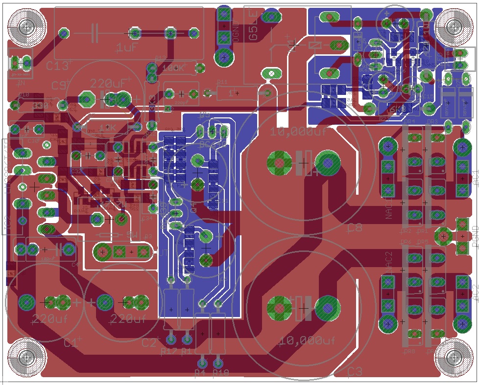

Soongsc, is it any better now?
Is this a double sided board? What do the blue and different shades of red represent?
Yes, Soongsc, it's a doule sided board.
Red is the component side, blue the solder side.
Red is transparent so the darker red represents a trace in the bottom layer.

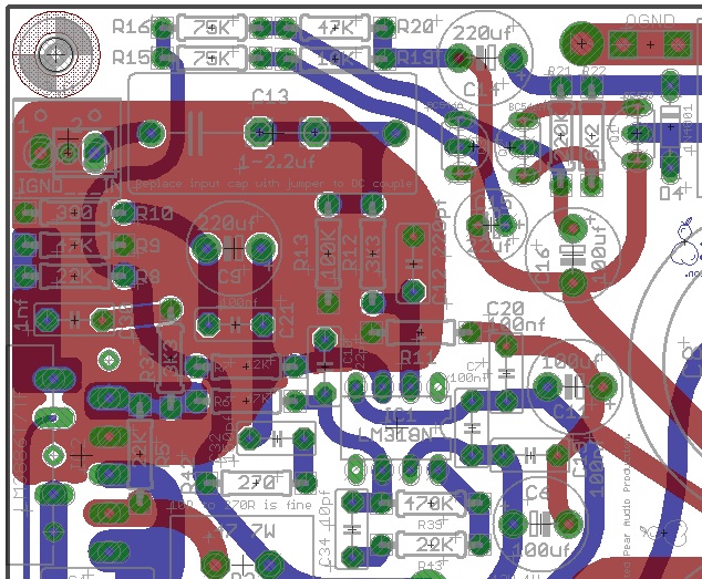

In the meanwhile I've updated the PCB
It's going to take a while to trace the schematic though the PCB.

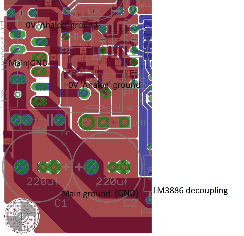

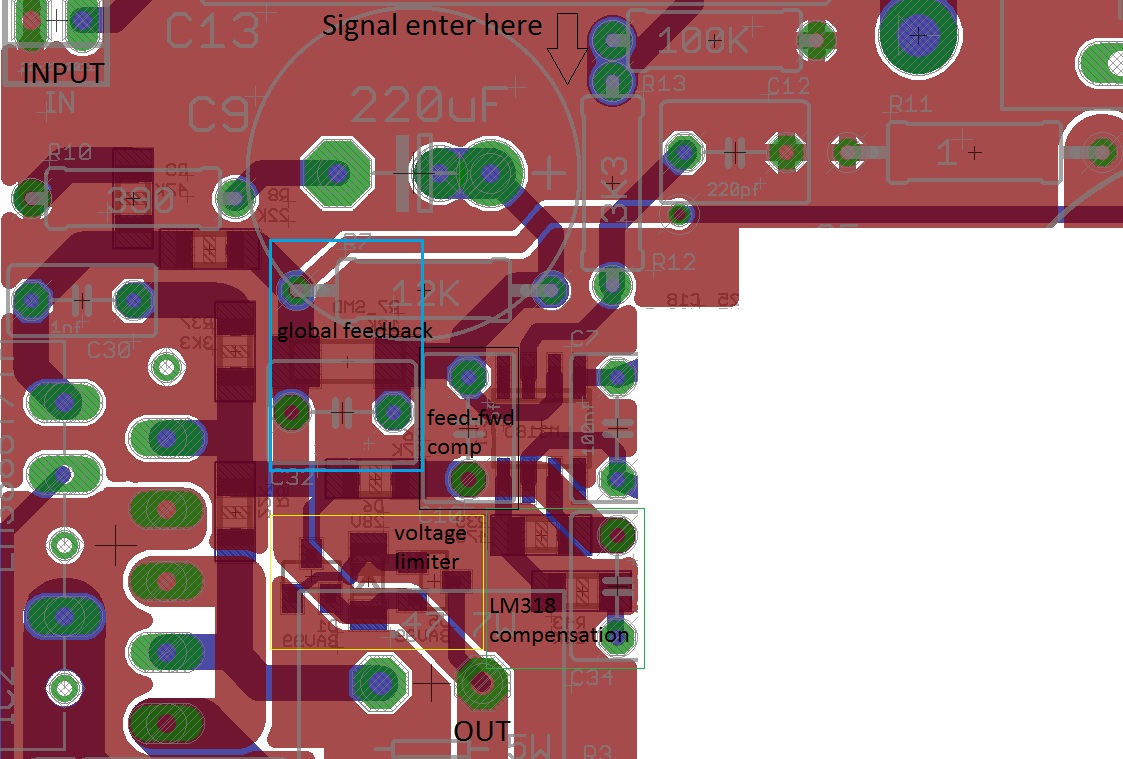

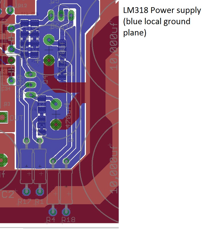

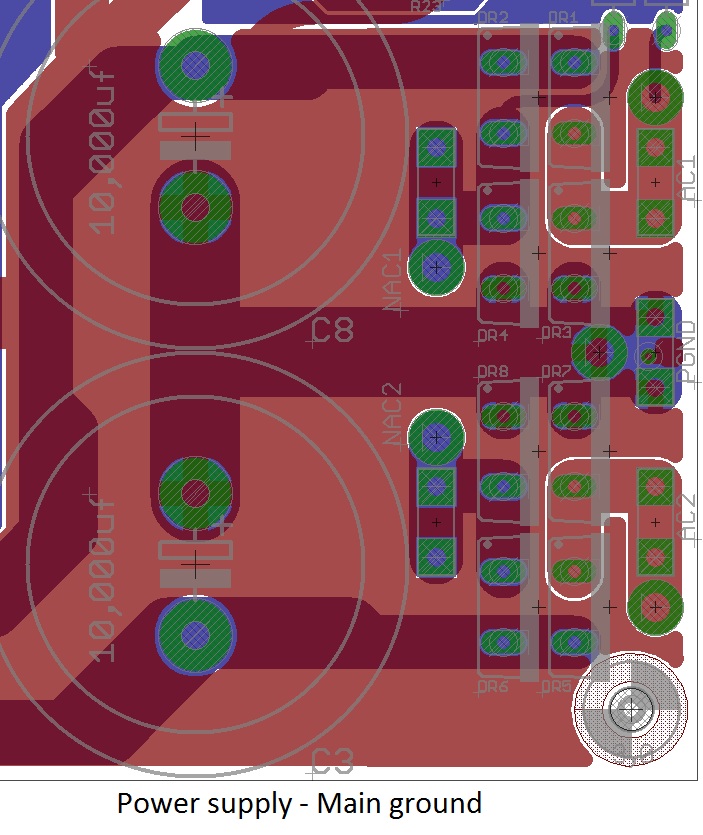

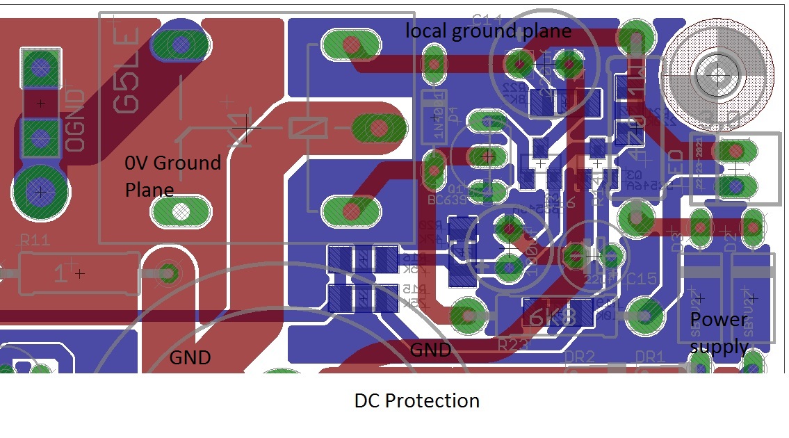

Yes, it's not so easy... I've attached some pics to help.

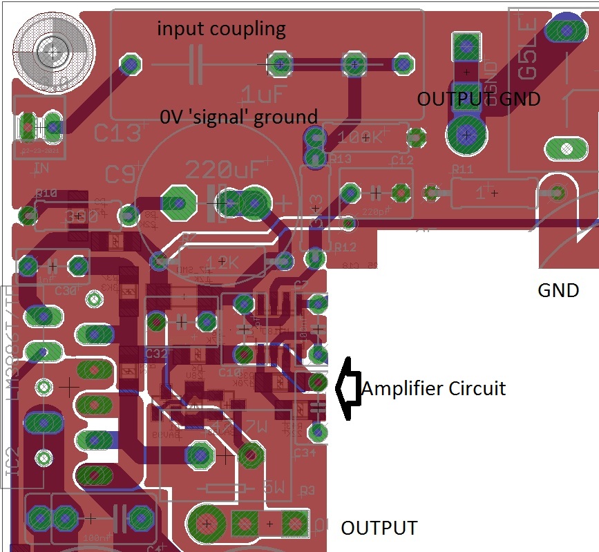

The way you have the ground plane laid out is going to complicate things. Remember the old Rev C does not have a ground plane like that for a good reason. The circuits have less unaccounted capacitance in the signal path. I would only use this kind of ground for power voltage distribution. All the EMI shielding should be done using the chassis.
The amp output ground seems really close to the input ground. Not a good idea because that ground is still a high current point and it's going to effect the input. Unless you have done some analysis, and determine that is what you really want, generally, I would avoid it. It might be interesting to do some experiments though to see how if effects measurements and sound.

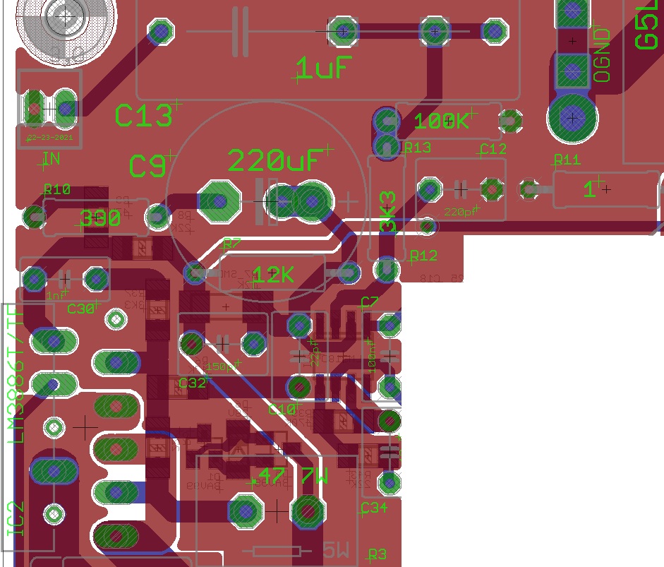

I'll continue to look through the amp section first, but those gray component markings really make it hard to read.

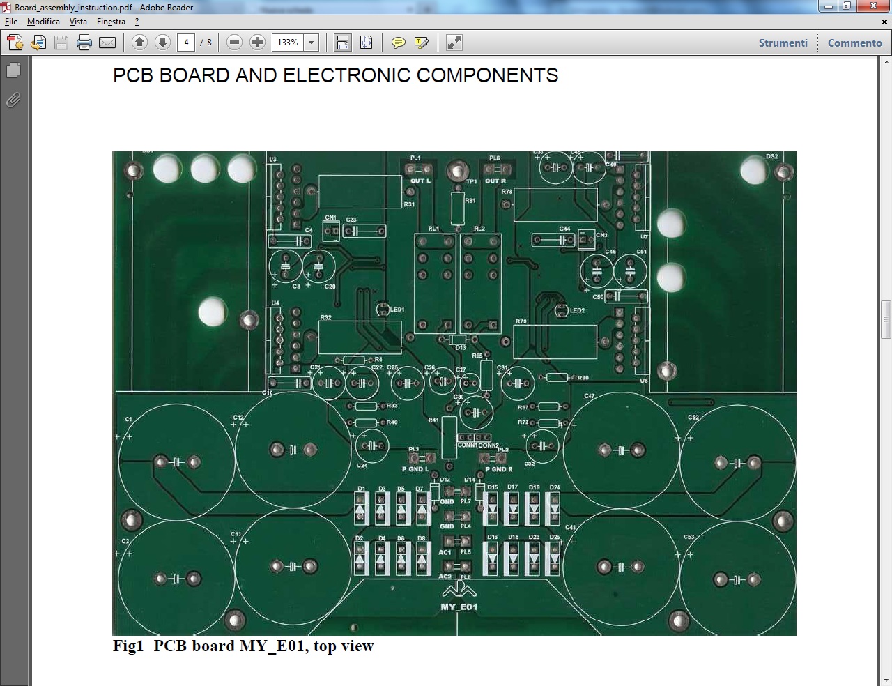

I've taken inspiration from the MY_EVO (Evolution) PCB, I've attached the only officially available pic (from the assembly manual).
Obiously it's possible that my version is wrong...😀
Yes but the TP RevC PCB is not much different in that regard...only 2 cm more distant.
I'll try to gain distance.
Maybe I can avoid the overlap of the 0V plane (signal ground) with OGND trace, it can help?

I've attached a new version of the amp detail with green component marking, I hope it will help you.

I'm looking at the old Rev C and wondering how the output ground is connected. Is it an interchannel connection? The RevO output ground, almost looks like it's connected to 0V ground, I may be reading it wrong. But the location seems too close to the input components.
I wonder how the Evolution listening impressions are compared to Rev C with the new layout.
The output ground is connected by the relay to starground
No, like the RevC the output ground is connected by the relay to starground.
In the My_Evo Mauro choose a more traditional approach and the output is controlled by the relay, output ground is directly connected to the star ground.

One thing I wonder is that if the power traces are on the opposite side of the power ground, if the traces are wide, then there will be more capacitance, will this improve power supply high frequency performance?
This looks like an exciting layout. You are so fast I have trouble keeping up.
Thanks Soongsc.
Since in these days I'm at home from work I'm dedicanting much of the day to this project.
Sadly I don't have a solid technical background so while I find and read documents on PCB design I try to apply what I learn.
If I've understood correctly, the return current, if a ground plane is available, tends to follows, in the opposite direction, the same path of the supply/signal tracks.
So the ground plane can follow the same path of the supply tracks and being wider at the same time it gives some shielding.
In addition added capacitance seems to be benificial as lower impedance.
The only thing I can say for sure is that this sort of power supply routing is not new, the My_EVO use the same concept and also the QRP02 of Peranders uses a similar routing.

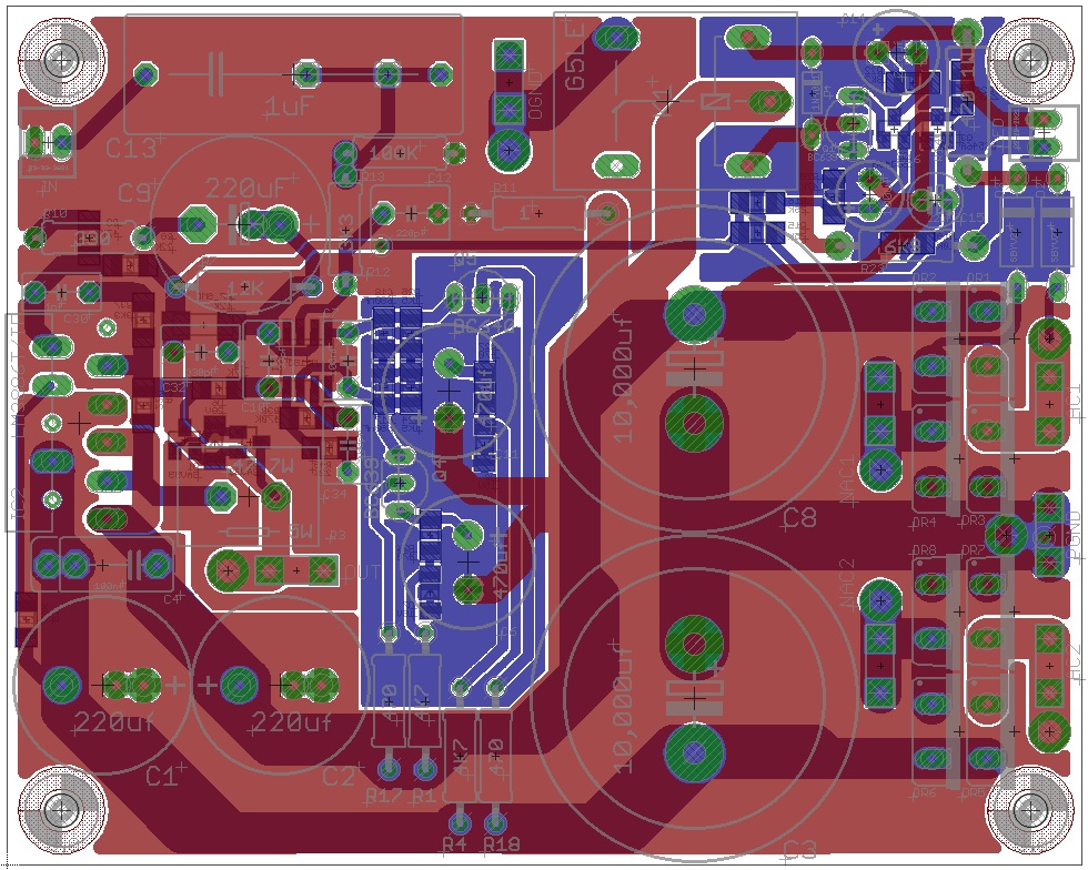

I've revised both PCB and schematic.
Until a find a suitable (and simple) power supply which sounds better than plain zeners I'll keep the latters in schematic.
I've modified grounding:
- now the 0V signal reference is linked to the LM318 PS ground plane to optimize return currents
- the LM318, his compensation network and input and output traces are no more on the 0V groundplane
- Incresed distance from adiacents planes on the same side to reduce stary capacitance.
