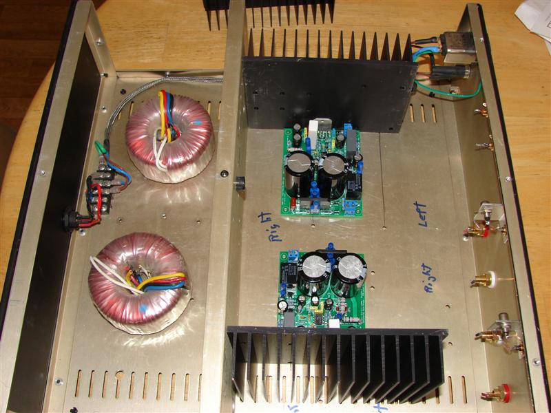

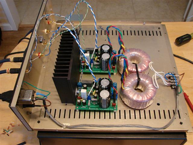

Couple of notes from last nights assembly:
Getting the small Yellow caps to "look" square on the brds is a PITA. VERY minor but still...
I used one of the screw terminals as a height gauge for the raised resistors. I turned it on it's back and touched the solder pin to the cap and rested the resistor on top. That gave me a "level" resistor to solder in.
I was going to put in IC sockets to change the opamp but then decided against it since this is a PROVEN design and it is designed around this opamp so it should never be changed unless it is damaged.
I had a scare moment when I "thought" I installed a resistor backwards... (JOKE!!!!!)
I cleaned the brds after the resistors and tiny caps. Then again after the regular caps and fastons. And finally after completion. I couldn't imagine waiting and trying a single cleaning after installing ALL the components.
Toroids are Steve Dunlap 160VA 24-0-24-0 specials...
WAY OVERKILL on heat sinks.. This is a test only. In reality the LM3886 could be mounted to the Alm chassis with a "heat spreader" and be fine.

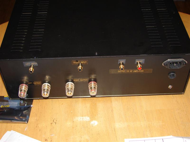

IEC input AC filter
Silver plated Tef___ insulated pwr wire. I put them in a SS braid for noise and abrasion resistance.
Round pwr switch (I LOVE THOSE!!!)
Output binding posts
I don't know where I got the RCA's. They might be Steve's, but I have nicer ones (from Steve) that will go on the mono-blocs.
Edit 2:
Chassis is Par-Metal Series 20. GREAT chassis for the money. Love the look with the 10mm Alm face plate. Vented top, sides and bottom allow for internal heatsinks... And the internal divider sections off the pwr supply section.

Troy,
You probably know this but a warning. If you dont use the insulated washer and the insulator pad you will blow the chip.
For anyone that doesnt know:
The back of the LM3886 is tied to -V. So if it touches the heatsink its no big deal. If the heatsink touches ANYTHING that can touch ground you are screwed instantly. If a wire touches it, if you move the amp around and the sink touches the enclosure, etc etc. Mine are not insulated as I dont yet have washers. I have been very careful and lined my enclosure with electrical tape near the sink just in case.
BTW I have said it before but should restate it: I use CPU heatsinks. Pentium 3 or 4 size is fine. They get bathwater warm. These are seriously efficient speakers. If you are using Fostex or other high efficiency full range drivers I recommend these small sinks as a cost saving measure.
If you have less efficient speakers your sinks should increase in size accordingly.

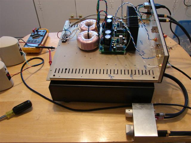

Yep, insulator requirement known.
Nothing mounted, just placed for pictures.
Have to go get wire, standoffs and whatever else from storage to actually assemble the units. Should be this afternoon if possible...
Oh and the obligatory LED!! Have to get that from storage also...
Great 🙂
So for those of you who will be putting a kit together please remember to check with your DMM between the tab of the chip and the heatsink after you install the insulator. If you get no connection then good. If you register ANY resistance, bad.
Uriah
Uriah
Yes! Very important. Better be safe. I measured it and had perfect insulation with the nylon washer and silicon pad.udailey said:Great 🙂
Uriah

The kits work perfectly...
Well the kits were definitely NOT the issue...
They sound fabulous and I knew they would just like the last ones..
One thing to note is that they do NOT work on a 1/4 amp fuse!!! I replaced it with a 5 amp and all is well.
Remember this is a test case and they will be rebuilt in mono-bloc amps. But sound very nice even with the cat 5 signal wire, Sony 5-disc player and the loose mounting.
