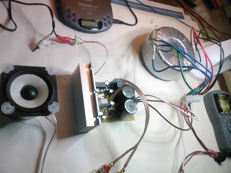

She's a-l-i-v-e!
Haven't hooked her up to a good speaker yet (used an old driver that has some damage just in case something goes pooof!).
peter

I am afraid it is. Only the finest equipment in my house! 🙂
I presume everyone is burning to get my impressions of the sound... Truth be told, listening only to a single channel I find it hard to say anything about subtle qualities since I am too used to hearing both channels of my music... Short of that though I can tell you the thing rocks!
peter

Some more pictures if anyone cares: http://picasaweb.google.com/schro20/My_refRevCPrototypeBuildII# . Note that this is one of the two prototype boards that Uriah had initially ordered (he populated the other one and we discovered some problems with the BOM; these are now fixed). The final product will have solder masks and silk. 🙂
The heatsink on there I got from Steve at ApexJr. btw.
It's been running at 75% volume for the past few hours with no problems whatsoever. The chip gets pretty warm (the orientation of the fins is bad in the picture; the convective flow is greatly reduced when they go horizontal; for final installation they should probably be vertical). But there's been no heat shut downs, so the chip seems happy. And the sound is quite nice, I gotta say. It took maybe a half hour before it had settled. I imagine it'll settle more, but the differences are not so pronounced at this point that I could tell (plus the whole mono versus stereo issue...). They are driving one of my FE207e Metronomes now.
The toroid you see there is a 300VA from Antek. That thing is WAY too big for my taste. I know that some people prefer hugely beefy toroids. I personally don't. I will run this baby off of a 100VA (one for each board) and report back on that. Steve at ApexJr has a bunch of those at a very good price (I'll pick one of those up on Monday). Whatever happened to the possibility of someone else scaring up toroids? (Just curious; I am not about to enter that line of business...)
I can report that all the parts fit just fine this time around. There are two caps which have 5mm lead spacing but the holes in the board are 7.5mm apart. A little bending resolved that. We opted for bigger size female Faston connectors in this version. Near the main electrolytics they are spaced very tightly and one needs to give the nylon at the top a squeeze with the pliers to make it oval (from round). See some of the earlier pictures and then the later pictures (I've added captions to point this out). Once you give them that squeeze everything is happy in there. The advantage is that these Fastons are 14-16 gauge and have good insulation all around.
What else... Sharp eyes will spot some Panas-FC in there now! 🙂 Santa brought those (they are part of the current BOM).
We are getting very close now.
Peter
