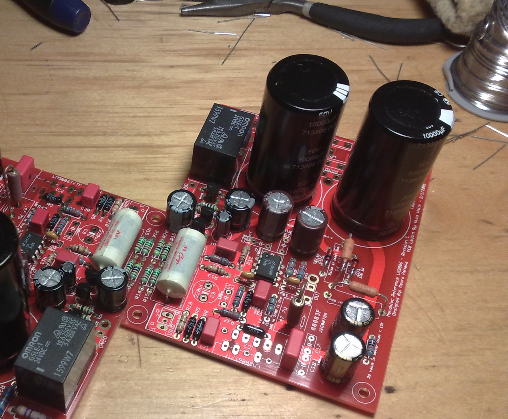

I condensatori C5 e C22 servono a smorzare i picchi di tensione generati dai diodi, in combinazione con l' induttanza parassita del trasformatore.
Il filtro che si viene a creare (a frequenze di circa 15-30 Khz a seconda del tipo di trasformatore) riduce notevolmente il rumore di rettificazione ad alta frequenza.
English translation:
C5 and C22 capacitors are used to smooth out voltage spikes generated by bridge rectifiers, combined with the parasitic inductance of the transformer.
The resulting filter (at frequencies of about 15-30 kHz, depending on the type of transformer) greatly reduces the high frequency noise.
Can you elaborate?
Maybe it's the term 'ringing' that isn't correct/precise?
Mauro's description would apply to R+C snubbers correctly applied to the impulsive signals around the rectifiers.
A capacitor alone is not usually suitable for damping ringing/resonances.
It appears from Forum posts and a bit of my own experience that a low loss capacitor is more likely to induce ringing and resonant behaviour. This is the opposite to what you claim (damping).
However, while it appears to me that you are revealing that removing C5 did not make the sound worse, I find your language very confusing. I find your reference to AC input caps and optional AC caps to be completely uninformative & misleading.

I do recall there being a paper on snubberizing the diodes. The paper also tried cap across the rectifying diodes, and the performance was not as good. It was not used across the rectifiers like here.
This is a similar paper.

I would expect the cap C5 for some power factor adjustments.

I have not pursued this before, but if the transformer secondary has inductive characteristics, using C5 to tune a resonant circuit to the frequency of the mains power should give a better transfer of power where the current and voltage are in phase with each other.
Does this make sense? I'm really trying to apply what we learned in school over 30 years ago.😛 But since I have moved to existing switching power modules, I may not get a chance to play around with these. Having the value that came with the kit probably is just causing resonance at a wrong frequency effecting proper power transfer.

Not to me. So my answer is "no".....if the transformer secondary has inductive characteristics, using C5 to tune a resonant circuit to the frequency of the mains power should give a better transfer of power where the current and voltage are in phase with each other.

Well, I just changed the MyRef C channel so that the LM3886 pin 7 connects to power GND. This seems more like what I am used to. But the details are somewhat less, not as much emotion in the music. I may get some time to do some measurements....
The original MyRef has the LM3886 GND (Pin 7) referred to 0V (signal ground) while the Fremen Edition to GND (power ground).
Did you remove also C5?
It could give you back the lost emotion. 😉
If you manage to measure the difference it would be great. 🙂
C5 is on the board, but It's not connected to anything because my switching modules provide DC, and I don't have the rectifiers on board. I think the problem is the input cap C13. It sounds very typical like what a normal X-cap would be like even with the bypass cap I use. I just don't have room for larger cap. Would still prefer removing the cap, which I may try at some point in time.
Yes, it should be an Arcotronics/Kemet, a very bad cap.
A cheap Mundorf white MCAP is way better and mounts perfectly (see attachment).

It is discussing power transfer and using this method for a transformer limits the maximum efficiency of said transformer to <50%.
Most transformer operate at upwards of 90% efficiency. Maximal power transfer does not apply here.
Power factor correction seems to me to be something else.
