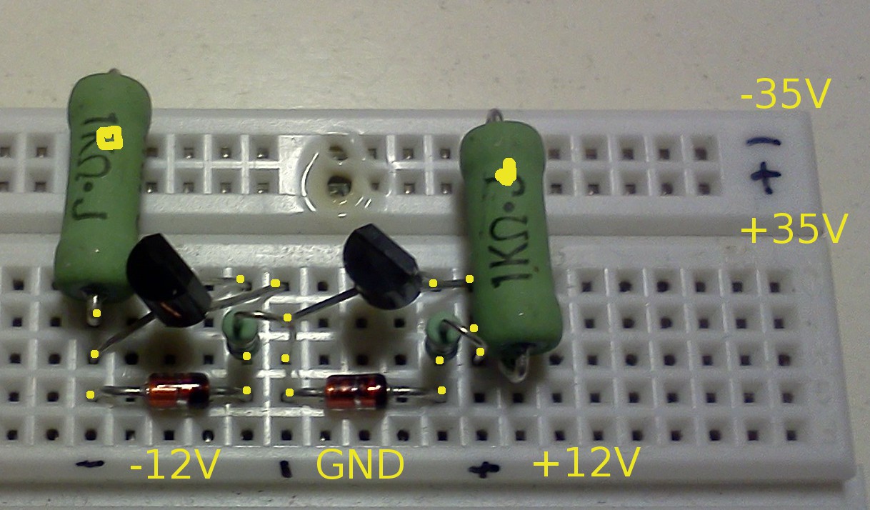

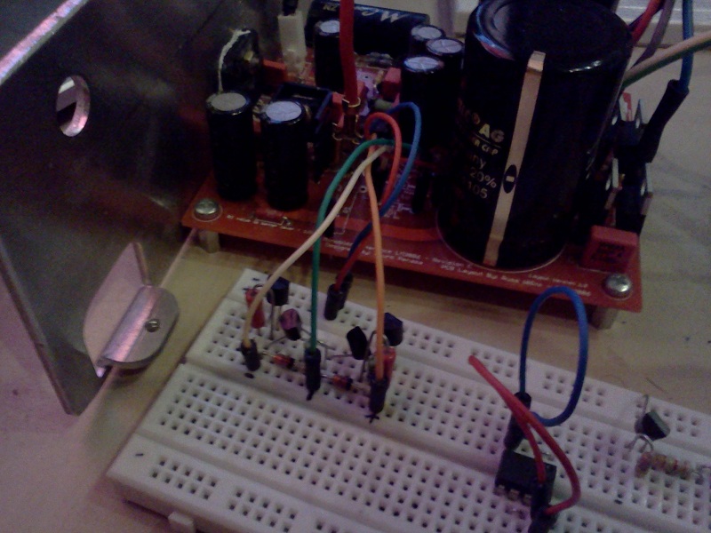

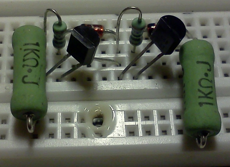

I think I'm on the right path with new LM318 PS.
Today I've tried the attached simplified version on breadboard and it's a nice improvement Vs the zener shunt.
Bass is tighter, soundstage wider and deeper. 😎
The nice thing is that this simplified version can be easily retrofitted on existing RevC boards. 😉
Stay tuned... 🙂

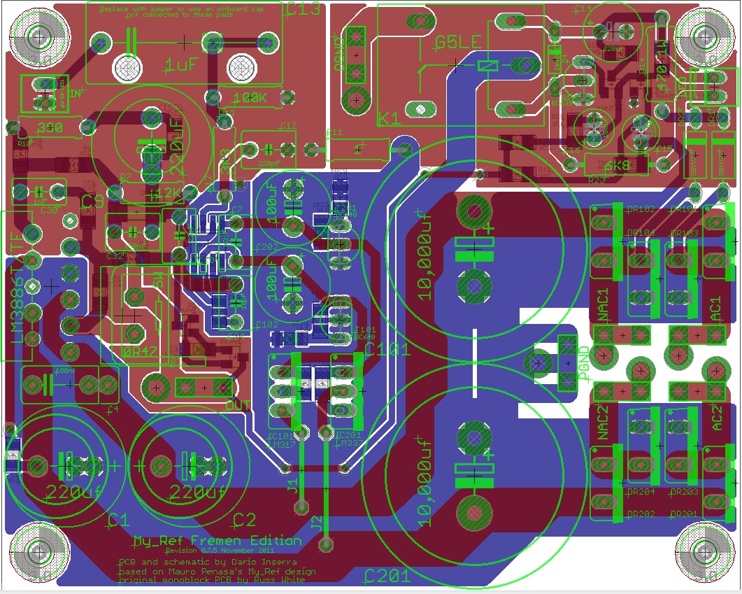

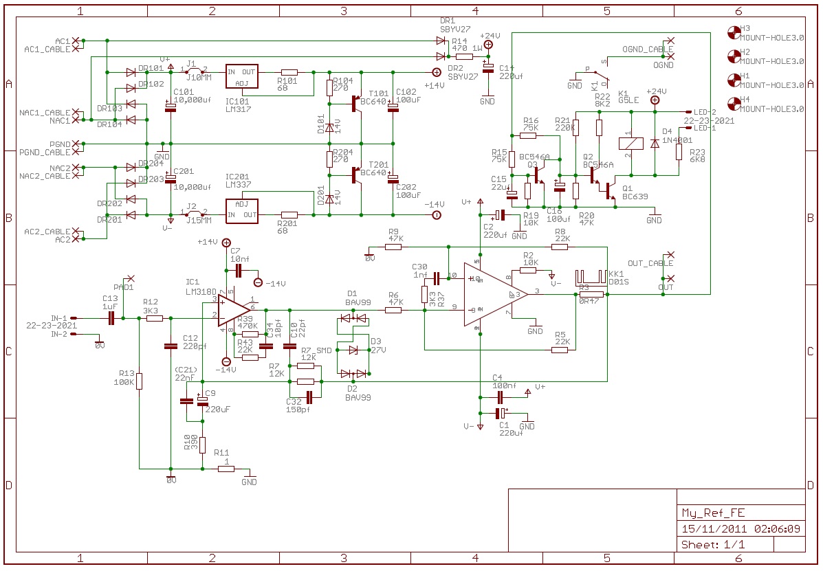

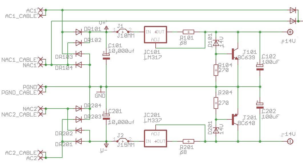

Further development in LM318's PS
Hi all,
I've added a LM317/337 constant current source/sink to the PS, now I'm feeling near to completion.
How it sounds?
Simply great 😎
The schematic of the new PS can be found in the attached updated schematic and PCB layout.

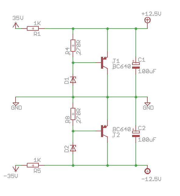

I think I prefer the simplicity of your zener + BC640 shunt regulator alone - with minor modifications, it can be used with NPNs (say BD139 or 2SD667/669) instead of the PNP BC640.
They sound both very very good but the CCS give an extra level of precision. It would be nice to have a discrete CCS though... LM317/337 are not the best CCSs, at least so I've been told.
What is the advantage of using NPNs?
In my mind it should be with BC639/BC640 couple but I've managed to have help only in this way... 😀
Any help, suggestion, fix is as always welcome and appreciated 😉
I've some doubts on the 100uF elcos, probably they're not needed if not detrimental...
There's a bit more choice in NPNs - fast, hi-beta, medium-power, etc., and they tend to be slightly less expensive.
How about trying out MKS2XL instead of the Elcos? I only have 2.2uF/50V/5mm, though. Perhaps 10uF MKS2XL (which you perhaps tried out some months ago for C6, C11 in the Rev C?) may be better.
It could be an option, can you help me adapting the circuit? 😀

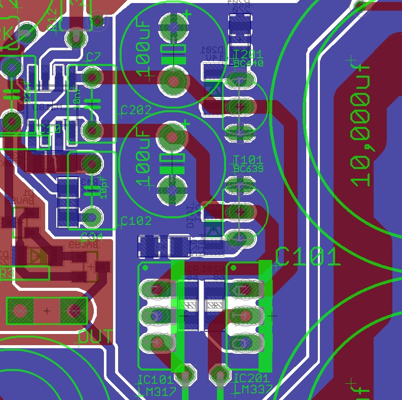

The attached circuit could work?
In this way also the PCB look nicer... 😀
If so the upper part could be used also for the negative side.
What about swapping LM317s with LT1086s?

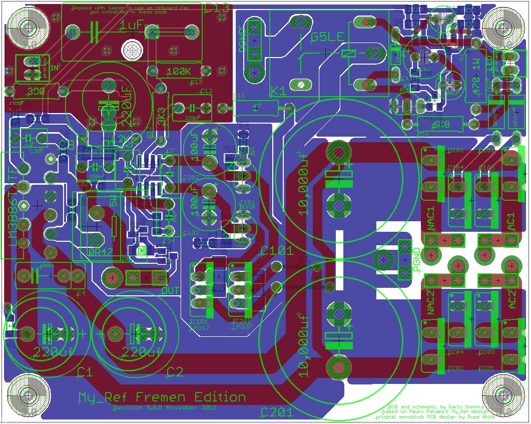

If the power trace and the power ground are on opposite sides of the PCB, you could make the power trace wide to form some capacitance between it and the ground plane.
Am I suppose to be able to work out the retrofitting from your circuit diagram alone? if so I'm gonna need some help....
I would say yes...but do thing with care or you can destroy the LM318...
See the attachments.
Yes, they are.
Do you think that added capacitance could help? Can you elaborate?
How much do you think those traces should grow? They're already 50 mils wide.

Have you tried calculating the cross section of the LM3886 output pin to where the speaker leads are connected to the PCB? Gradual expansion from the LM3886 output pin cross section to meet the OUT through-hole cross section might be a good idea. This is a small issue, and is debateable whether a difference will be heard or not, but it does not really cost anything, and is a good engineering practice to minimize abrupt change in conductor cross section.
I'll check
If I've done the right calculation with 0.35um copper tickness the trace should be 11mm wide (ca 250 mils).
I think it's quite impossible to comply...
I've re-rooted all ground planes and ground connections so to be more compliant with the star ground topology.
Also the 0V top plane has been redisegned so to cover only the input area and where components shunt to ground.
A 0V bottom plane covering the entire amp area has been added and bonded with vias to the top 0V plane so to create a 0V barrier between traces reducing, hopefully, cross-talk.
I think it's needed since I've re-routed the trace to the DC protection circuit to avoid the previous large loop that possibly could have radiated a lot of EMI.
Also main PS traces has been changed to fixed width to mantain impedance constant since they're refererring to a ground plane.
LM318 PS traces has been linked diretly to main smoothing capacitors so to be less influenced by LM3886 back-EMF.
