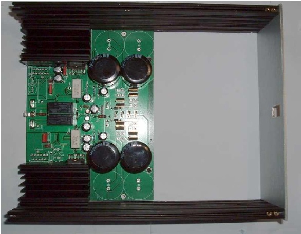

I'm building mono blocks so does anyone have a source for enclosures that would fit this purpose?
K
K
Galaxy Maggiorato from HIFI2000/Modushop will do.
For non critical loads you can use the included dissipating panels, otherwise add heatsinsks.
I've used Galaxy Maggiorato panels without problems with my 89dB sens. Infinity Alpha 40.
I am about to finish my speakers this weekend. Sensitivity is approx 86 dB.
How will it affect build- it would require bigger loads ?
You will simply have lower max volume (the amp is a bit more than 40W) so you'll use more power -> more heat -> you need bigger heatsinks.
The ones in Pesante Dissipante are more than adequate (overkill in fact...)
I like idea of monoblocks as you've suggested to Kazam. It is not enough of dissipation in my case I think ? I just add heatsinks internally using heatsink + enclosure body as dissipation element ?
Penasa for the Evolution simply uses these:
SK 68, Extruded heatsinks for PCB mounting, Heatsinks f.cool, Fischer Elektronik
attached to Galaxy Maggiorato's panels.
I suppose they could be fine.
Image from Evolution assembly guide:
