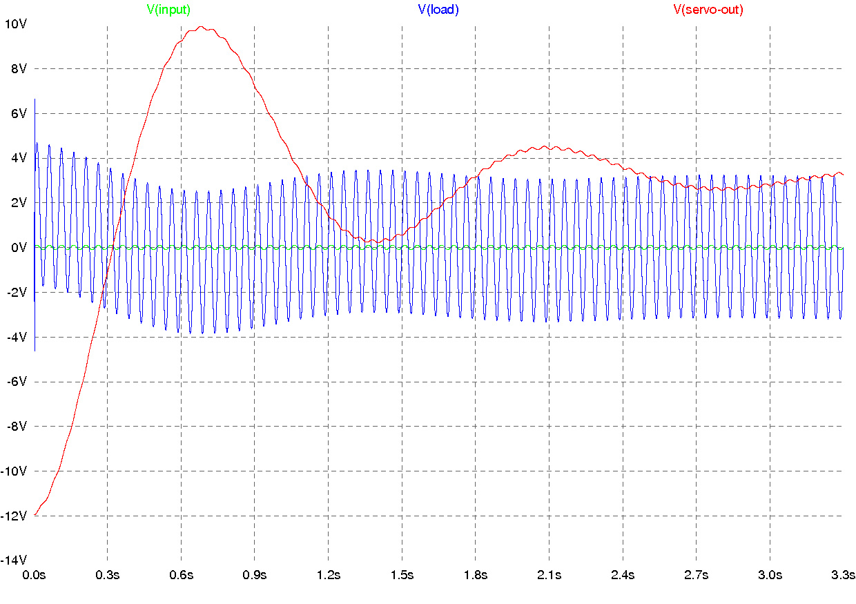

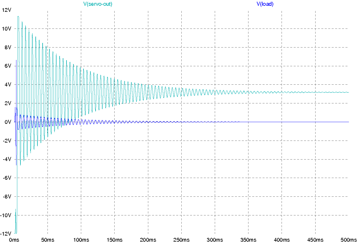

I did some simulations of the single opamp servo.
Two things that stand out most are that the servo output starts at full negative voltage, but I don't know if its not a simulation error and that the input filter did not remove all of the audio signal from the input of the servo opamp.
