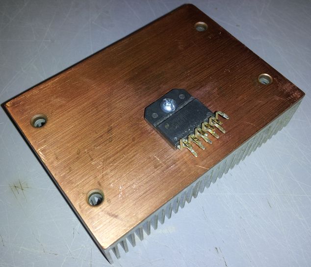

This won't apply to most builders but I thought I'd share it anyway. The new beta installation was starting to distort on one side. I disassembled to reheat everything and check for other problems. No help. I decided to just replace the LM3886, and as I started discovered pin #11 wasn't attached at the junction (bottom) of the chip. That's a NC pin, but I realized over the months I had often flexed all the pins excessively by leaving the small heatsink attached (added leverage) while doing some sort of mod or adjustment. So, no doubt one or more of the active pins had lost contact.
The LM3886 is a rugged device but being flexed that much - that many times had to cause a problem sooner or later. I was able to successfully remount a pulled LM3886 and the sound is fine now. But I wanted to share the story cause so many of those little shortcuts (read - lazy) we gamble with usually get us eventually. The time saved rarely balances out in the long run. :headbash:
