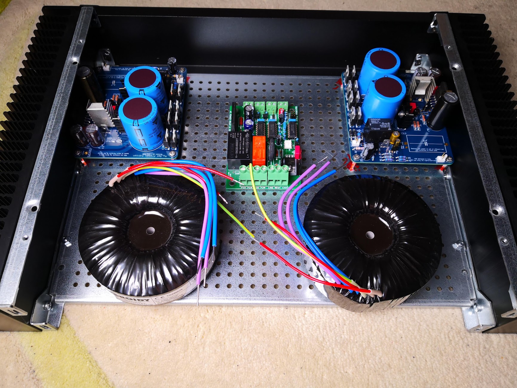

I am finally looking forward to building one of these! Does anyone know of a monoblock chassis that only has one heatsink, similar to the ACA original chassis? Seems silly to be paying for an unused heatsink ��. If not does one of the Dissapante 2U (300mm) work well for a stereo build?
Yes but please refer to the Google Docs one, the Mouser BOM is still valid but some parts have to be deleted (R3, R3 Heatsink)Also, is the current BOM list (v1.5 and up) still the recommended one to obtain best sound?
If you're looking at the DIYAUdio Store you can use this one (steel covers) or this (Aluminum covers and 10mm aluminum front panel), choose 230x280mm, the side panel heatsink is enough for the My_Ref, with the same chassis I've built a very compact STEREO set, still in use by my brother.Does anyone know of a monoblock chassis that only has one heatsink, similar to the ACA original chassis? Seems silly to be paying for an unused heatsink ��. If not does one of the Dissapante 2U (300mm) work well for a stereo build?
Two of such monoblocks, side by side, are about 19".
If you can also order them directly from the HiFi 2000 store:
Silver or Black.
But I think that for US buyers it's cheaper from DIYA Store.
Thanks Dario. I didn’t know if those would be enough sink. I’ll be running these into 6 ohm speakers so they run a little harder.
