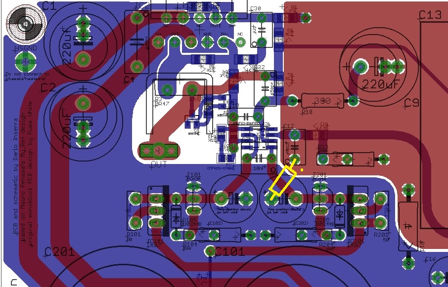

Yes, absolutely but use Evo A compensation, the updated BOM for old boards and solder R11 as in the pic (on bottom side of boards):
The latter boards (from 1.5 and Up) have tenfold less distortion and most of this reduction is due to R11 position.
Since I posted this in the wrong forum last time I’m reposting it here. I just recently built up V1.05 boards I acquired from a member. They sound wonderful but my question is should I move R11 from its original position on the board to the position Dario showed in this picture?
Thanks, Pete
Hi Pete,
if you want (hopefully) tenfold less distortion, yes. 😉
It's an easy and quick mod.

I'm sure if you asked the Sparkos guy, he would send along the full datasheet and you could forward that to George. After all, it looks like George doesn't have enough to do. ;-)
Although that I know some don't agree, I find that opamps have different character in different circuits. For example, the OPA827 that sound quite good in the FE sounds pretty unbalanced in a dac I recently built. I don't know what that means here other than there seem to be a lot of possible problems using it in the FE circuit.
Thanks, Jack. Actually, the Sparkos data sheet is contrary to many other discrete opamps in that he provides thorough, meaningful data. It does include the input bias current spec: 4.5 uA typ, 6 uA max. I don't know where that falls on the scale of acceptable levels to allow removal of C9, but I think it's lower than the OPA827.
Yes, George, perhaps the two-pole compensation would prove problematic in a MyRef implementation, although Andrew at Sparkos did not mention it in his reply to my inquiry. He does claim that it is "extremely tolerant of capacitive loading and high feedback network resistance" if that means anything here.
Do either of you see a problem with local decoupling to the ground legs of the regulators instead of using C7 across + and -? It would be convenient.
I would not be asking about this at all if there was a clear consensus about which alternative monolithic opamp was the best replacement for LM318. There doesn't seem to be a winner that pleases everyone, which makes me wonder if it's really worth the bother. On the other hand, I KNOW the SS3601 is a device which provides excellent sonics in other circuits which are not as complex as the MyRef.
Peace,
Tom E
Peace,
Tom E
