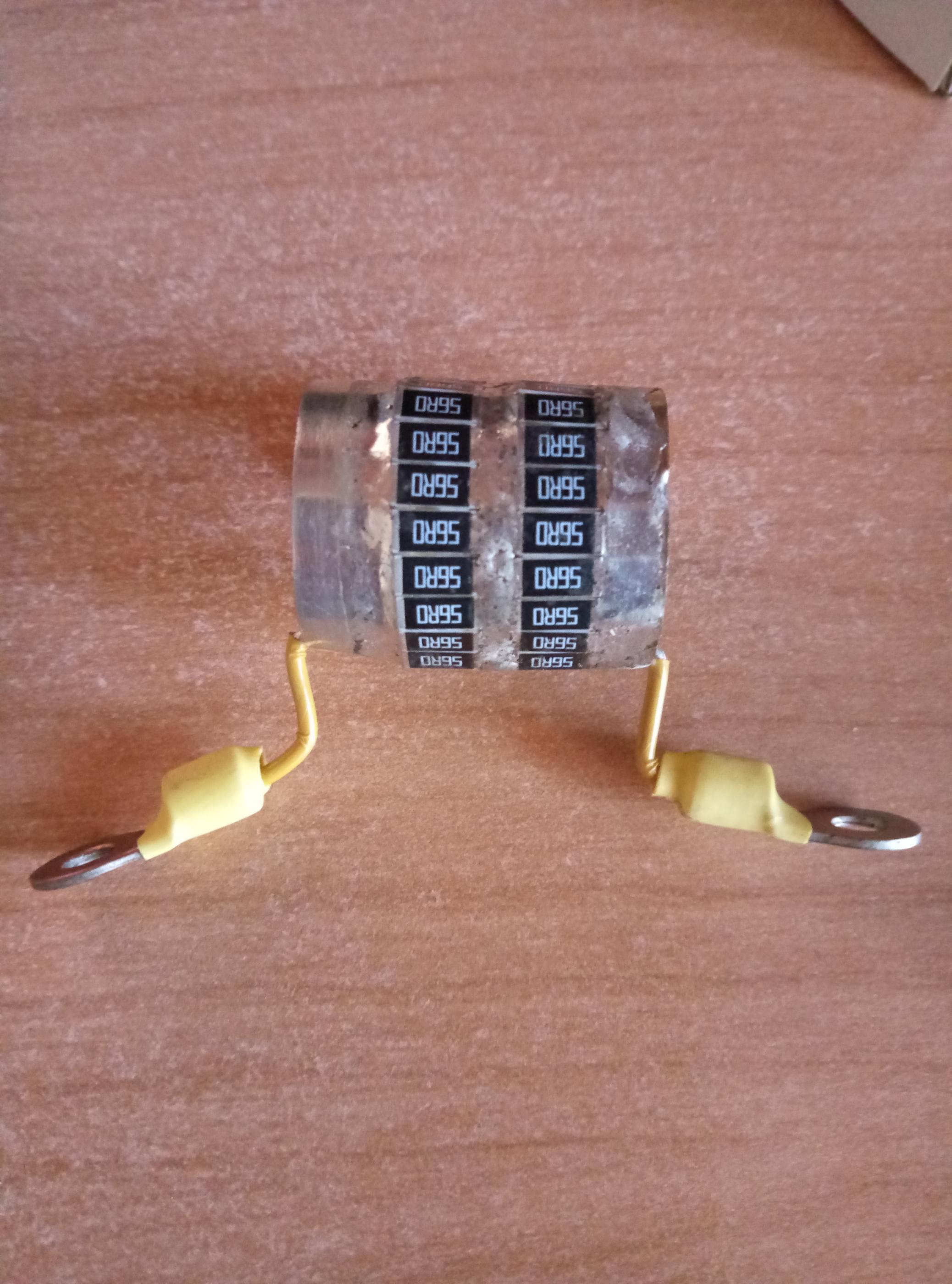

just to add a little bit of entropy about the sound of a power resistor in a (relatively) high current path I'd like to share my experience about an experimental power resistor that you can see in the photo, a 20 parallel 56 Ohm in series with another 20 parallel 56 Ohm thick film smd resistor to obtin a 20W (circa) 5,6 Ohm power resistor.
It was quite frustrating to hear at a ugly resonance in the mid-high region (Lowther are dramatic in this field), I was really disappointed with it. While dismounting them a couple of "pick" occurred with my nails on the composed resistor body (yes, I was quite rudest than the montage phase).
Well, the frequency mechanically generated by the resonance of my cylinder resistor was quite similar (if not the same) to the one I've heard during music reproduction...
So, the conclusion should be: no vibration on power resistor at all, better to be well dumped, but if a vibration is unavoidable, it should be generated by a well-sounding material. In my experience, based upon the sound of hard domed tweeters, aluminium is the worst, copper is quite good but titanium is absolutely the best (it tends more than any other metal to the soft dome sound while preserving the detail of a hard dome).
My personal experience, I repeat, but it might be interesting for someone, and maybe a suggestion for the heatsink (if any)?

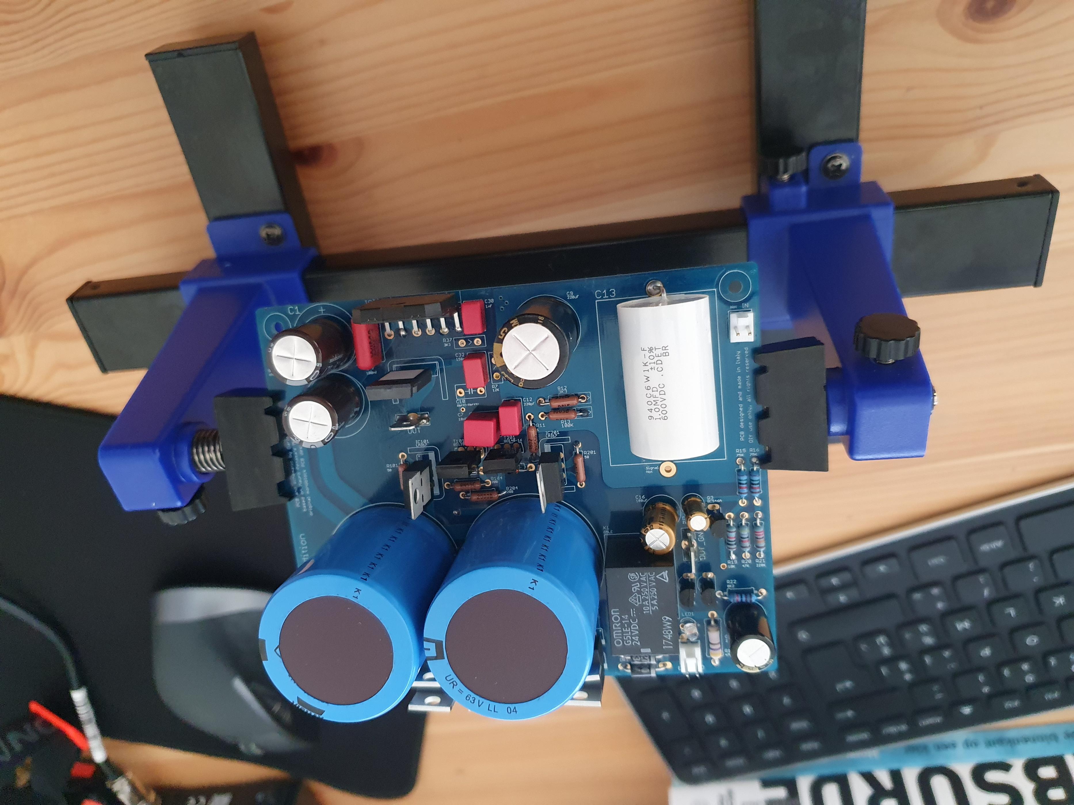

Almost three years ago I ordered the My-Ref Fremen PCB's. With the Corona lockdown I found some qualtiy time.
The soldering went well with 60/39. I think there is around 8 soldering joints, that did not flow easy at all. Don't know why.
Stil waiting for C10 (was missing in my order).

Glad you could get these boards going. One thought. If your 60/39 is typical resin flux solder, I recommend cleaning the boards with alcohol as soon as possible. Flux gets into places, like under IC chips, and can have enough conduction to cause problems. Of course, if you used "no-clean" solder, you are in a better place. I only mention it because I have messed up in the past.
Good luck
Jac

Now that is an interesting experiment! In spite of the less than perfect results, I will bet it did a good job of cooling.
Jac
If You would go for revA style modification, then You do not need it. And you can try, for now, with the original R3 (if you are not able to reorder)
And what you say about the resistor, I had found as well..
Naked, it 'pings' ugly, and I thought to find a similarity in the caused distortion..
I refer to the "Quad or Series/Parallel Resistors as an alternative to traditional power resistors thread", if I well understood the photos, I think vetronite is not so indicated for a heat dissipation, also considering the glue under the copper to couple copper and vetronite. If I'd try to build one, I add some series/parallel resistors to reach the same value and I'd solder them within three copper stripes. I repeat, if I interpretated correctly the photos, maybe I'm wrong
